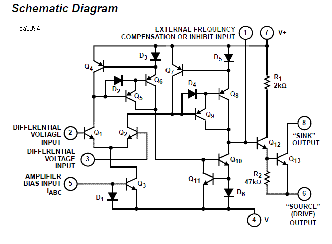

      • #48
        discrete ca3094 anyone ?
        not a large parts count
        • #49
          yes axactly the same
          Originally posted by metaldetector107 View Post
          the transmitter is from Micronta 3001,
          kind regrads
          i took mine apart had a look same company built them.

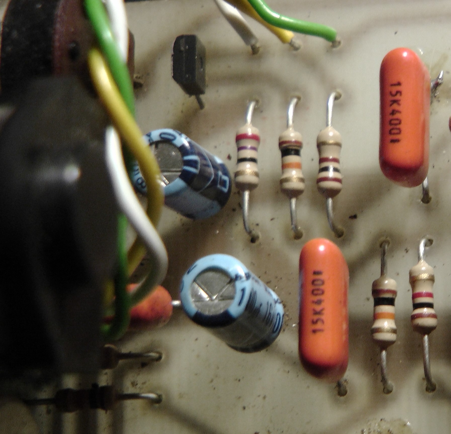

              • #52
                I see that on schematics all resistors 270 R are wrong , I have check its value with ohm meter as well and it shows 27 R. the bar code on resistor are 27R Red Violet Black . Regards. Is any modification for performance improvement available ? Click image for larger version
