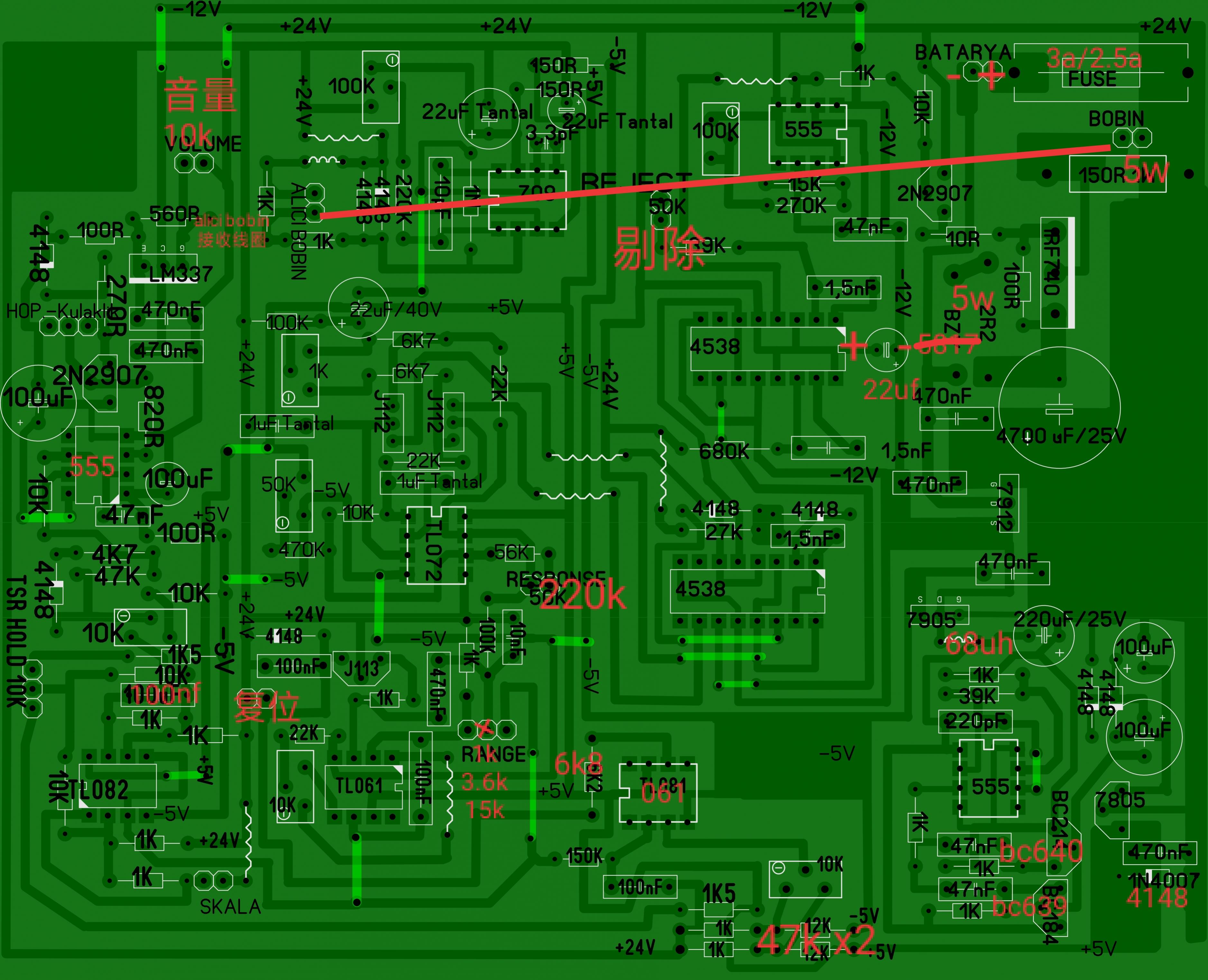

ID:	362132What's the problem? Make it impossible to work? What a headache.

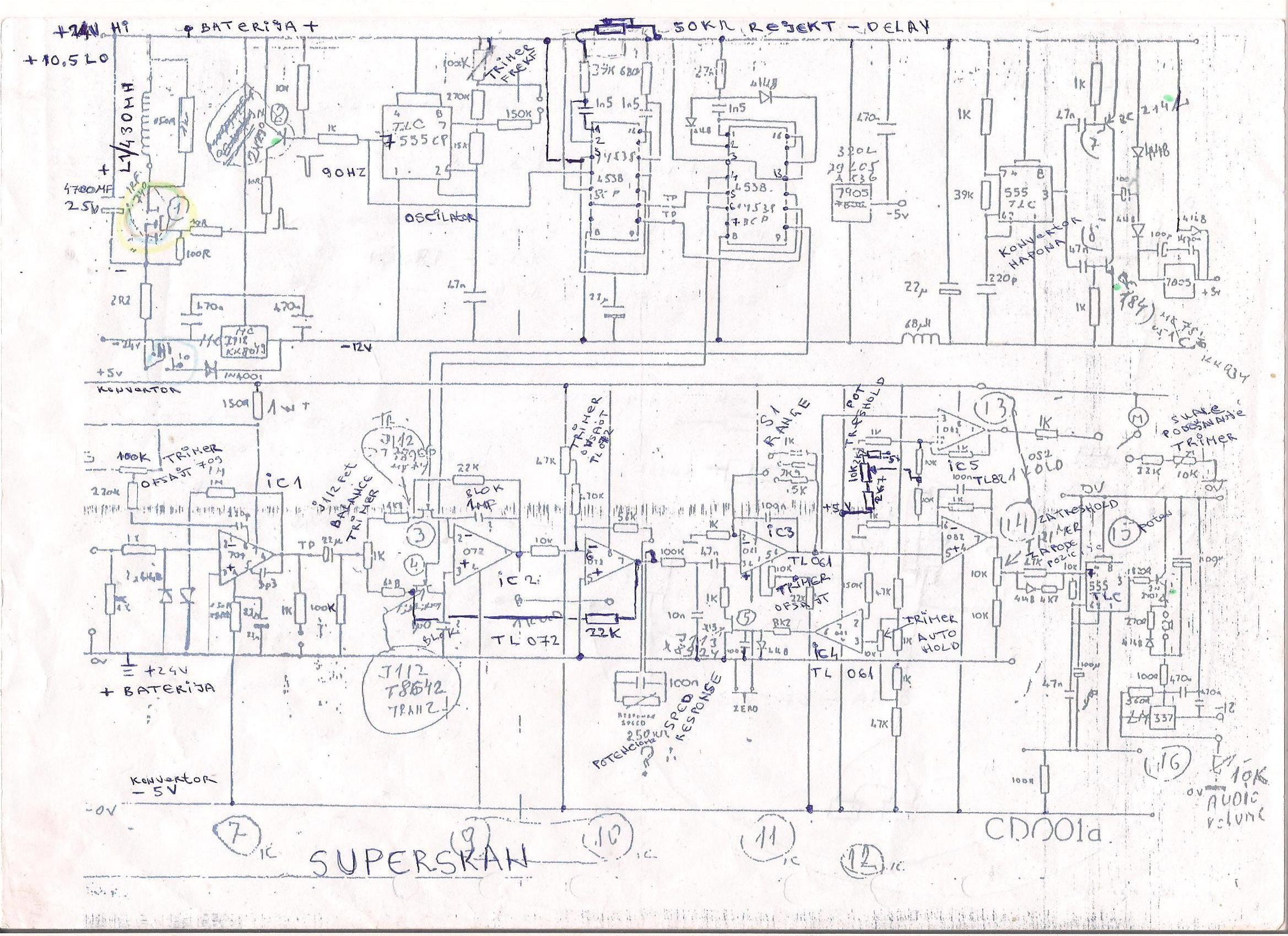

        maybe you could share the schematic you draw and used for your PCB. I do not mean the hand drawn circuit which is uploaded already here in the forum. By the way there are at least 3 different diagrams known to me and maybe more floating around here. It could be possible that you have an error in your drawing. You can not expect that people to trace your PCB to find the problem. That is to much work, but a look at your schematic its easier.

          I used this hand-drawn schematic that I uploaded, and it is almost error-free, but some details are not clear.
          • I'm trying to find all the mistakes in the PCB
            • Unfortunately, the tips given by experienced people are very few and even misleading. Maybe they spent as much money on super scan pi as I did.It's not weird.

                so you say you used one of the hand drawing which a loating around. Yes they are "almost correct" but only almost... I know of about 4 different SuperScan circuits and all are slightly different. So no wonder... How have you drawn the PCB? What software you are using? The correct way is first to draw a schematic (and run an ERC (electrical rule check)) than convert the schematic into a PCB and than place the compnents within the board outline. After placing the components, you can use either an auto router or you route your PCB by hand. And guess... run after finish routing a DRC (design rule check) on your PCB for errors. Thats the way how to do it. Everything else is not professional. Another tip is DO NOT BELIEVE EVERY CONNECTION YOU SEE IN THE SCHEMATIC IN THE FIRST PLACE. Always question it and check whether it could be correct or not with other similar circuit parts. Check also IC's and transistor for correct PIN connection but you should do it ACCORDING TO THE MANUFACTURERS DATA SHEET ALWAYS. That helps a lot in avoiding errors. In the past 20 years, I have seen so far only a few of hundreds of detector schematics which were 100% confirmed error free.

                    You are using a schematic that is "almost error free" and "some details are not clear"? I think it would be a miracle if it did work. The schematic is a mess and unreadable. How about drawing a clean schematic of what you actually built, and then maybe someone can help.

                      • I took out everything I had.
                        response The potentiometer is 220 K with a 100nf in parallel
                        Transistor 214 pin 184 needs correction
                        The bottom right diode is 4148.
                        I hope I can help people who want to make it as much as I do.

                                I had a quick look at your PCB.... What is the purpose of the LM337 in your PCB? The LM337 in the hand drawing does not make sense to me. In other SuperScan drawings is NO LM337 seen at all. This is what I mean in one of my previous posts. Always question the circuit and DO NOT BELIEVE ALWAYS EVERY CONNECTION YOU SEE IN THE SCHEMATIC.
                                By the way, some of your cpacitors connected to 24V have a voltage rating of 25V. Within the 24V rail I would use at least capacitors, with 35V rating.
