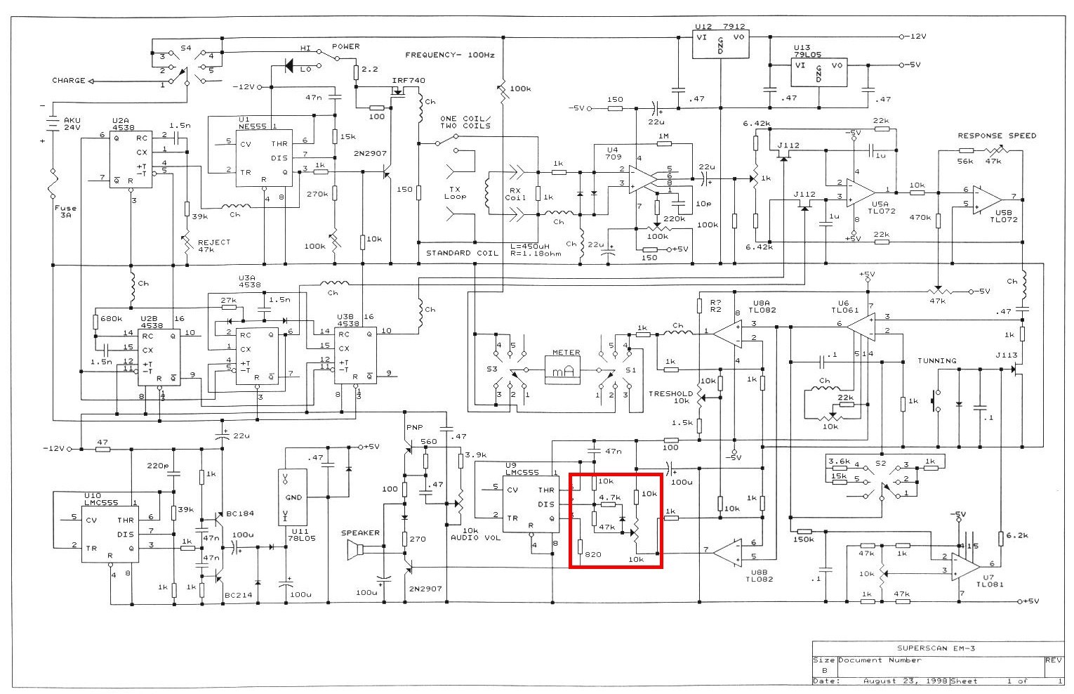

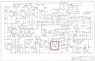

    This is the circuit diagram of the SuperScan EM-3 that I have. Does anyone know what the small circuit with the diode in the red box is for? And does anyone know who drew it? Is it maybe the Superscan MKI or MKII and someone redrew and relabled the circuit only?

      Hi Geomax I don't know the designer of this circuit, but I think this diode in series with the 4.7kΩ resistor acts as a kind of limiter or rectifier, since this combination is in parallel with another 47kΩ resistor. In any case, this circuit design isn't compatible with my style of designing electronic circuits. I find it quite confusing and unclear.

          Hi Eduardo1979,
          Thanks for the SuperScan LITE schematic. I agree with you, the drawing style of the SuperScan EM-3 is terrible. I like your style better because it's very similar to my own style for schematics. Very clean and clearly drawn.

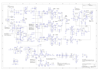

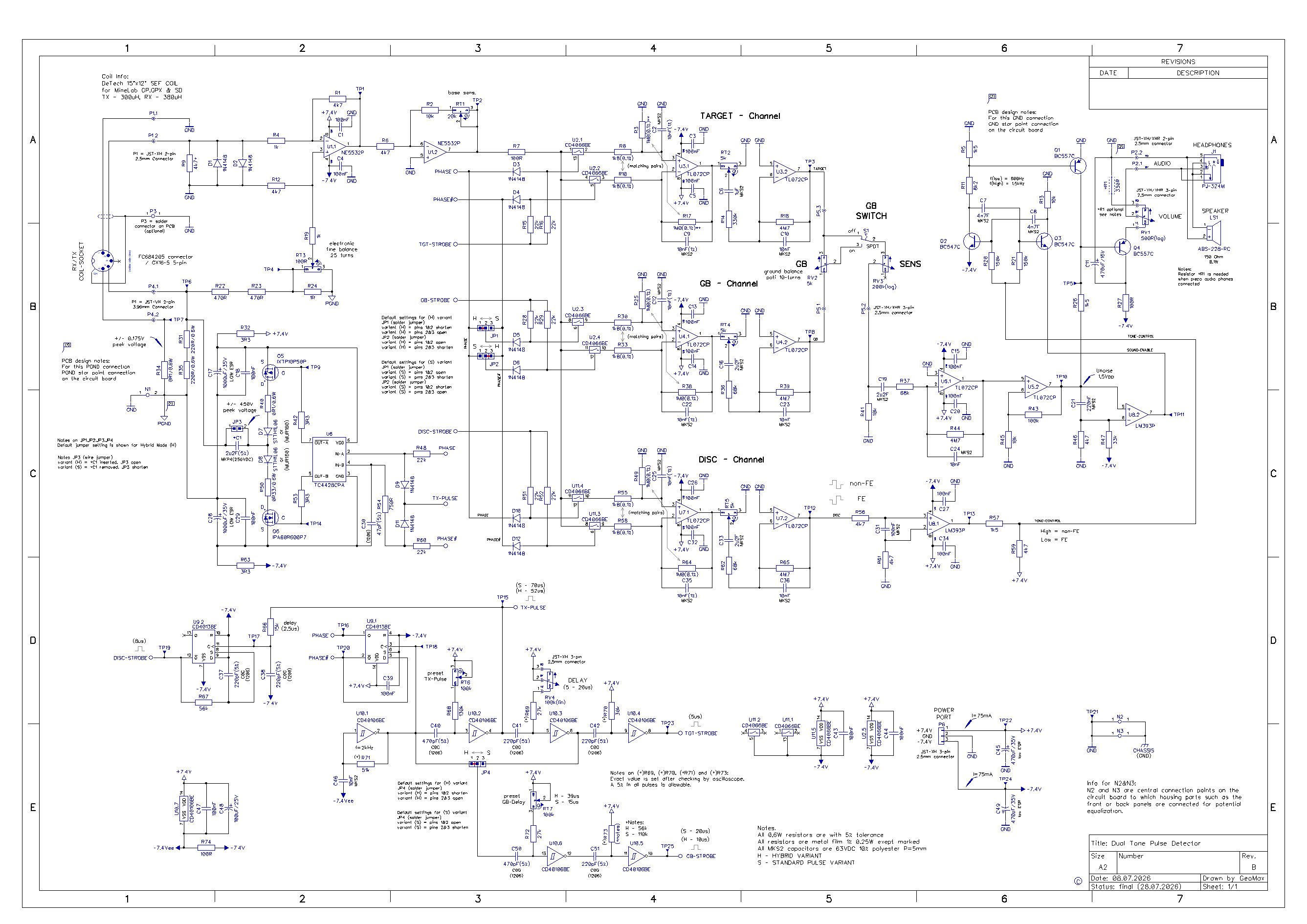

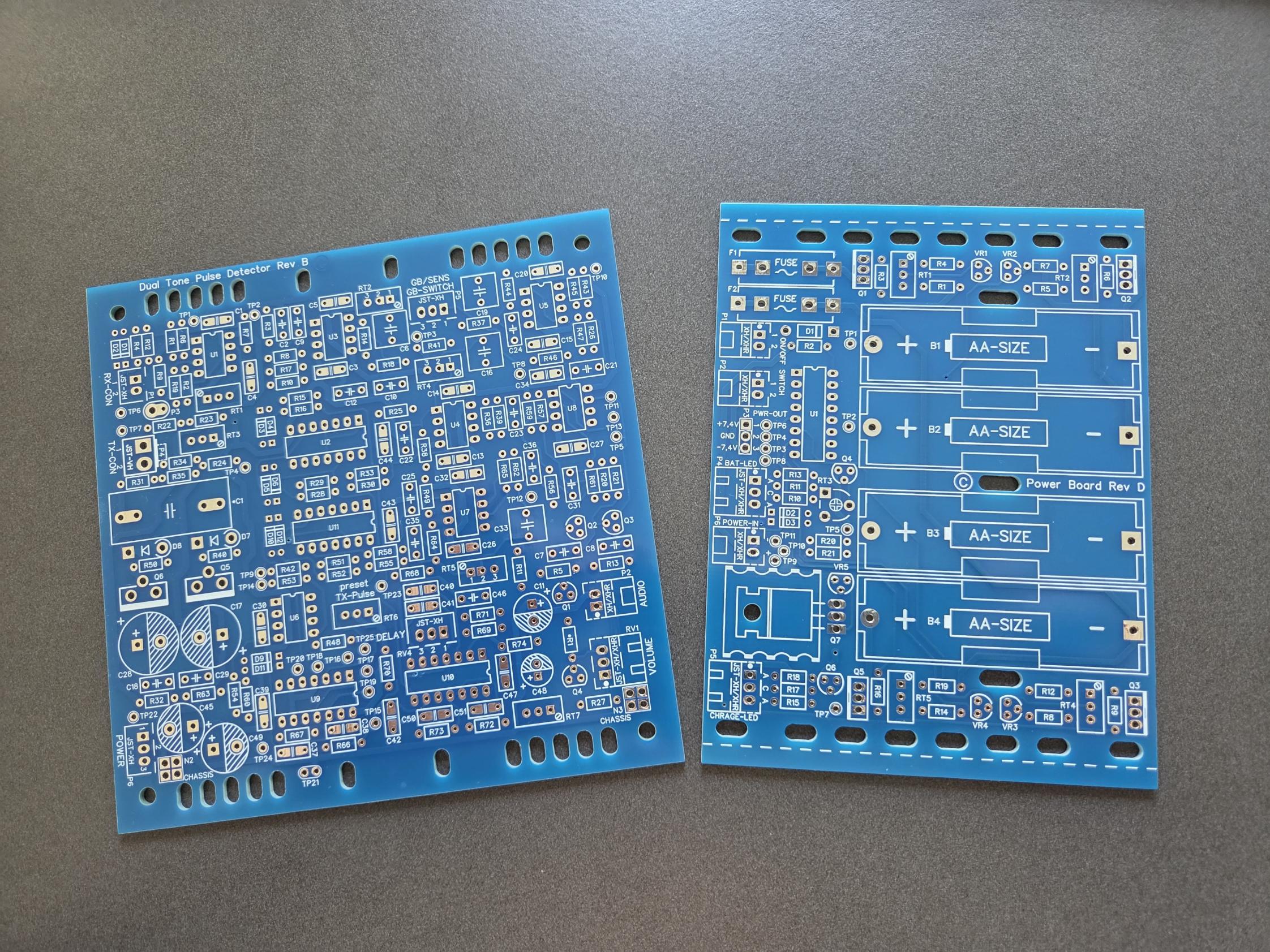

            • Hello Eduardo1979
              Here is an example of one of the circuit diagram and printed circuit boards I made for Detectorist#1. The circuit shown here is for a two-tone pulse detector developed by Detectorist#1. There is also a separate post about it with more information about this bi-pulse detector.

              • Hi Geomax. I saw the design you made yesterday. It's pretty good.
                  Hello Eduardo1979
