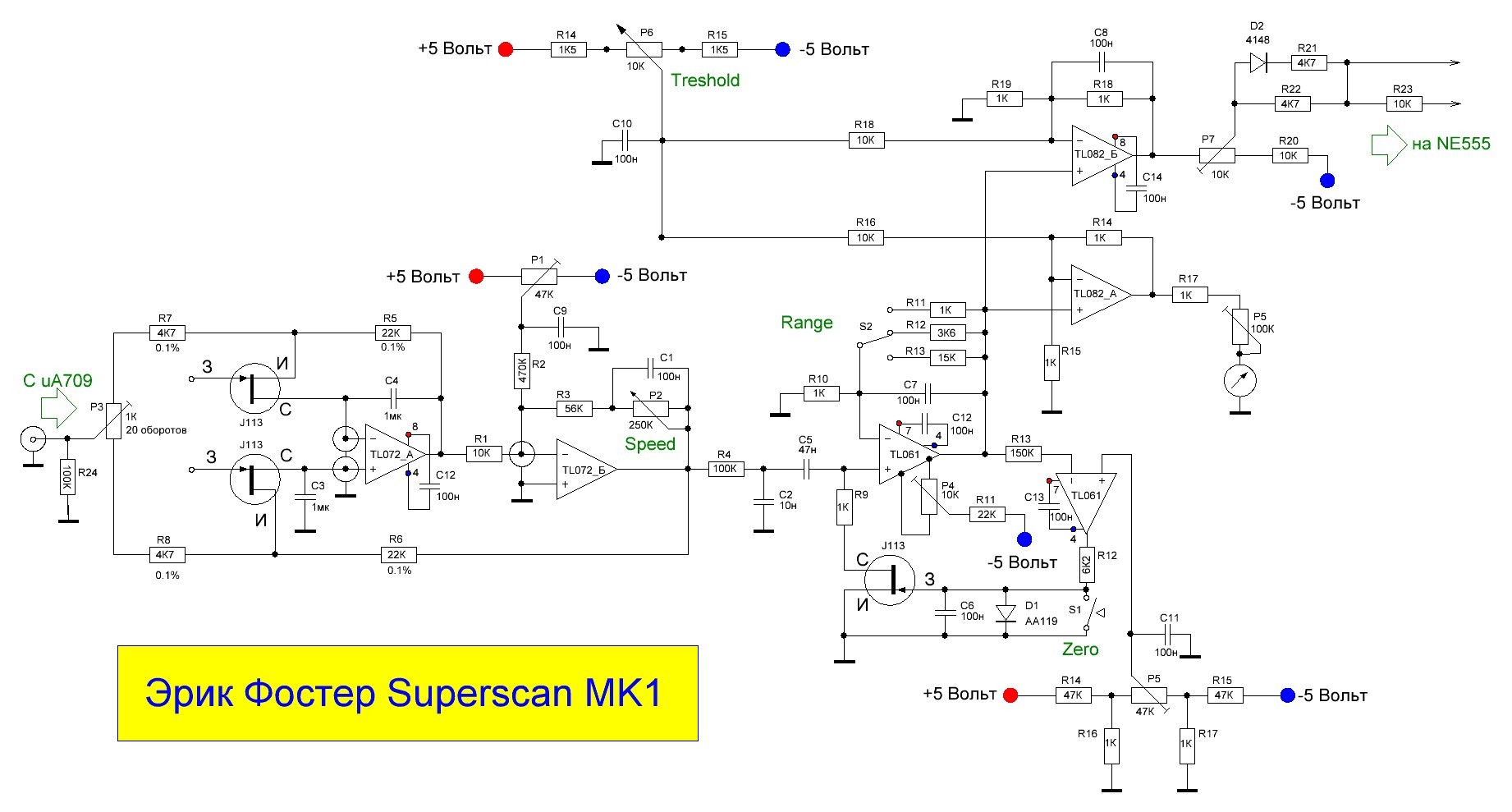

            I already built one superscan from the Rospy PCB I found here, and I finished it, but I have a few problems. There are three things I cannot find in the PCB information, and I’m not sure if they are buttons or potentiometers. I’m also afraid I may have burned something while testing it.

                    Hi Geomax.
                    On the forum, I only found the PCB design without a schematic. I drew the schematic based on the PCB layout that was posted here. I've attached both the schematic and the PCB layout. Both are correct. The only thing I did was replace the uA709 with an NE5534, since it's newer and more readily available. I added a potentiometer and an additional resistor to the schematic for adjusting the offset. It's not shown on the PCB layout, but with a large coil, it works without the offset potentiometer.

                      thank you very much for the information about "ROSPI". I've now read the first few pages of the article on Geotech. Somehow I missed it back then. "ROSPI" refers to a user named ROSPY who created the Superscan hand-drawn diagrams. I had seen them elsewhere before but didn't know who had made them.
                        Hi Geomax.
                        Hello Eduardo1979,
                        Thank you very much for the schematic. I've taken a closer look at it. It was fun to study the schematic. It looks like it's a design mix of Minipulse and Goldscan 4 to me.​
                        You mention that you used the detector with a large coil. What is "large coil" for you? Have you used it with a big frame coil 1,5x1,5 meter or with for example a 40cm coil? Thanks.

                          Hi Geomax.
                          I used the detector with a 1m x 1m frame coil made from Cat-5 network cable. I built this detector quite some time ago. It's a good detector, like the Superscan, but without ground balance. If you use the detector in mineralized soils, such as red clay, it detects the ground. You can increase the delay to eliminate the ground effect, but you lose a lot of depth. The RosPI has a higher frequency than the Superscan; this can be seen in the value of the capacitor connected to pins 2 and 6 of the 555 oscillator. This detector is very similar to the Superscan; the only differences are the frequency and the switch that toggles between the 12V and 24V power supply for the IRF740. I remember the Superscan also had a potentiometer to adjust the integrator speed, something the RosPI doesn't have, but it can be easily added.​

                            Hello Eduardo1979,
                            i build the rospy pcb but in the GAIN, RESET and REJECT don't have info what we add there?

                              • Originally posted by nasios View Post
                                Hello Eduardo1979,
                                Hi Nasios.
                                In the attached schematic, you'll see a 250K potentiometer labeled SPEED. This potentiometer adjusts the integrator's sampling rate, and you can add it to your ROSPI. You can change the ROSPI's operating frequency to approximately 90Hz, similar to the Superscan, by replacing the capacitor connected to pins 2-6 of the 555 timer with a 47nF capacitor. It's currently 15nF if you look at the schematic or the PCB layout. There are many variations and combinations you can make to create a good detector.
