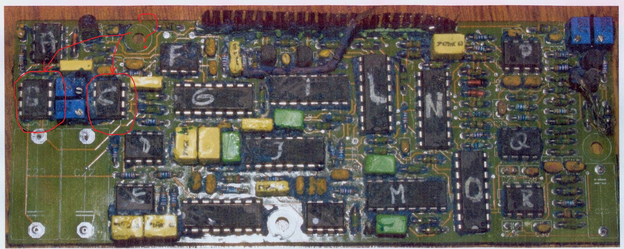

        HI
        please help me what is the Number ics in the pictures?
        I thing J-K-D-E-R-P are dual opamp and ic I is lm2950.

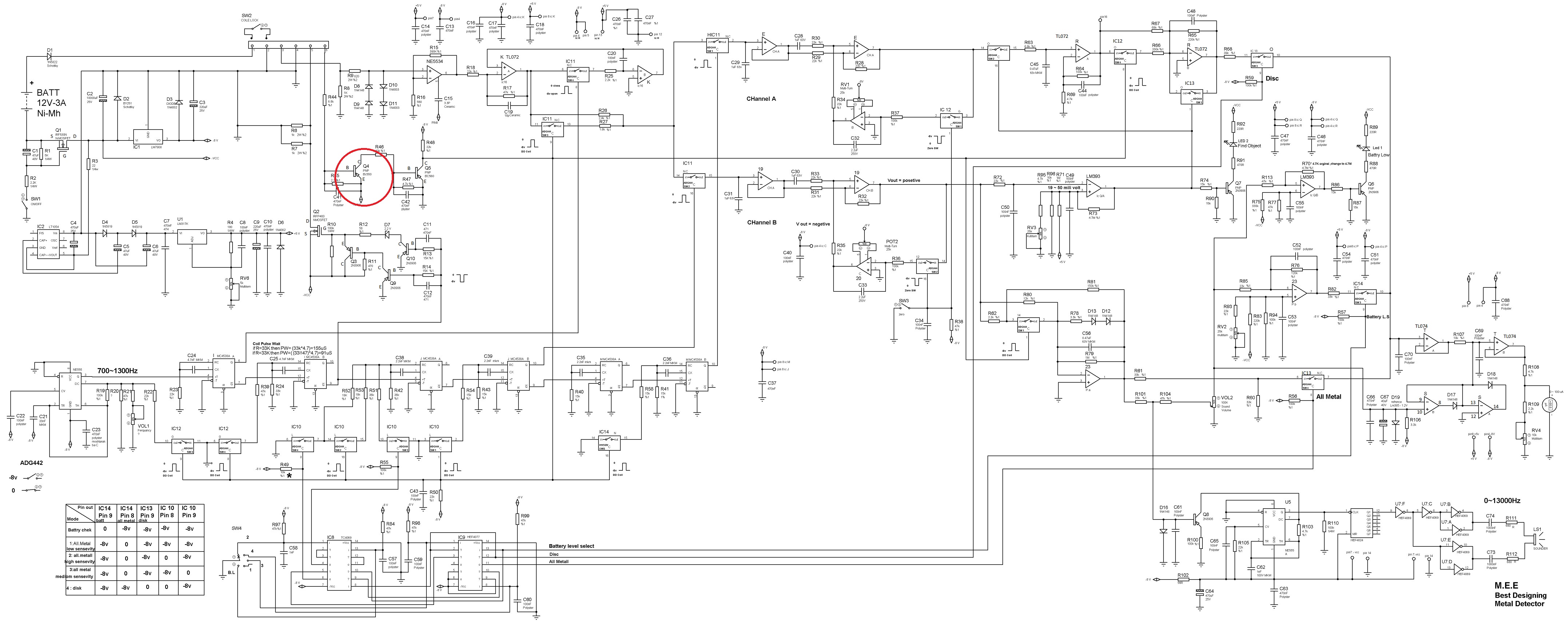

                • Originally posted by mee60 View Post
                  hi all
                  i drawing lorenz lp 5 schematic of original circuit pic .Maybe it's a mistake.
                  but i make it and worked fine
                  not : ADG444 not worked in circuit it typing wrong . it is ADG 442 im used it .
                  not : power supply in circuit is -8v and +6.5v . im chennged original circuit with lm317( original ic is lm2950 dip )
                  not : i dont know original coil parameters but i used mono coil (( 35 cm coil 1.8~2 ohm 390~400uH)) and (( 50cm coil 2.1 ohm 400uH)) . 35 cm coil is better in my test.

                    • please tell me the marking of these chips Click image for larger version

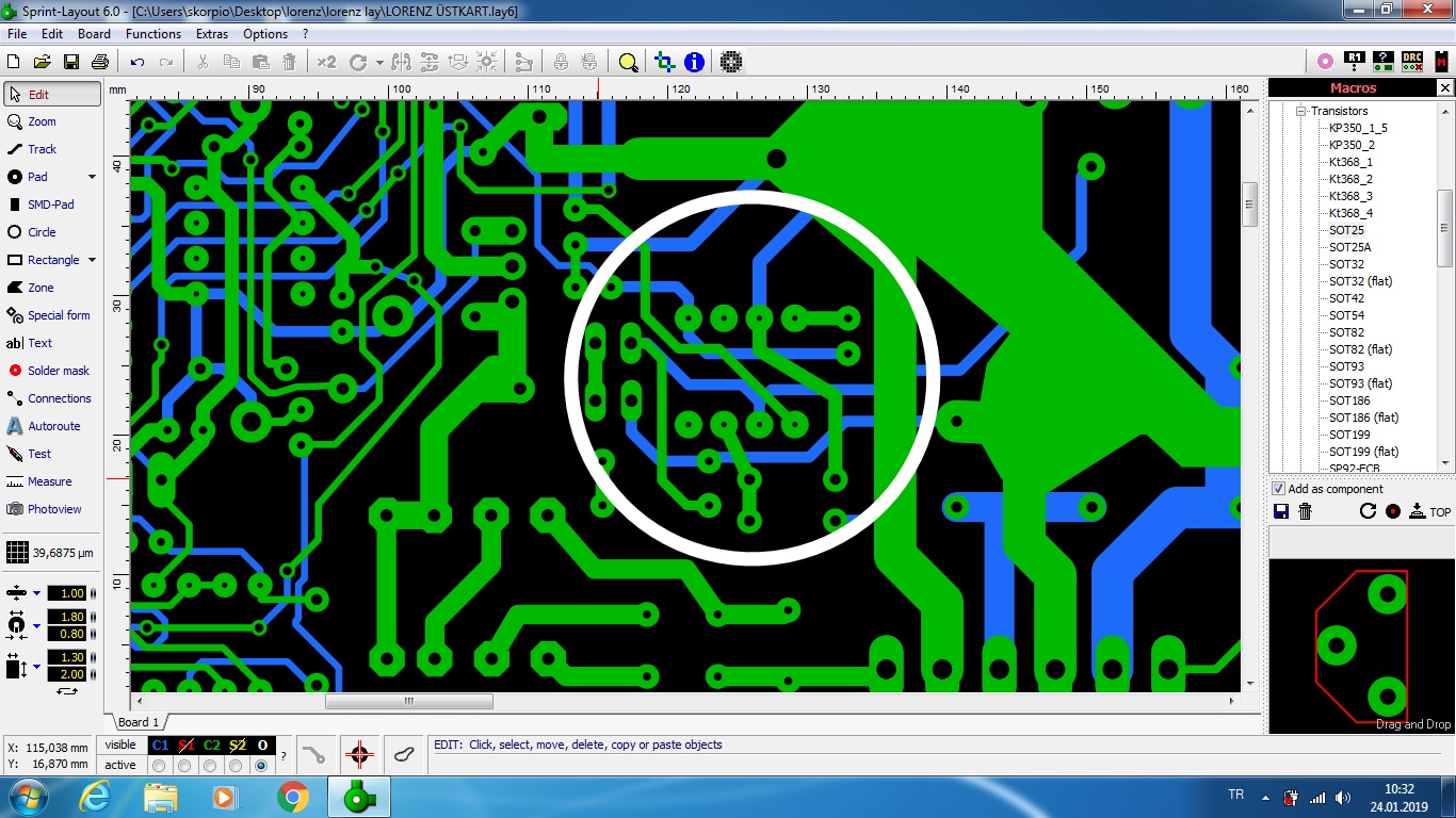

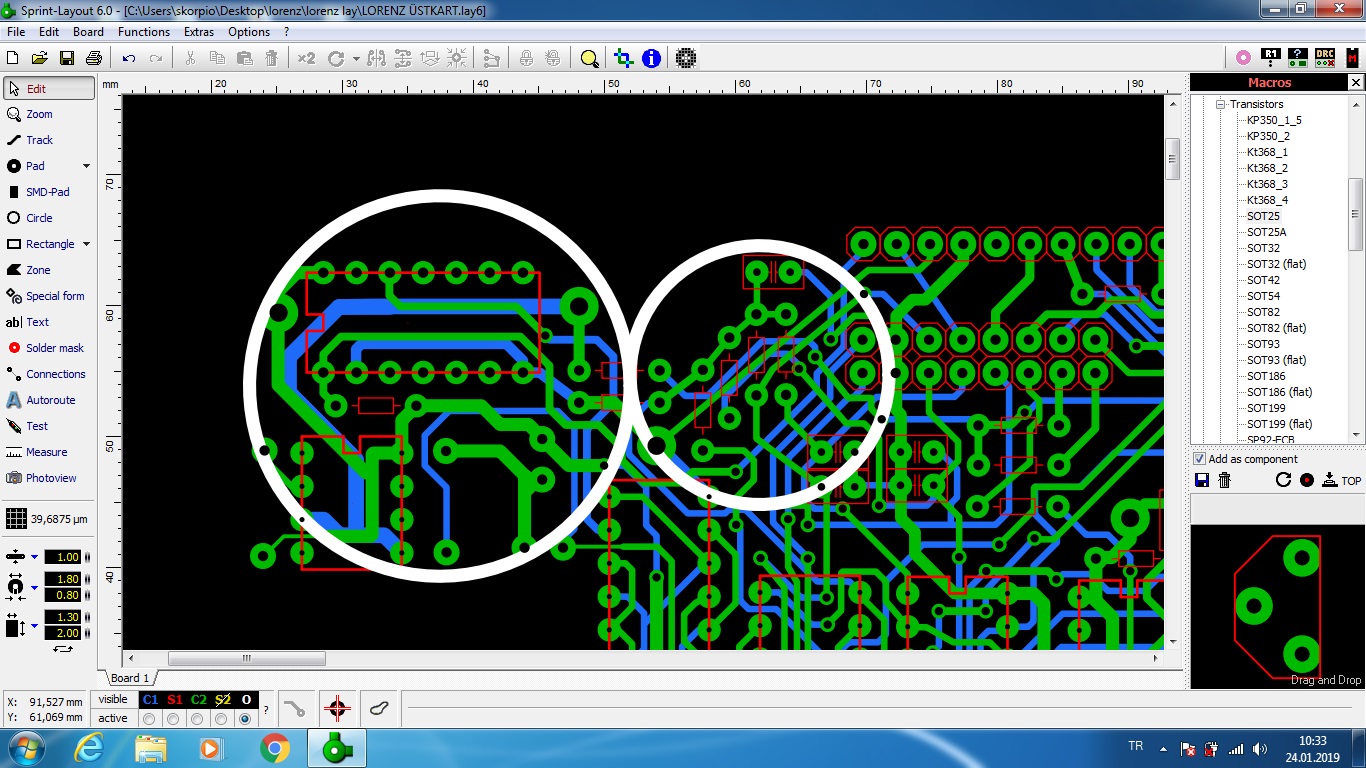

                        • lorenz card was drawn ancek white did not appear inside the apartment, please helpClick image for larger version
                          • second pictureClick image for larger version
                            • Comment
ID:	353663 The Bc550 npn transistor is shown in the diagram as pnp. Could you help.
