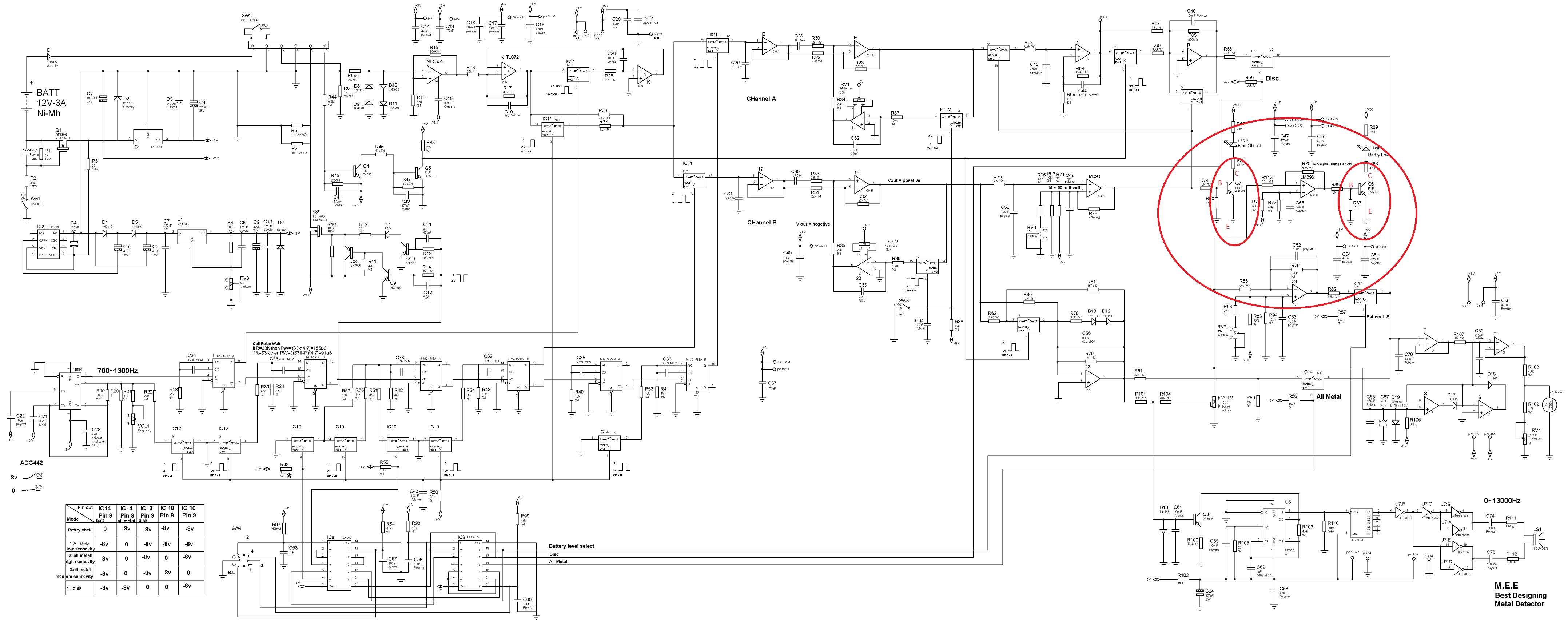

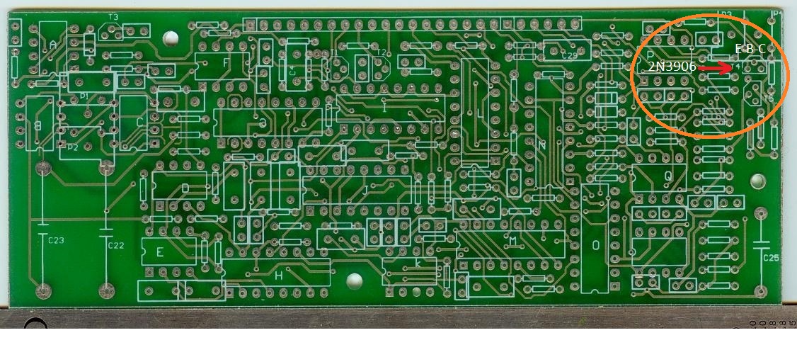

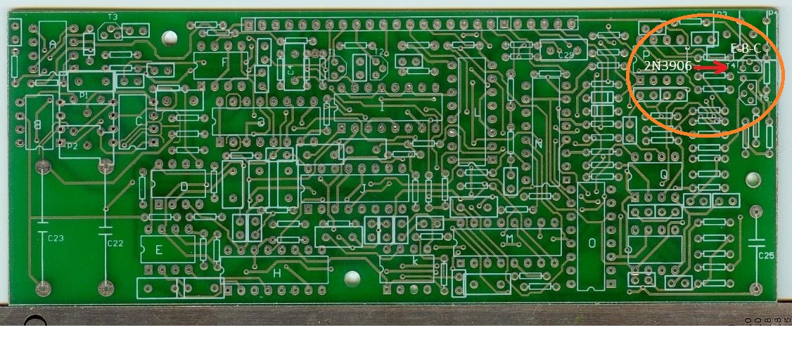

      original pcb also 2N3906 emitter 470R connected. schema bc850 emitter connected to the gnd line. Which is true.

      • Where is the 470r to original pcb?I thing schematic is true Emitter connected to the gnd line directly.

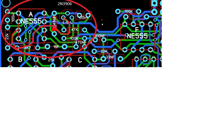

          • You'll see a good review of pcb. roshik

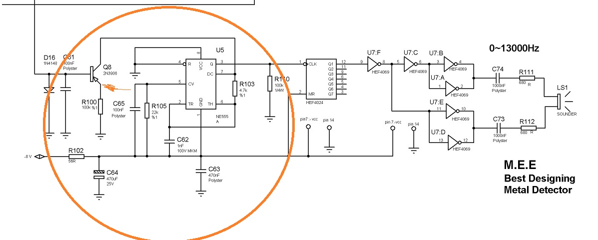

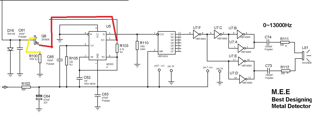

            • According to the original pc ne555 7pin 2N3906 emitere (E) connected. According to the scheme, the emitter is connected to the gnd over 100k. which one can help you right. Click image for larger version

                According to the original pc ne555 7pin 2N3906 emitere (E) connected. According to the scheme, the emitter is connected to the gnd over 100k. which one can help you right. [ATTACH]45925[/ATTACH] [ATTACH]45923[/ATTACH] [ATTACH]45924[/ATTACH]
                To pc E_B_C OF2N3906 is wrong.C_B_E is true.

                        • If you scroll back just 2 pages back you'll find my post. It's based on the original boards layout.
