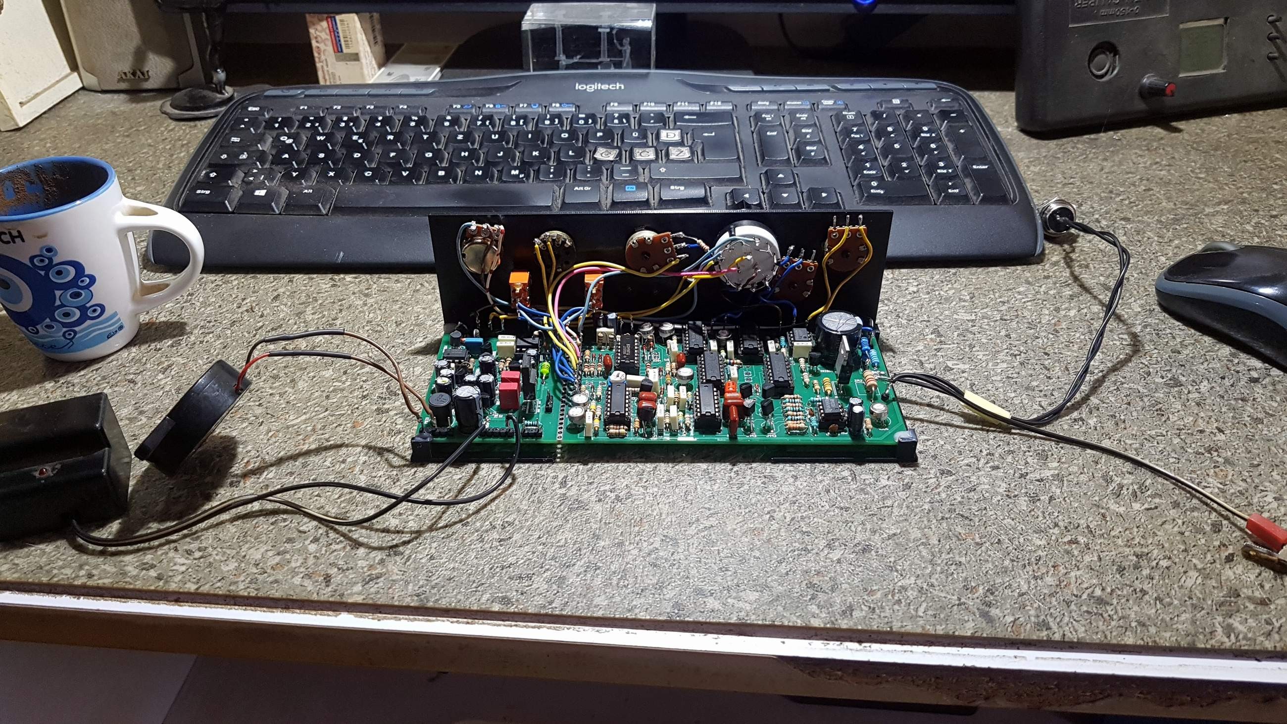

          • Ok here is what I was talking about.
            It is Eric's original pcb design.
            To make less clutter on the desk; I combined both pcbs into one file, so that in JLPcb they would do it as one pcb.
            But I left a "perforation" between both pcbs, in case I want to separate them.
            In the end, it turned out that the detector works in an unprecedentedly stable and calm manner, which can be seen on the video.
            Plus is powered by a very old bench power supply and not by a battery.
            So my amazement is all the greater that the detector works so stably, calmly and cleanly!

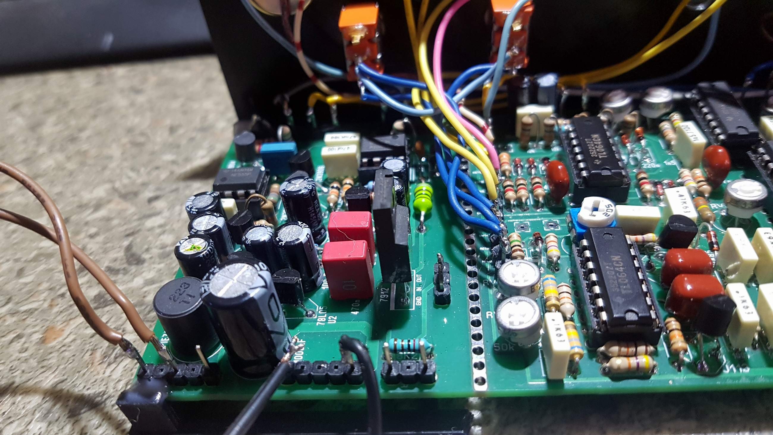

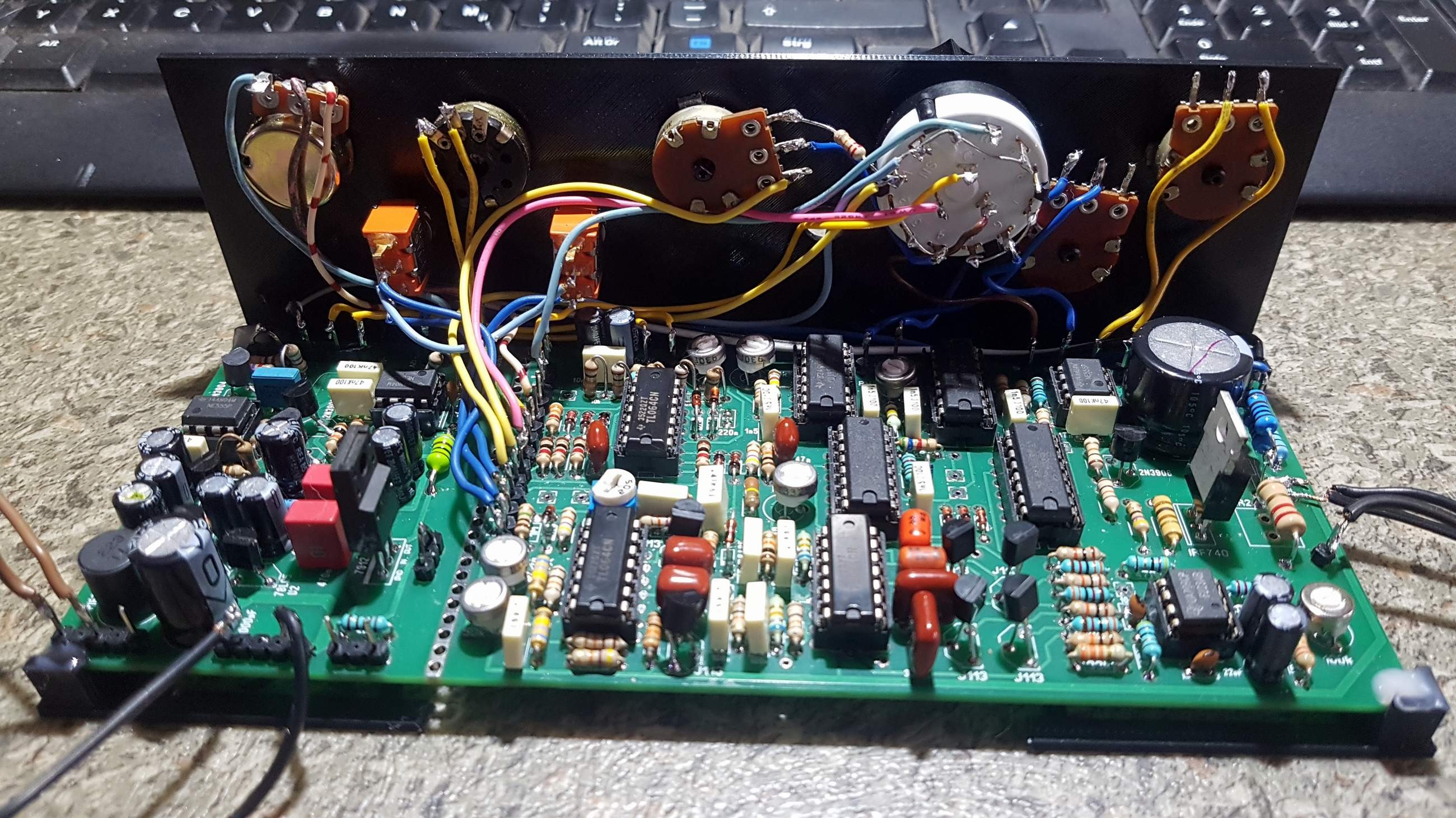

                • And finally, a couple of very important notes for those who would like to make this!
                  Forget gemranium diodes, total nonsense!
                  I guess Eric had a lot of those in stock, so he wanted to use them!
                  Not only are they a bad solution, but they also cause a big problem for the operation of the device and precise adjustments.
                  To fit all the different diodes I put a BAT86. On each diode place!
                  Instead of J113, which I can't find in local stores; I put J112.
                  All quads are TL064.
                  All other transistors are BC547/557.
                  The mosfet is IRF840.
                  All other passive components are of original values.
                  All other ic chips are according to the original schematic.
                  I adjusted the trimmer potentiometers according to the schematic provided by Alex.
                  Everything is 100% correct.

                    • "...gemranium diodes..."
                      • Coil from video is 18-19cm diameter, 0.43mH/2.9 ohms...
                        After 40 minutes of operating the IRF840 gets only a bit warm but never hot, no need for heatsink at all.
                        For the whole video duration; the delay is at minimum (don't have a clue about exact value).
                        PPS is at maximum, I guess it is 550pps as on Alex's schematic.
                        I don't pay attention on such side details, my focus was only on GEB and "Disc" behavior for now.
