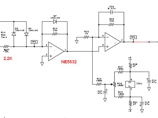

          • Lucafa, HH2 is the hammer. For modifications to the source, see page 8, post # 191. It's the same pattern I use.
            For the front stage, NE5532, see drawing.

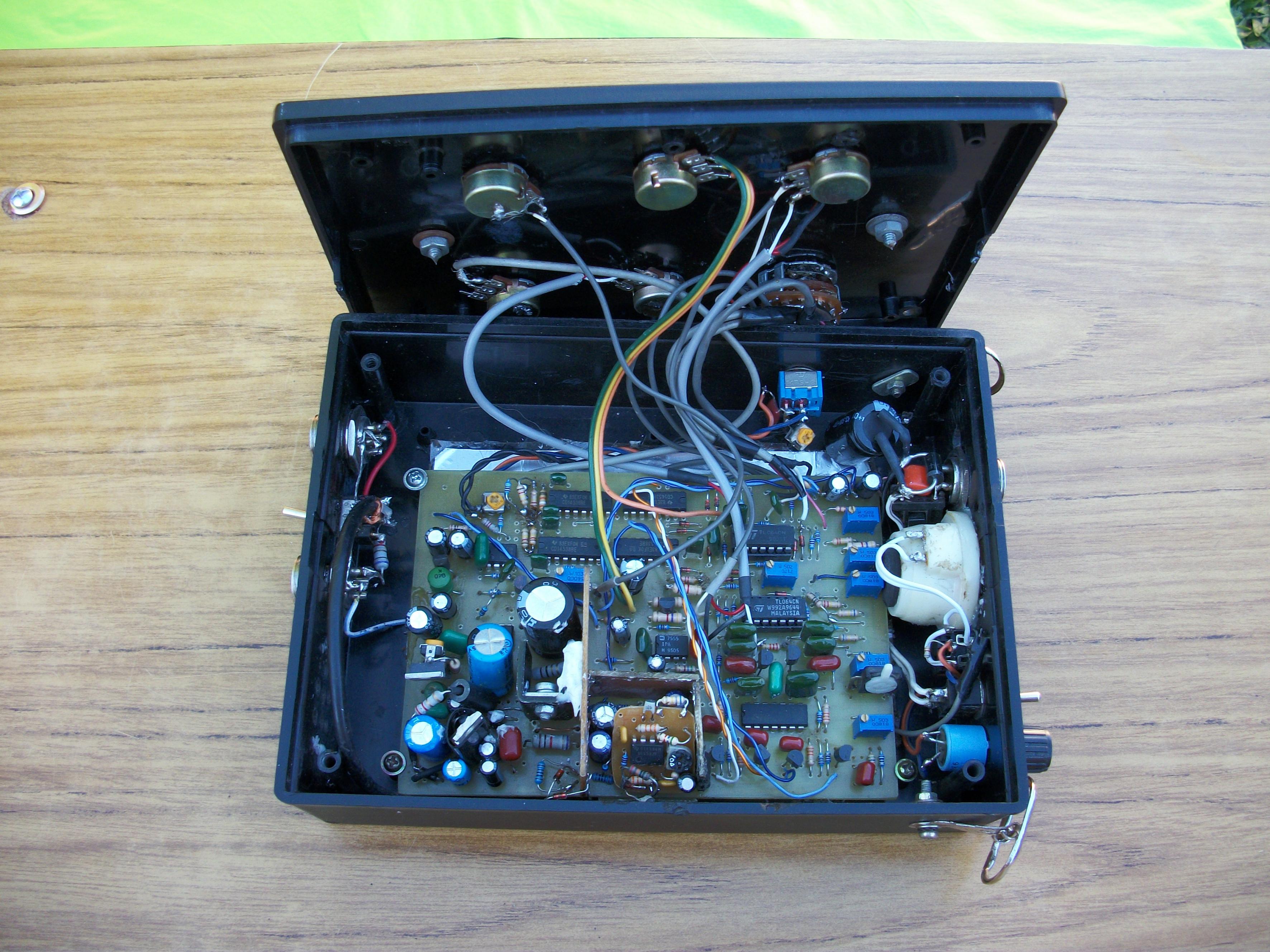

            Attached is a picture of my GS4 Mod
            Jose

              • Jose did you use C24 on your preamp, that cap is not supposed to be there.
                • 6666, Apologies, I forgot to correct.
                  Install in place 15 pf.
                  Jose

                    Jose you did quite job there, indeed.
                    But i think that you wasted your time trying to solve the stability issues at your GS made on that pcb.
                    Power supply stage is generating all the noise and it should be excluded from main board, just as on original GS.
                    That pcb is esthetically nice, indeed, but from designer's perspective it is not good at all.
                    It's actually a horror, referring the signal&power paths, gnd loops and interferences.
                    So, either draw better pcb, either exclude power stage from it and transfer it on another pcb.
                    Not only that; also try to correct some of the ground paths and put them all close and with together endings.
                    Maybe this is not possible on existing pcb draw, not sure.
                    There are some notes on one of the existing schematics, explaining which gnd's should be put together at the same spot.
                    So, custom pcb for handmade GS should be draw very carefully and with a lot of attention.
                    That is the only possible way to make it stable and accurate.

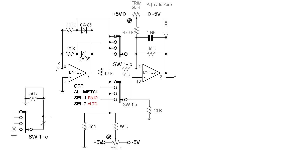

                              If anyone cares to experiment, here's one mods for tall drivers I'm rehearsing in, SEL2 mode.
                              JoseClick image for larger version

                                Hello Ivconic.
                                You played very well what I meant in the previous post, on the issues related to instability in the GS4.
                                I do not try to make the PCB, because I have not enough experience to take over.
                                I am willing to build another GS4, if they make the PCB, although the current, it's working reasonably well.
                                I would ask you please to try.
