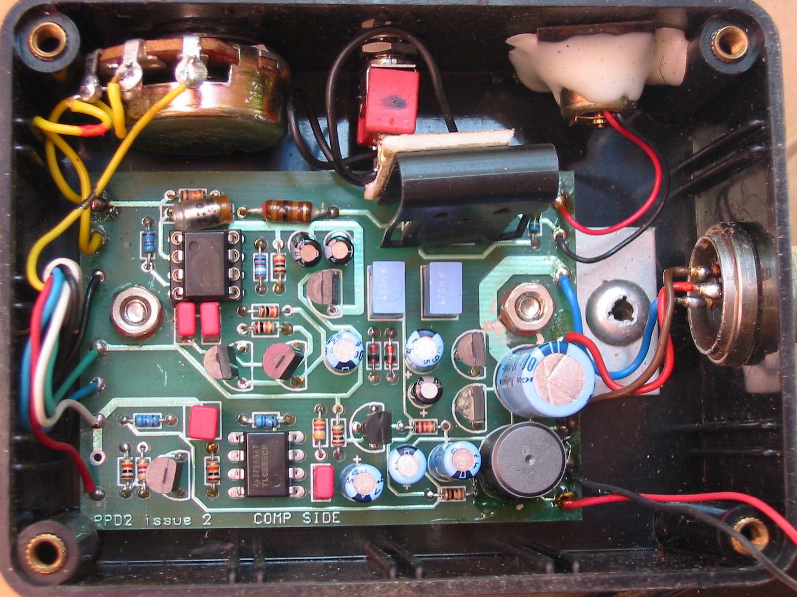

            • kt315 I know very well what is a black box in electronic.. But not finds something THE FOLLOWING IMAGES..
              DO ANY WRONG!! ?

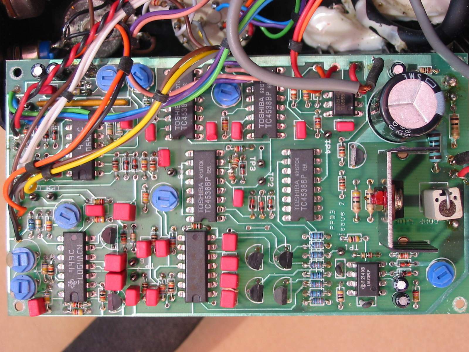

              Is not this goldscan iv ???
              • Hello G.S.
                On your photos this is the Goldscan iv. Is it yours?
                I think, with such a big coil you have to change some component´s on pcb. It is made for smaller coil´s.
                If your object is a high conducter, than you don´t find it with SEL1 or SEL2. You must go in Allmetal. But you could do the high conducter/ low conducter mod (an additional switch) from Reg. Than it should be possible.

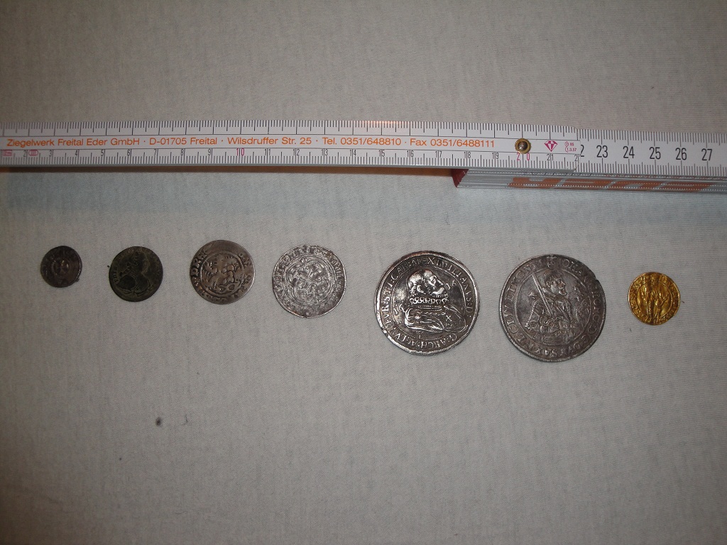

                    This is not correct. I think it will discriminate large object´s too. The only problem is, that the Goldscan4 in disc-mode only give a signal for low conducters, see coins 1,2,3,4 and 7 on the picture (small silver objects, e.g. thin hammered coins, bronze, cupper, gold and so on). If you have a high conducter, see coin 5 and 6 from picture (bigger objects from silver, e.g. massive coins like thaler, aluminium and so on) you don´t get a signal with goldscan4 in original setup.
                    For understandig i have some manual sheets of the goldscan4.
