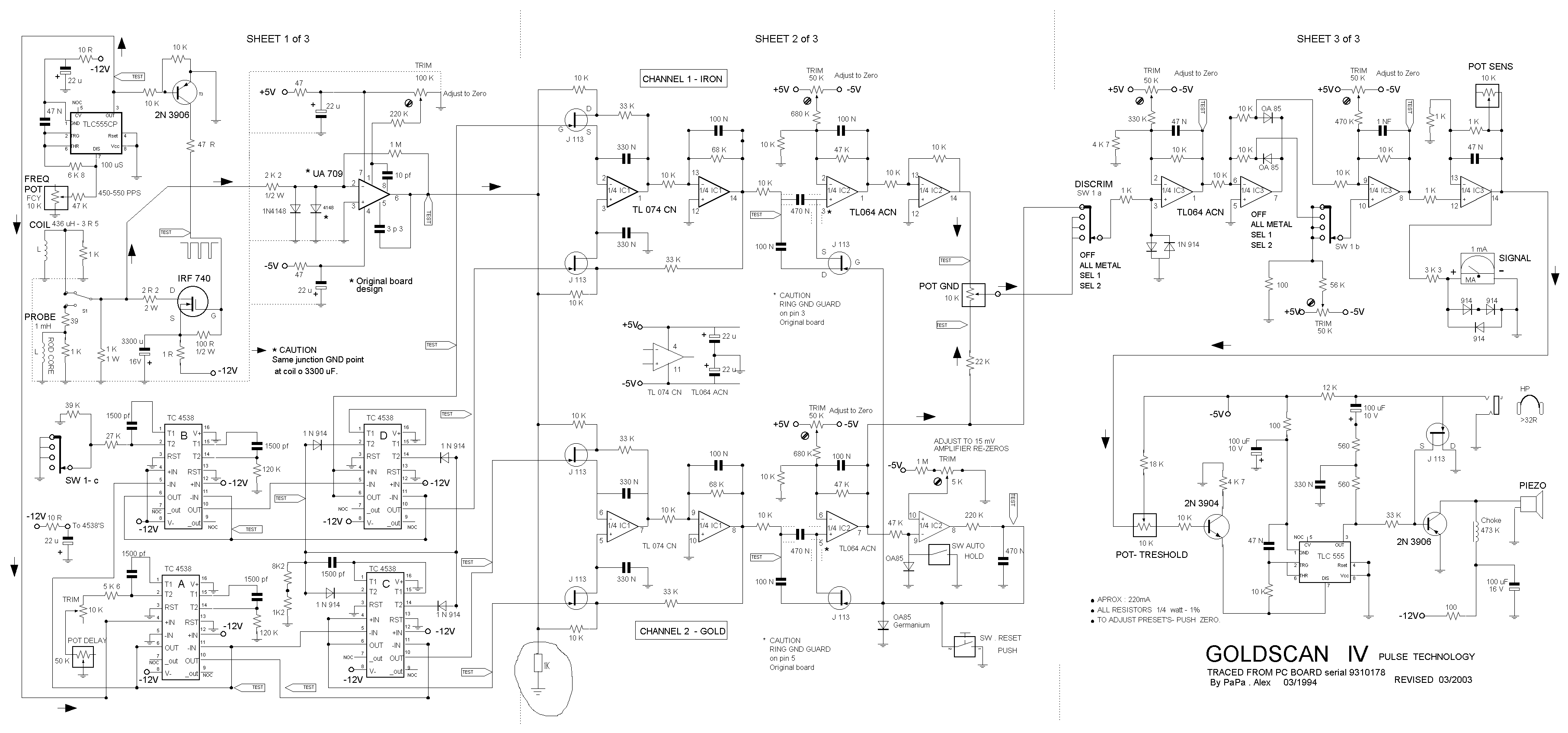

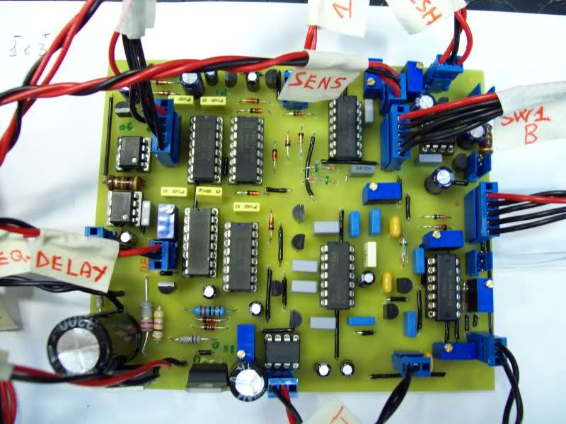

This is the way I set my GS4 and works well:
Do you have to be a leg to adjust RV5 U13 at 0 V instead of the leg 7?
"Yes !!!"
Adjusted R8, to 0 volts on pin "6" of 5534, with the coil connected, away from all metal.
All adjustments in position 2, "all metal", follow the steps outlined above in post 102.
After adjust RV7 to 0 Volts in pata "8" of U13 C, Change SW1 in position 1, "OFF", and adjust RV6 to 0 volts again in pata "8" of U13 C.
Check iron rejection mode is "SELECT 1" No. 3 of SW1.
Prepare a video later.
