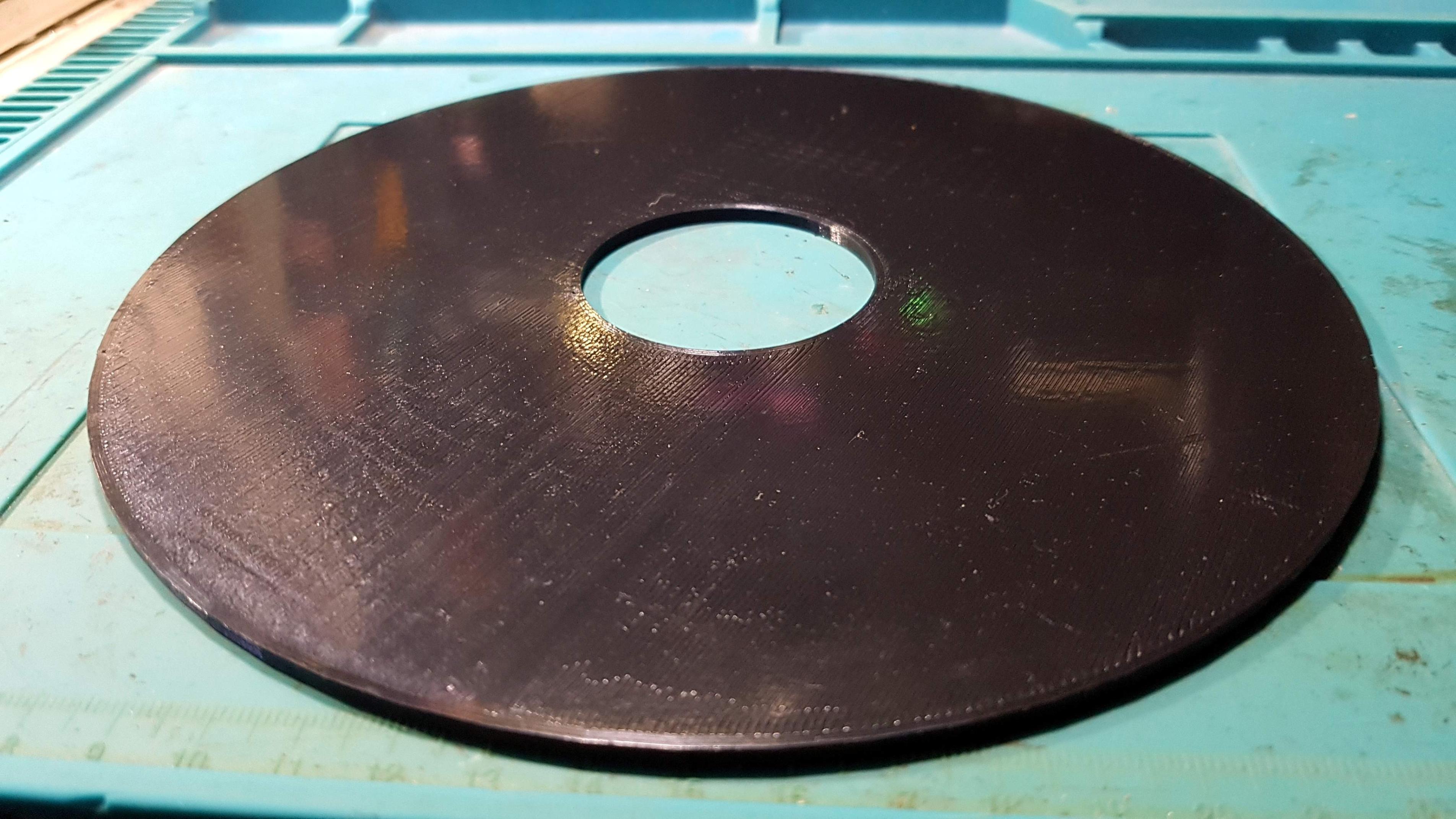

    In meantime I tried to act too smart and make spiral coil for GS4!
    Theory and practice... as per Murphy; it is always proven that in practice everything is always more difficult, sometimes even impossible, while before that everything seemed easy and doable in theory!
    It was a big job in Tinkercad to design and calculate such a body for a spiral coil! It turned out perfectly fine! And it printed perfectly fine!
    My delight was endless today when I saw how well it turned out.
    But when I tried to insert a wire into the channel... my disappointment was endless too!
    Because I barely make half a circle and the wire pops out somewhere halfway, what have I not tried!
    I struggled for an hour and finally gave up, this is impossible! It is impossible to insert the wire into the channels, 40-50 rounds and keep it still and straight as it should be!
    The only way to make a good spiral coil is to print it as a pcb... but before that you need a really very precise calculation. And for the sake of testing, I checked in JLPcb... it wouldn't be very cheap!
    Here are some pictures:

        Why don't you try gluing the thread inside the channel with a hot glue gun? My idea would be to put a little thread inside the channel and then apply a dot of hot glue to hold it and then do the same until you finish the job. You could also hold the thread with pieces of paper tape, etc.
        • The channels are too narrow. I've thought about various solutions and haven't found a single good one.
          • May be you should try filling the channel with some sticky substance, like honey, and then putting the wire inside...
