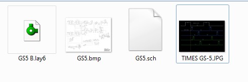

      Why don't you make the GS-5?
      In my opinion it is a better detector than the GS-4.
      In the past I made a LITE version of GS-5 and it worked very well.
      My LITE version has the identical time base as TDI SL.
      The VCO is very nice, because it has a CD4046.​
          https://youtube.com/shorts/2tXTbySBUD4
          The schematic is damaged, please send it separately.

            • Everything opens fine for me... I don’t use the schematic file

                What do you think is the essential difference between the GS4 and your GS5 regarding the problem of loss of depth in GEB mode with the GS4?
                I assume the schematic and pcb you posted is 100% correct?
                  The schematic and PCB are correct. I don't like posting things that don't work. The main difference between the GS4 and GS5 is the GEB circuit. They are two totally different forms. The GS5 has the GEB the same as the TDI.

                      • All JFET transistors can be replaced with a CD4066. In my new detector I removed the J113 and put CD4066 in their place. I make a small parenthesis...J112 do not work well, J113 are the ones that work correctly. I say all this because I tried it at the time.
                              I'm really "lucky", because I put J112, I couldn't find J113.
                              Of course, that's not the complete reason, but it's certainly one of the reasons why my DIY doesn't have some "depth".
                                You could try to make a modification, replacing the J112 with a CD4066. The bad thing about all that is that you have to do it with cables and that is not good, because the cables generate noise and right there the noise is of no interest.
