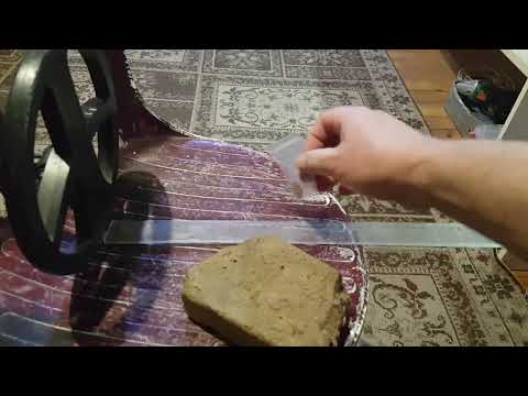

    And the coil for the GS4 is, as I mentioned several times, about 17cm.
    On the "collage" of the picture of Garrett, in the lower right, there is also a picture of a ruler and targets with distances.
    The GS4 achieved IDENTICAL distances on the same targets with a 17cm coil.
    It's just that I didn't show it on the video because it's very inconvenient to place the ruler under the coil.
    And there's no need to be so detailed, I guess you take my word for it, I don't have the slightest reason to make anything up and exaggerate.
    On the GS4, the delay is still ≥10uS. I still haven't tweaked anything since the last time.
    GS4 is in GND mode, GND is set to that 5th century brick. The same is the case with Garrett.

        I hope that now you have a clearer picture of the situation on the grounds that I visit and about which I have written many times.
        To whom the video is not clear; let me clarify a bit...
        The first program on the video was my custom "deep" program at 7.6kHz.
        In that program, the gold coin is detected at a distance of 24 cm.
        But when I put a brick in front of a gold coin; the range drops to 14-15cm and PLUS Deus reports it as a bad target, very unstable and inaccurate response with many errors, very erratic behavior, etc.
        In the second part of the video, I switched to the Fast2 program, my custom program at 18kHz with silencer at 3 and recovery speed at 2.5
        The range to the gold coin dropped drastically to barely 14cm, and when I put a brick in front, it drops further to about 10cm or less. And it also reports the target as bad, as "trash"...

                What I forgot to emphasize here is the following...
                In the video, Deus sees a gold coin through a brick in all possible wrong ways... but still sees that gold coin, even as it's "garbage".
                However, it is a recent gold coin, from 1751. And it's bigger.
                While in real conditions on real terrains, I mostly look for ancient Roman gold coins, which are slightly different in terms of alloy composition (better with more gold).
                Unfortunately, these days I have not been able to find one of these on loan for these tests.
                The problem on the real field is that Deus often does not see such gold coins at all, even as "garbage", it simply remains silent above such targets.
                So what can be seen in the video with Deus... can even be considered a "success" even though it is essentially a horror factual situation.
                So... so much for that. It definitely makes sense to build (or buy) some similar PI and go back to the old sites again.
