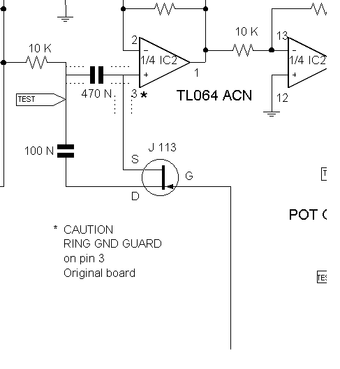

        Now only key "RESET" just is not working??
        All the problems that I have a solution
        Thanks Only Jose

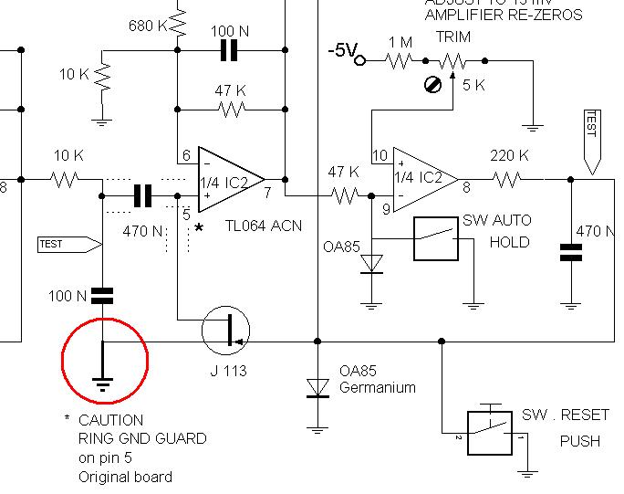

            Check the PCB that the "D" of J113 in both channels are connected to GND.
            JoseClick image for larger version

            • it is not D/Drain of J113. I see S/Source transistor pin on the schematic you marked. Drain pin is above.
              • KT 315
                In post # 4 you could see in this way the location of the drain and source.
                Anyway, Geotech forum members, saying that small signal configurations as in this case, drain or source can be connected either up or down.

                • ooh main God... why you so are disliking the electronics...

                    • KT315, from the point of view of Fet electrical symbol, you are right.
                      We would have to see if it was error to draw the diagram, sketch on paper.
                      Jose
                        Jose[ATTACH]24235[/ATTACH]
                        Hello
                        Brother josie you beautiful greetings
                        I have searched in connection j113 and grandmother fully connected
                        Congratulations I wish you.

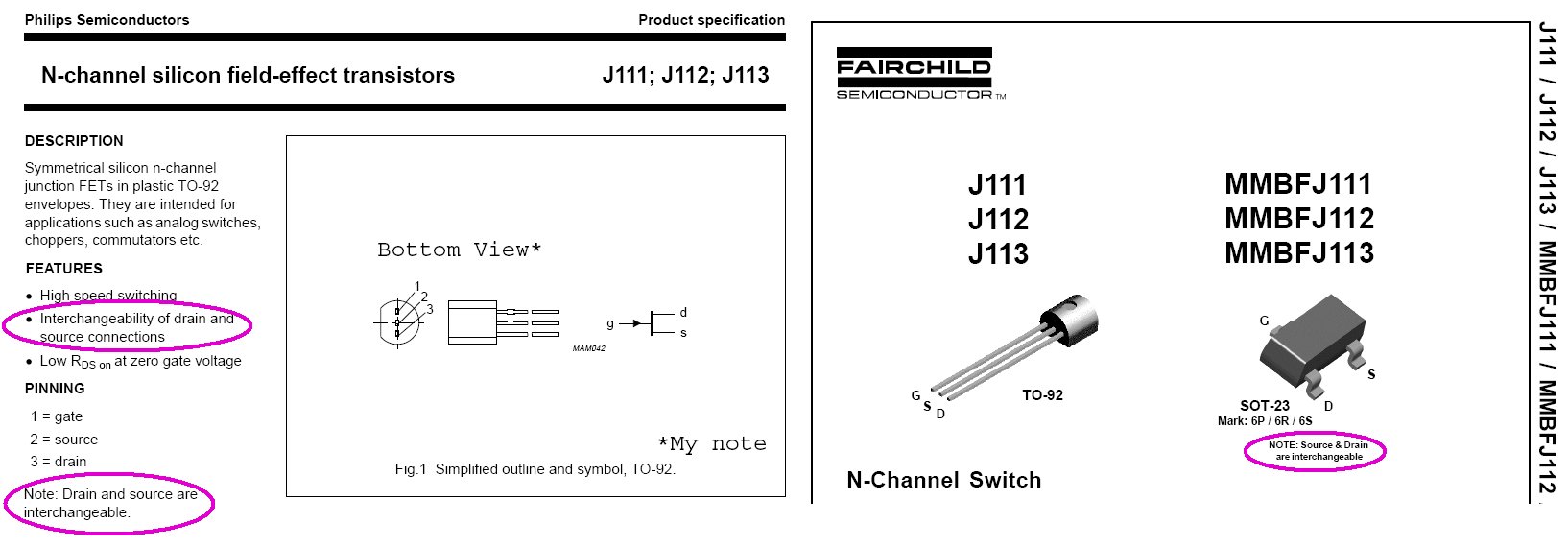

                          Some manufacturers will tell you if a particular JFET has interchangeable S & D. Other manufacturers will have the "identical" part number but their data sheet will say nothing about S-D interchangeability.
                          For instance, the Philips (NXP) and Fairchild data sheets, state "S & D are interchangeable" for the J111~J113.
                          Vishay's J111~J113 spec sheet, however, makes no mention.
                          Another way of stating S-D interchangeability is "symmetrical".
                          Not all JFETS are symmetrical. Do not assume that all JFETS are symmetrical just because some of them are.
                          2N4393 looks like it may be a good sub for J113 and Fairchild's 2N4393 datasheet does state S & D being interchangeable.
                          EDIT: So, what this all means is that if you are doing a PCB layout and run into a problem with a J113, you can sometimes side-step the issue by making a pin-swap.
                          You can get an ohm-meter and measure from G-D and G-S and you should get identical readings. Same with a diode test.
                          • BF245 is by definition a symmetrical one. It is easier to find it here than the J parts.
                            When mentioning the diode test, next time check the barrier voltage ... it is lower than the usual silicon diodes, as they are not doped as much. May come handy sometimes.
