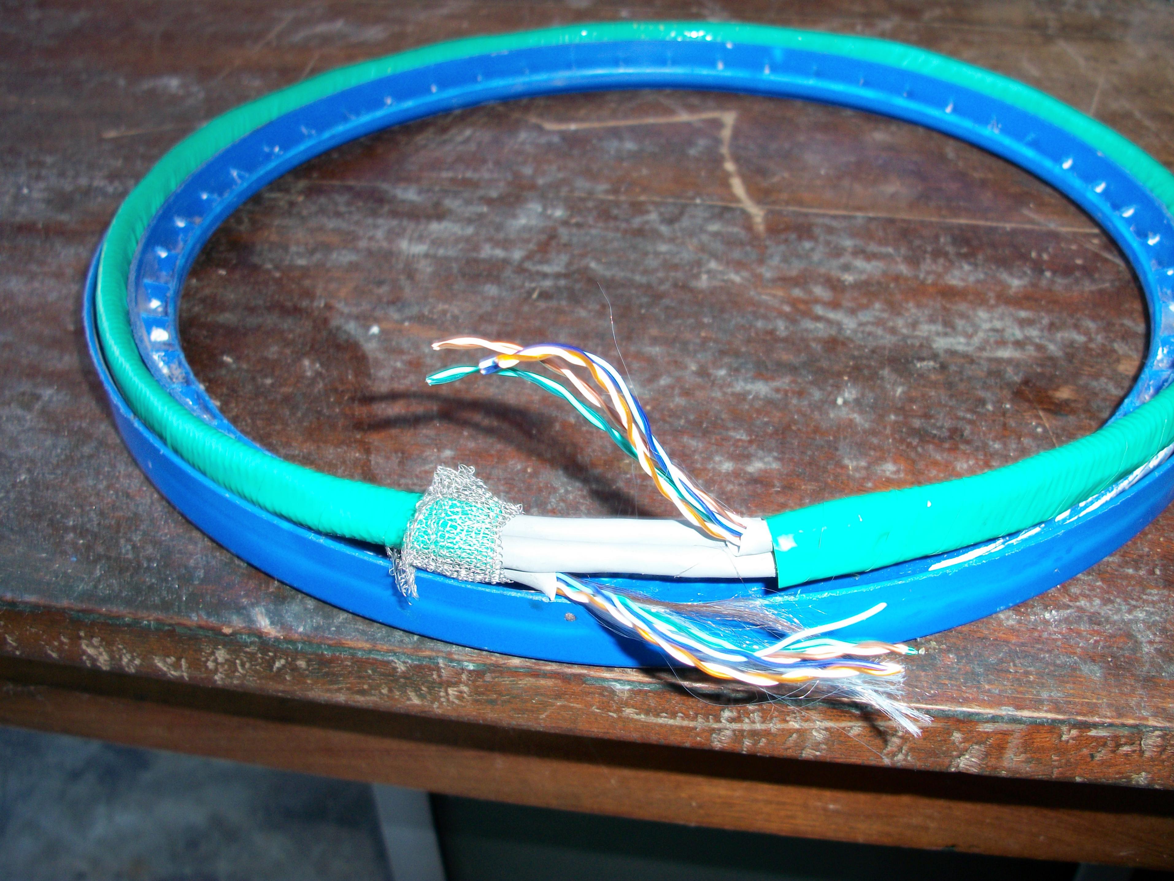

                A question, you can measure how diameter of only one conductor and how many individual small wires is composed ?
                I want to be sure to use the same material to compare the results.
                If you write me also cable serial number would be perfect.
                Regards.

                    Number of small individual wires 7
                    diameter of only one conductor about 0.05 cm
                    Thanks for helping me

                      Lucafa
                      The cable is known as UTP or CAT5 for computer network, consists of four twisted pairs, eight in total, and the diameter of each conductor is 0.5mm.
                      Cat6, the driver is alrrededor diameter of 0.6, with a little more insulation, the two works well. Cat5 is easier to work for its lower section.
                      Attached is a photo, where observed the cable insulation with Scotch tape No. 24, makes a shield.
                      In the photo is a single coil, you must perform two coils with 2 laps each with diameters of 20 and 30 cm., connected in series as shown in the post above.Click image for larger version

                        One question, have you tried to use graphite spray for the screen?
                        Metal grid great screen with a reduced signal transmission and reception.
                        If you use graphite, 10 ohm cm have a perfect shield, but not metal.
                        Use in this way.
                        Building coil as you want, paper tape wrapped around the coil, 1x1 cm piece copper (recovers from pcb) with welded wire 5 or 10 cm, glued with hot glue a piece of copper tape, spray graphite thin layer and wait until dry. Measure resistance per cm, if not 10 ohms make another layer of spraying.
                        When good results, connect the screen to shield wire coil.
                        The 10 ohm as a guideline, try resistivity is high and excellent result.
                        For example VLF coils have resistivity screen from 3 to 7 kilo ohms.
                        regards.
