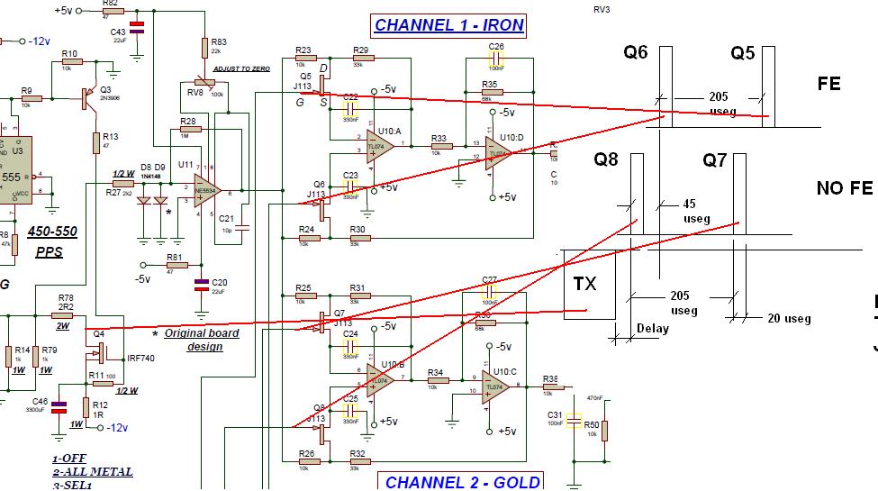

LOOKING FOR GOLDSCAN 4 Schematic.
  • Because it is not necessary to destroy the Goldscan. The above schematic is good and we can use it as base.
    Another reason is that we have no more opportunities for comparison.
    Now we have to change some parts and reduce the components, so it can be a nice, simple PI with GB.
    I would leave out the probe and the meters (amperemeter and voltmeter). Then we have to look to the ideas of reg to change some components to more precise one, so we can left out some intern trimmers.

                Here is the pulse sequence of the GS4.
                Alexismex's schema is correct.Click image for larger version

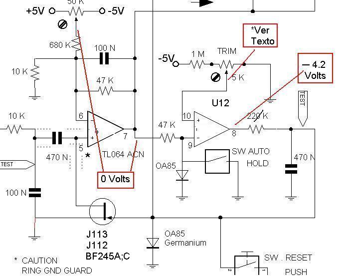

                • Hi Ranko
                  Set U12 as shown in the diagram.
                  In normal operation, the voltage at pin 8 of U12 must be 4.2 Volts negative.
                  Set to 0 volts, pin 7.
                  Set to a few negative millivolts on pin 10. Until you get around 4.2 Volts negative on pin 8.
                  The marked resistance of 220k. I use 22K.
                  Use BF245 A, B or C.
                  J113; J112.
                  Other JFETs may not work in this scheme.
                  JoseClick image for larger version
Name:	GS4 U12 Ajuste.JPG
                    Hi Ranko
                    Alexismex's schema is correct.[ATTACH]40177[/ATTACH]
                    • Jose thanks for the Secuencia de Tiempos file.
                      Really useful for any builder should attempt to build it to have the correct timing diagram.
                      • hello I see an error in the position of j113 --- of pcb..1: D 2: S 3: G .. that is the order of the pins because pcb is placed in a way difirecte to the scheme?
                        • hello ... I have doubts on how to connect j133 .. the Q8 and Q6 .. in some pcb appears pin 2 (s) from j113 to U10 PIN 5 and to 3 ... in other pcb appears differently, pin 1 (d) connected to pin 5 and 3 ... could someone help me? .. what would be the correct way to connect q6y q8 .. help please
                          • The "S" terminal connects to GND.
                            • hello jose thank you very much for your answer ... I mean I understand j113 pin s is connected to pin 5 and 3 of u10 ... and grounded through c25 and c26 ..
