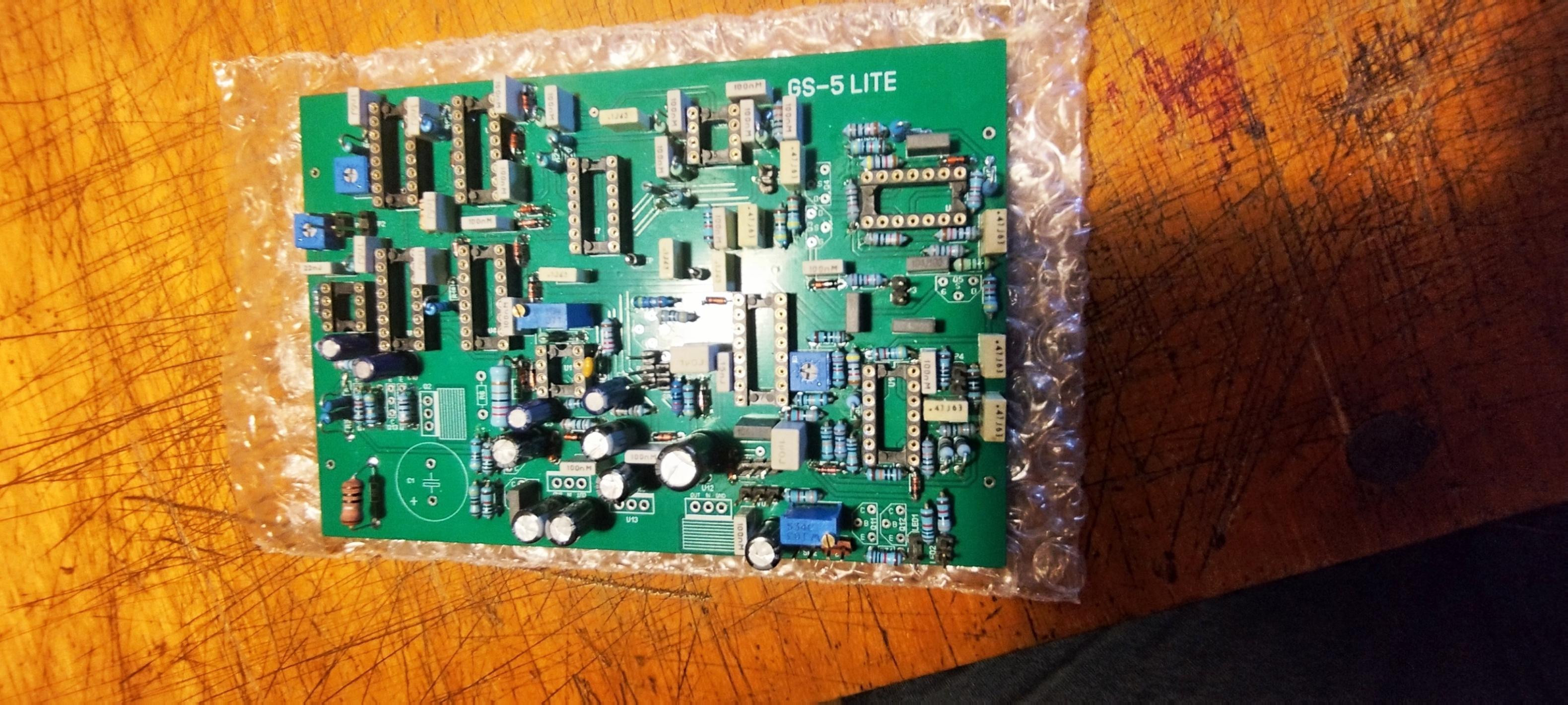

              • Hello, I finally received all my components and have reached this stage of the build. Could someone help me with the adjustments for V1 through V5? Do I need an oscilloscope to set them correctly?

                • Good luck… But I don't think it will work the way you're imagining, with people explaining how to adjust all the potentiometers. Judging by the board's appearance, it seems like you've simply populated it and are now asking how to "adjust" it. That's not the right way to do it. You have to populate and test the circuit module by module. Only proceed with the next module if it's working. An oscilloscope is absolutely essential.

                    Initially, you can leave the trimpots in the noon position. After operation, perform fine adjustments using an oscilloscope, setting the frequency range using VR2.VR1 is the 0V adjustment for the oscilloscope probe connected to the TP pin.

                          • Thanks for your help.
                            I’ll replace C2, C3, C5, and C10 with tantalum capacitors. Then I’ll finish building the circuit, and if everything works, I’ll try to learn how to use my oscilloscope to adjust VR1 and VR2 properly.

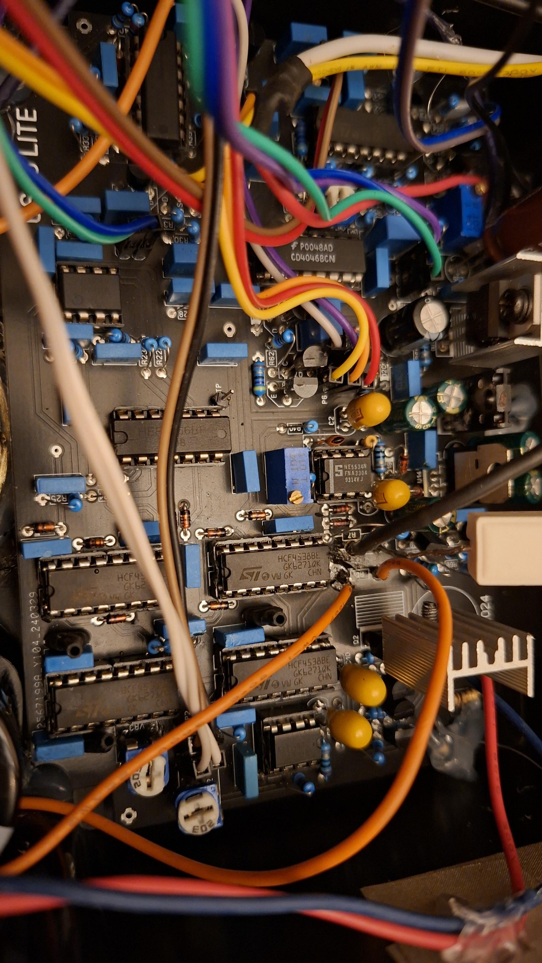

                            • Unverify, unchecked. GS5 lite with less cable.

                                Hello Geo Max and hello everyone. Well...you were right, it didn't work. I'm going to start all over again.
                                What is the assembly order for the module steps? I'll try to learn.​
