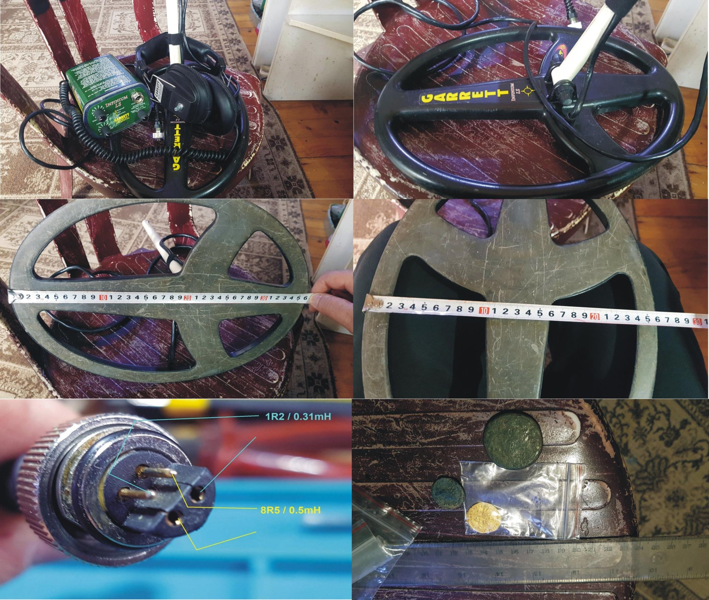

                          • For the purposes of any comparison; I borrowed a Garrett Infinium LS from a friend.
