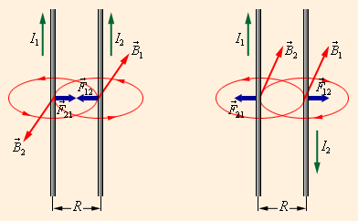

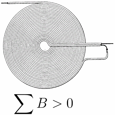

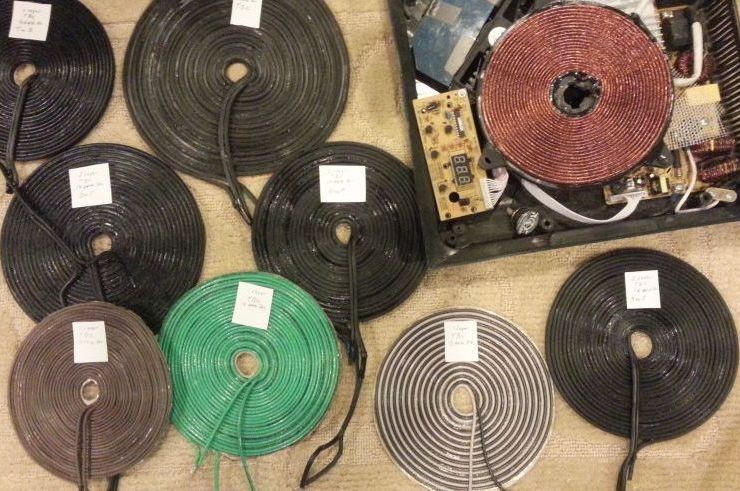

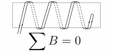

                  • Два типа бифилярных катушек
                    Тесла 1. и Купер 2.
                    Click image for larger version  Name:	1549387855_32.jpg Views:	3 Size:	130.1 KB ID:	438969
                    Click image for larger version  Name:	1549387866_1.png Views:	0 Size:	71.4 KB ID:	438970Click image for larger version  Name:	1549387874_2.png Views:	0 Size:	9.3 KB ID:	438971
