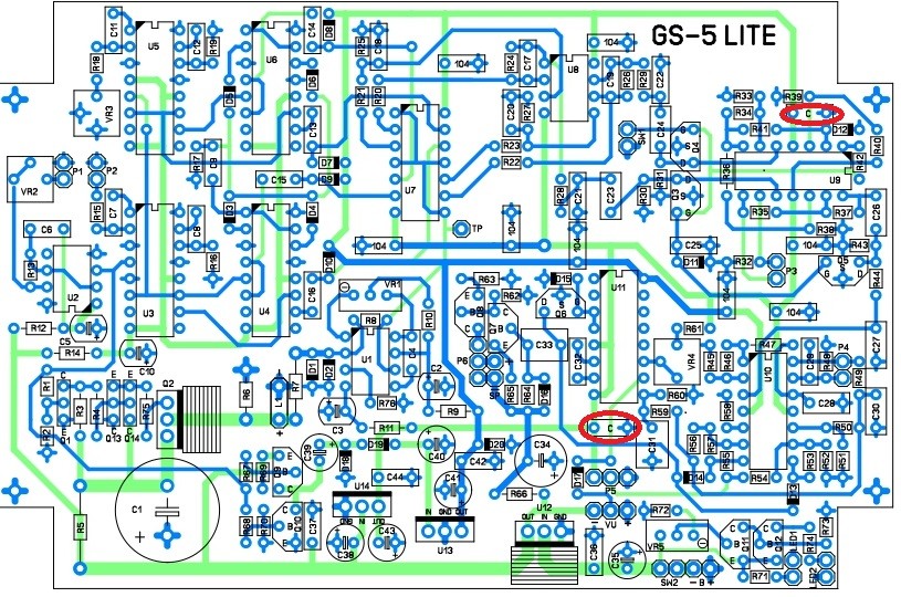

    Click image for larger version Name:	GS5 B.lay6]EDUARDO_pageZA GEOTECH.jpg Views:	0 Size:	233.1 KB ID:	422274
    ​ Hello Eduardo, I want to ask you what value are the capacitors with the letter C enclosed in the photo, I could not see them in the schematic. Thanks.
    100nF.
      100nF.

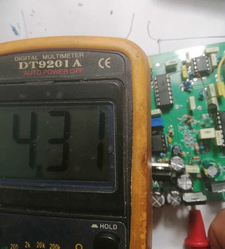

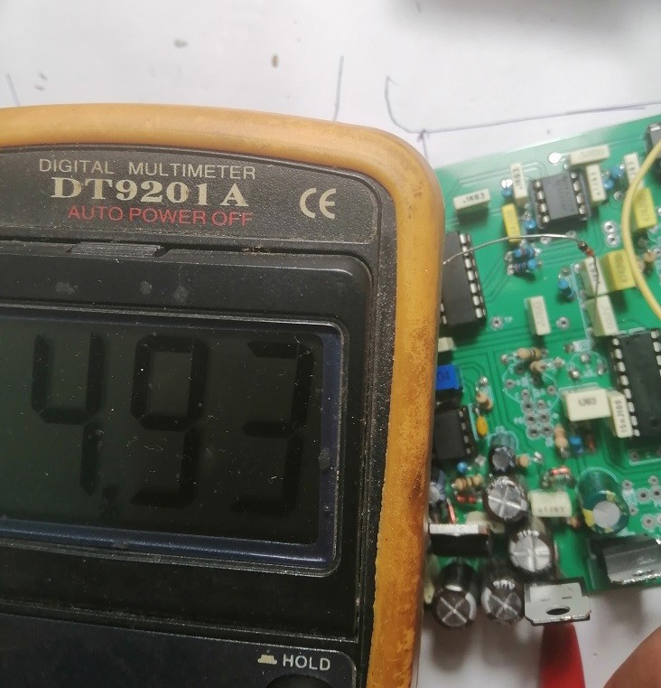

      Hello, Eduardo, I have 4.93 volts at the output of the LM7805, but when I solder diode D15, the voltage of the LM7805 becomes 4.17 volts, when I desolder it, I still have 4.93 volts, what do you suggest, I think that this voltage should not be change
      • Originally posted by algan View Post
        More precisely, when the Q6 transistor is soldered and the voltage drops to 4.30, I tried with different types of transistors and it still drops, there is some problem, I think there is a problem when I remove the transistor, the voltage is ok
            Don't worry about the voltage.
            The scheme is correct.
            You have to respect the values of the components.
            The JFET transistors have to be J113.
            You can remove diode D15 if you want, because the detector works without it.​

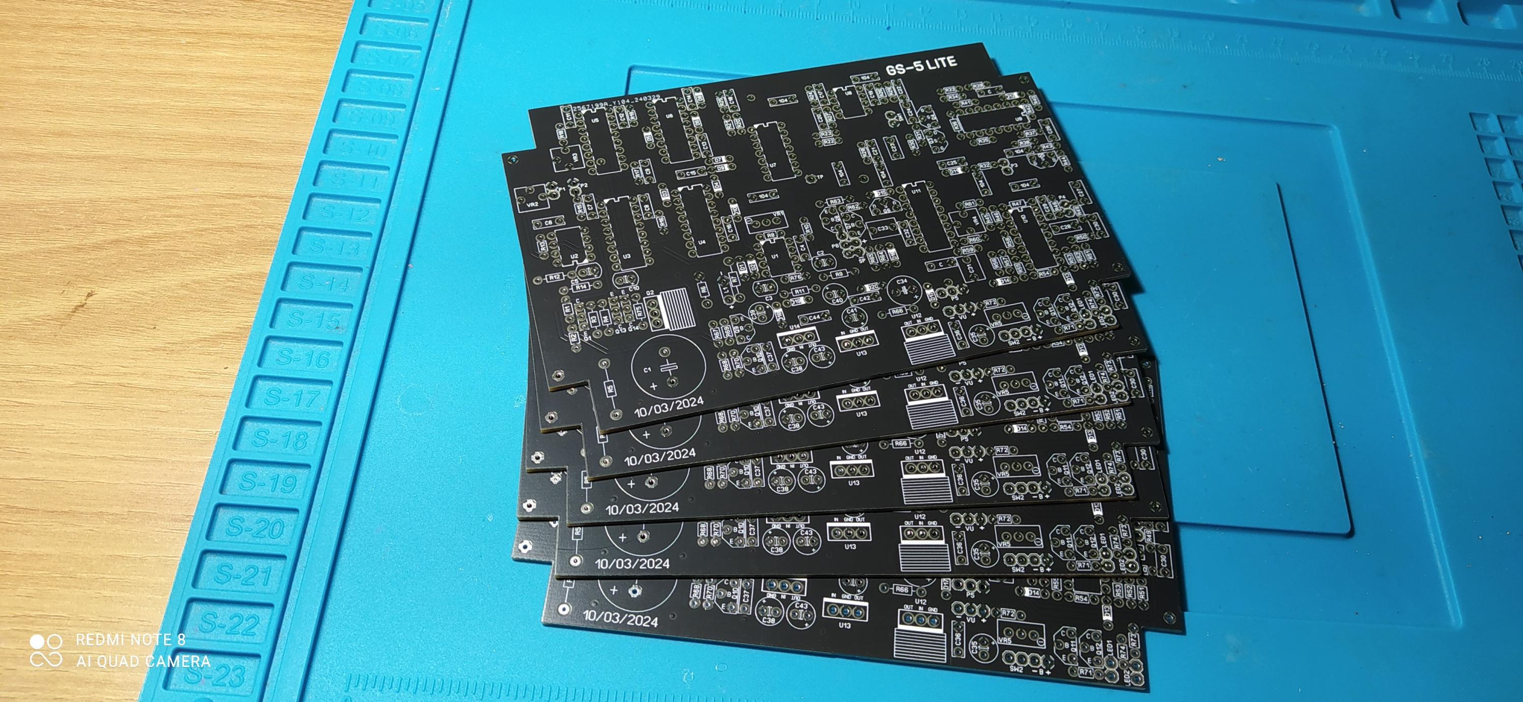

                            • I got my PCBs Click image for larger version
                              • In the schematic, the diodes described as 85 are BAT85?​
