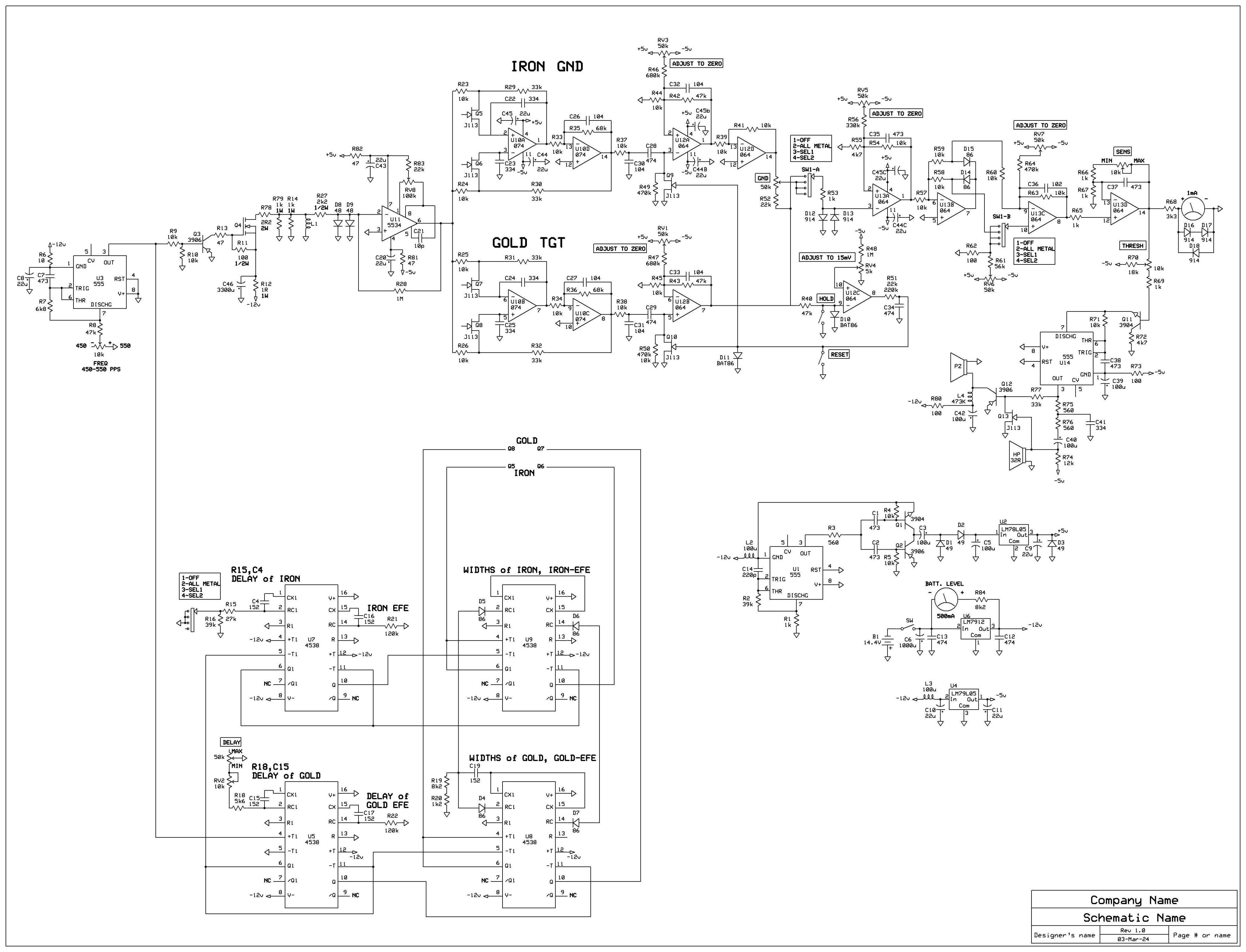

LOOKING FOR GOLDSCAN 4 Schematic.
  • I think the voltage at the end of the swing is maximum it is mainly caused by the change of direction of movement, the coil sees the earth's magnetic field +65 μT then - 65 μT ...
    Now I see that U2 is just preparing the signal for processing and changes from coin will be visible at the output of U4​
    Click image for larger version  Name:	image.png Views:	0 Size:	715.8 KB ID:	421134 ​
      I think I understood what you wrote.
      Yes, the R27...someone suggested earlier, and I agree, that it's better to put a 1K there.
      And if I put anti-parallel diodes, then the value of R27 could be slightly lower.
      Your opinion? And the difference in two diodes in the same direction and two antiparallel ones?
      Is it related to the fact that the "ground" is at a potential of 14.4v?
      My preference is to always use antiparallel diodes. One to clamp the flyback and the other to clamp the -14V. You can lower R27 to improve thermal noise but often I leave it a high value (even several kΩ) as I find that EMI is usually higher than thermal noise. A higher value for R27 also makes the diode clamp much faster which lets you sample earlier. It's one of those things to play with.

        • For more serious experiments; first it is necessary to transfer the schematic to editable form.
          I respected the numbering of the components as in Alex's schematic so that there would be no confusion.
          Like always Schematic is done in : https://www.expresspcb.com/
          Bellow is packed editable schematic file... ​
          Click image for larger version  Name:	GS4_Carl.jpg Views:	0 Size:	783.5 KB ID:	421168​

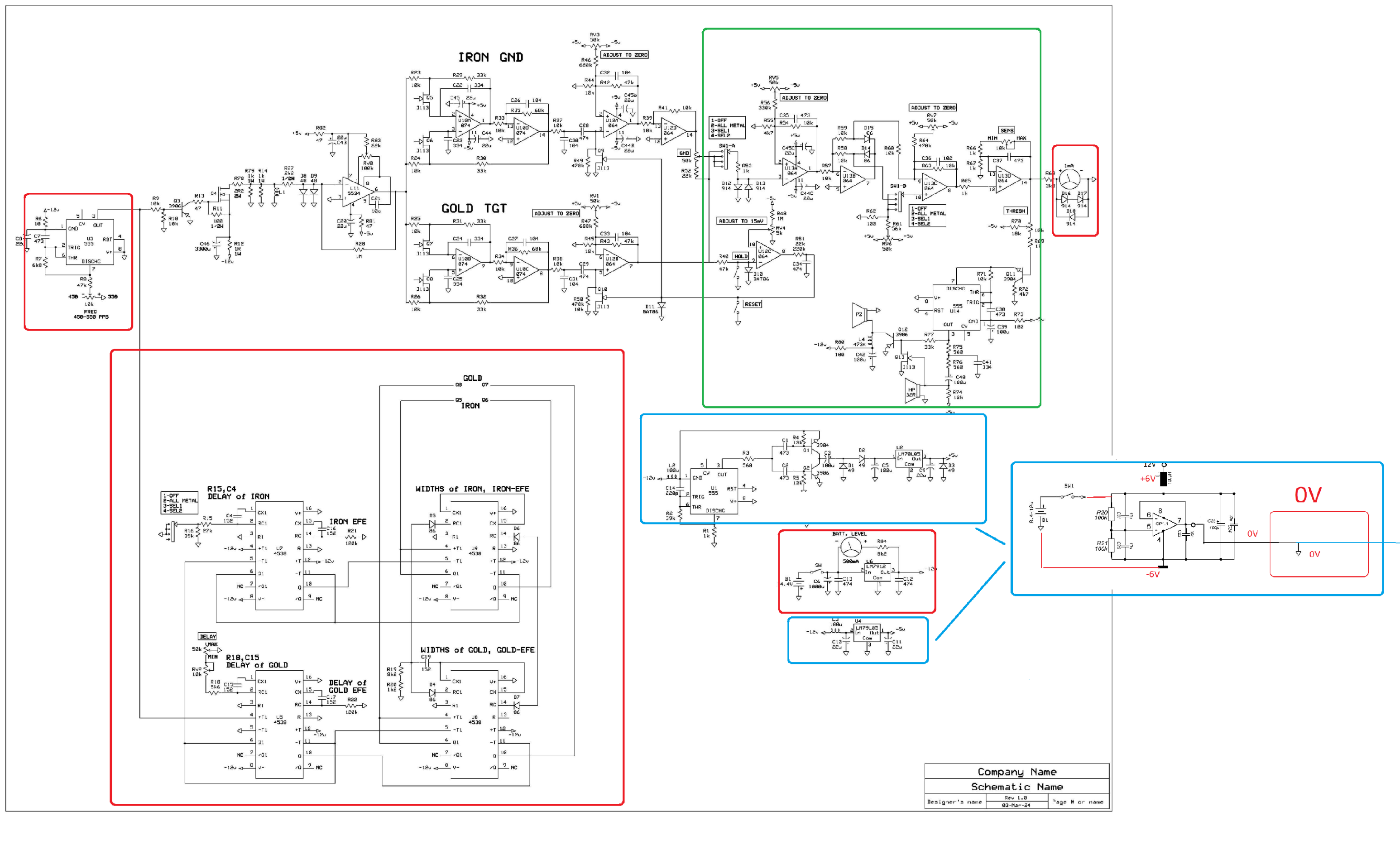

              • Circuit Modification First Step;
                blue line = power modification
                red line = can be replaced with stm32f103,
                Second step;
                green line = final modification​

                • The reduced range is due to mixing two channels. = instead of mixing we can calculate the magnitude and phase using stm32

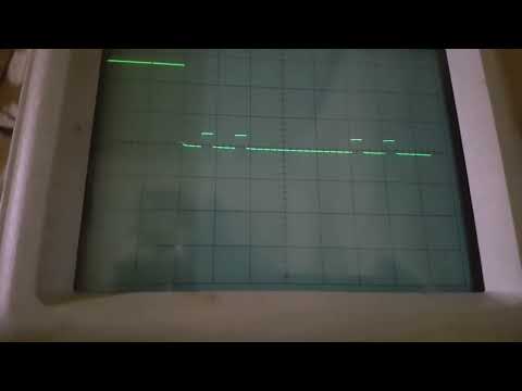

                        • Ok, 10k gives me 890-1300 Hz !!! Wow!
                          Behavior of the detector hasn't significantly changed... except this; with loud audio detection overall power consumption now is .... 150mA !?????? WTF???
                          Carl you gonna love this; yes you are right, all 5 pulses can be scoped at the same time!
                          Here is the Delay behavior and timings:
                          • Approximate timings:
Name:	All5 pulses.jpg
                            • One thing confuses me, however.
                              Last time the pulses on the gates were 4Vpp while on Q4 it was around 3Vpp and now that has changed and now the pulse on Q4 is around 5Vpp and on the gates it is 1v ???
                              Last time I monitored 3 pulses simultaneously and now all 5.
                              Last time it worked at 500PPS and now it works at 1000PPS.
                              What of all this is the reason for this change???

                              • @ Carl,
                                My BAD!
                                Shameful!
                                I completely forgot to check RV2 and it was not completely closed, that's why shortest possible delay in previous case was "≥ 30uS".... WRONG!
                                Now when I turned RV2 to 0 resistance; situation has changed, actual shortest possible delay on original GS4 setup is "≥ 10uS" and that's now correct!
                                Also noticed one more thing, previous confusion about peaks of pulses... scoping only Q4 gives amplitude slightly over 8Vpp.
                                Adding second pulse (via 10k) is decreasing it to 6Vpp and so on. Q4 with all 4 other gives as on above photo 5Vpp.
                                And that part now is clarified. But Q8,Q7,Q6 and and Q5 still remains at ~1Vpp ???
                                I changed PPS down to 380Hz and nothing has changed, still all 4 are ~1Vpp. Misty??
                                Anyhow, now with shortest possible delay, 1000PPS, GND mode, smallest coin is detected much better, clearer! Bingo!
                                And there is another "intrigue" to solve, Carl you try to explain this; 1000PPS....all as you see on posted photos and yet overall power consumption with loudest detection is rock solid 150mA ???
                                How come?
                                This is "battery saver" solution! What if... 2000PPS... and more?
                                Probably as I adjust wider pulses the consumption will rise a bit...
                                Fun! Fun! Fun!
