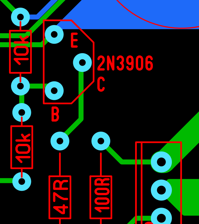

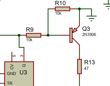

    I put it right according to schematic:
ID:	421880​Click image for larger version
    • I put BC557 there with "CBE" pinout.
      For a moment I got really happy and wished you were right!
      Unfortunately you are wrong, I put the transistor just right.

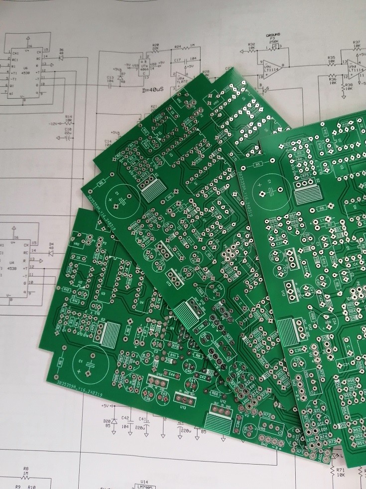

ID:	422179 boards arrived today

            the GS5-LITE Click image for larger version  Name:	IMG_20240328_155751.jpg Views:	6 Size:	264.9 KB ID:	422179 boards arrived today
            Wow!!!
            When you have everything finished, tell us how everything goes.​
            • Hi Algan,
              nice PCB... have made no PCB mounting holes on purpose? For what enclosure have you made the PCB? And does it already contains Carl's modification suggestions?

                I also ordered mine here in Brazil, it takes a while to arrive.
                  Hi Algan,
                  This is on Eduardo's board #542
                  yes, I removed the holes for mounting the circuit board, and for attaching to the box it is the easiest, the important thing is that everything else works.​
                  • Have you tested the PCB already? And it works correctly?
                      I haven't tested it yet, but Eduardo wrote that it works and there was a short video, if I test it I will tell

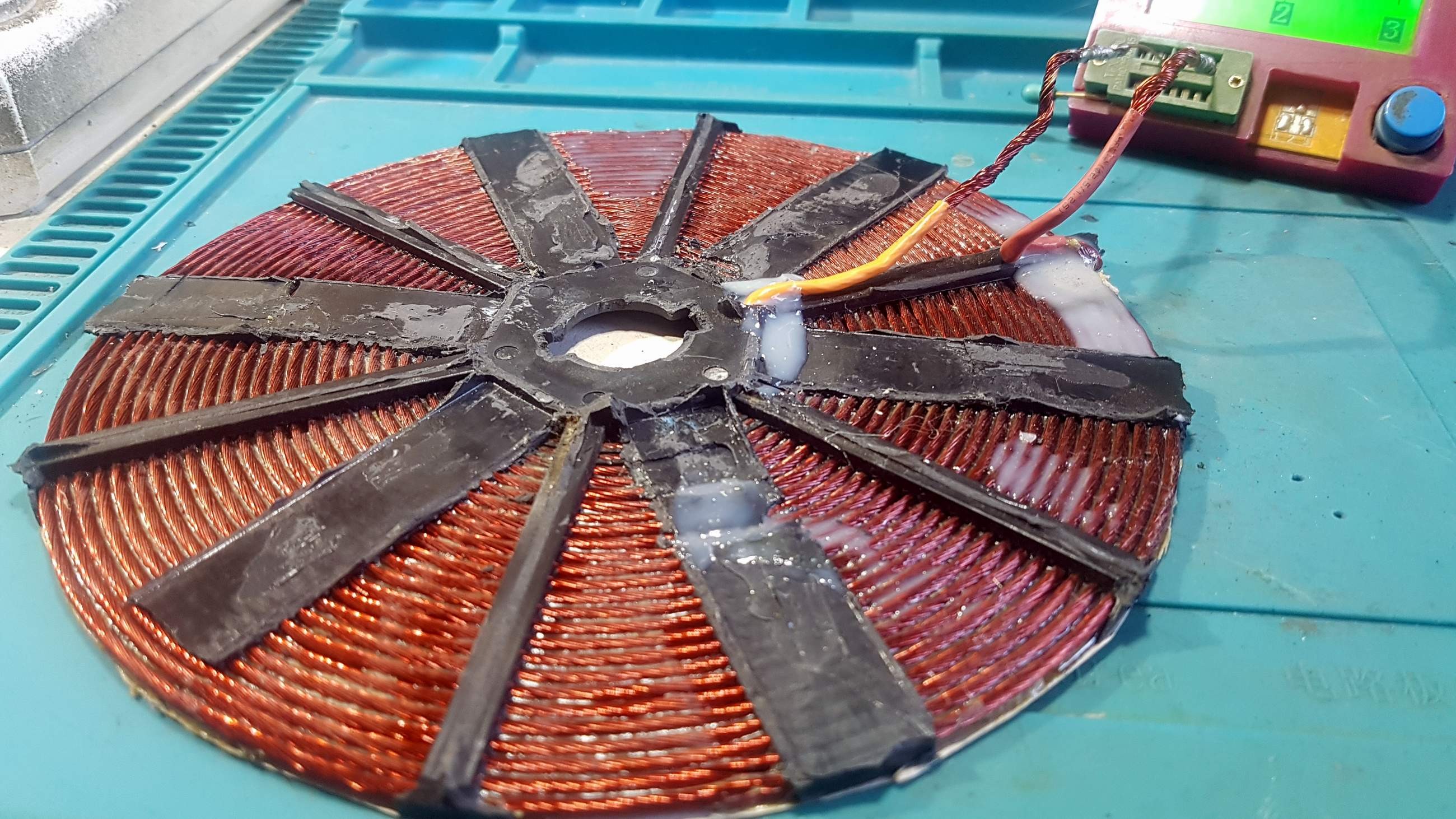

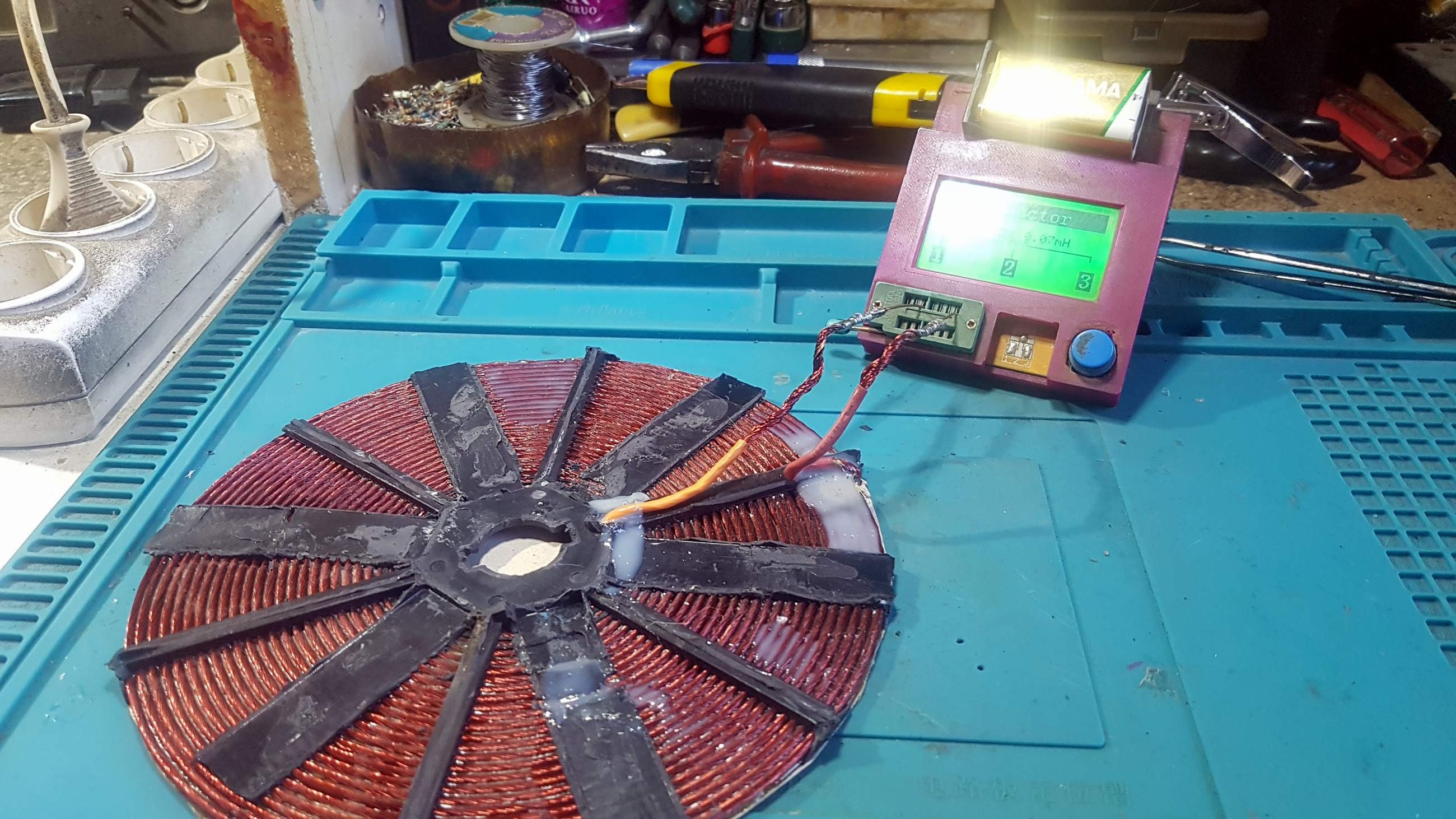

                          • Just for fun!
                            Really fast coil!
                            Had dozen scraped inductive cookers on the addict.

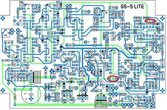

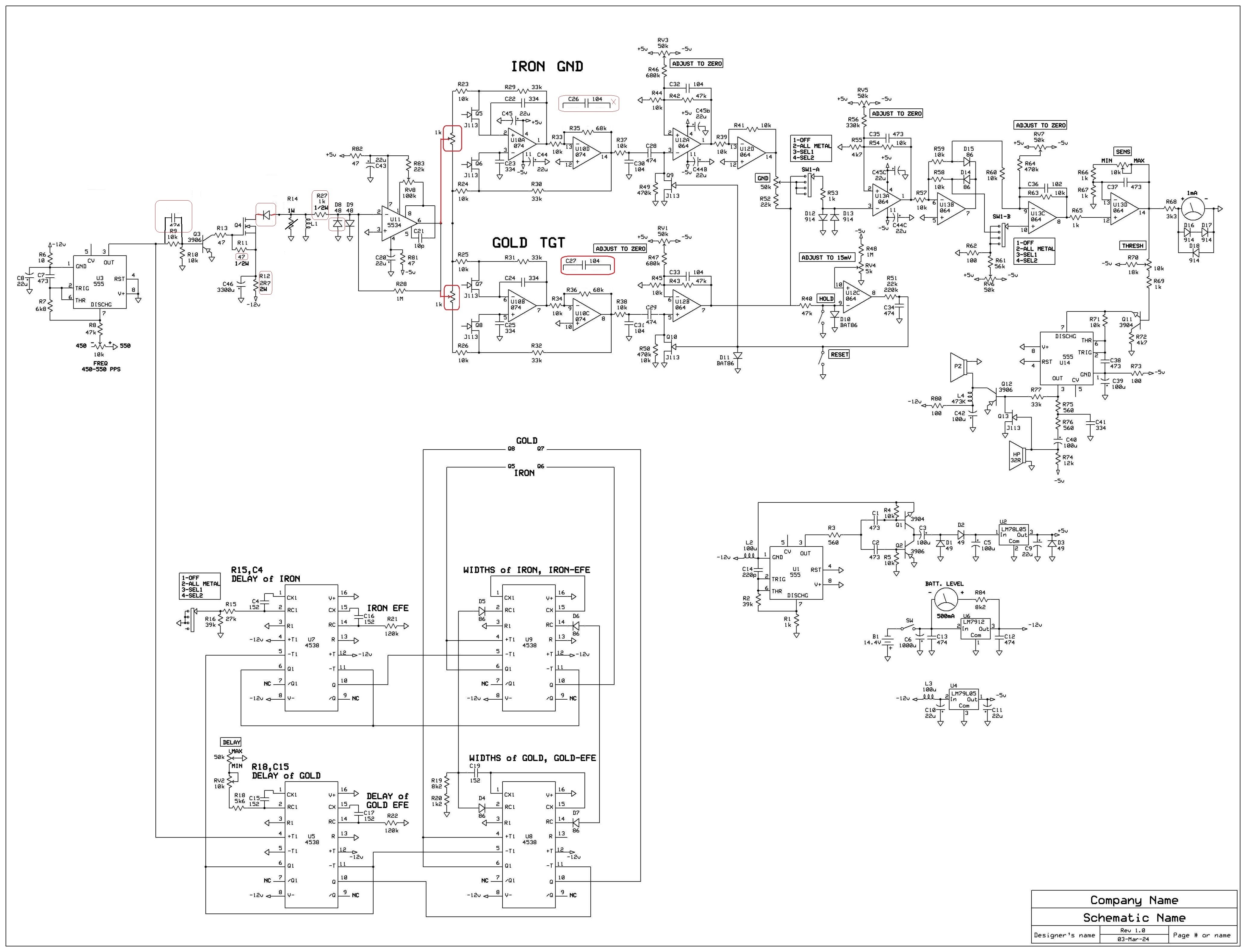

                            • Click image for larger version  Name:	GS5 B.lay6]EDUARDO_pageZA GEOTECH.jpg Views:	0 Size:	233.1 KB ID:	422274
                              Originally posted by eduardo1979 View Post
                              ​ Hello Eduardo, I want to ask you what value are the capacitors with the letter C enclosed in the photo, I could not see them in the schematic. Thanks.
                              • 100 n
