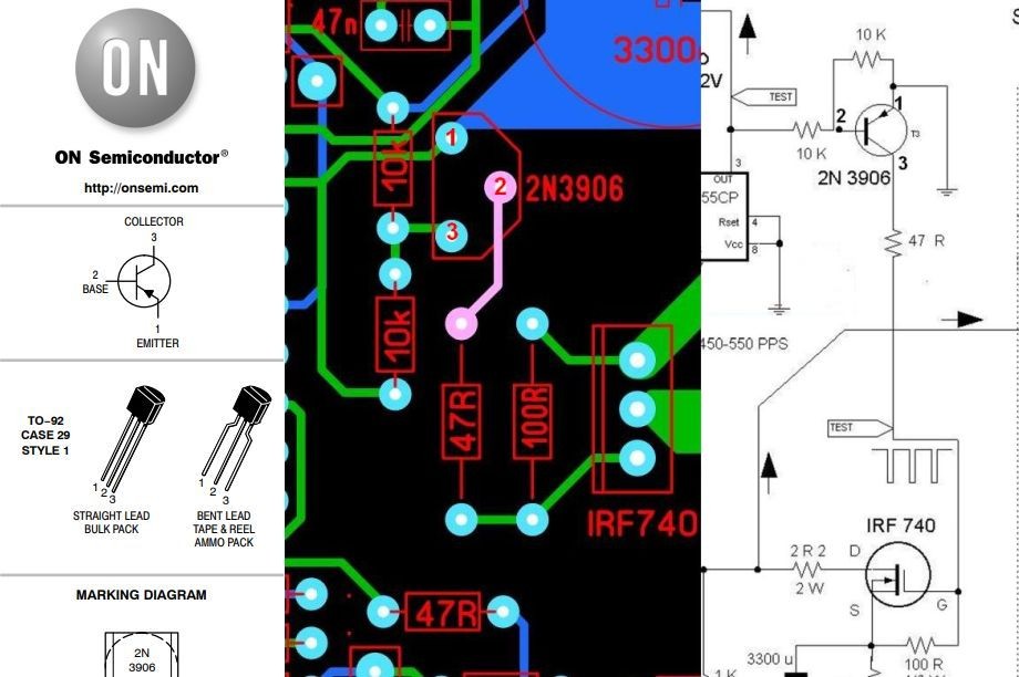

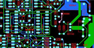

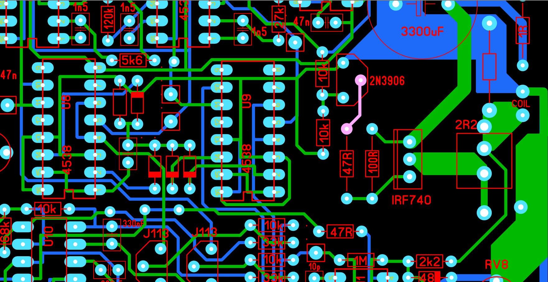

                • Ivconic Click image for larger version  Name:	2n3906.jpg Views:	0 Size:	388.7 KB ID:	421859
                  Did you connect this correctly? 2N3906 = 1E - 2B - 3C

                    • Originally posted by daluka View Post
                      Of course.
                      It is basic thing.
                      I don't make mistakes on that level...

                              Of course.
                              It is basic thing.
                              YES I DO !!!
                              • Ok, let me correct that and see what happens!
