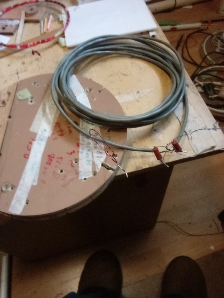

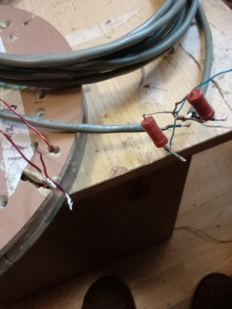

        these two coils emit the same power, similar turns with numbers 25 and 20 and wire diameter, 1 mm damping resistor or no damping resistor - there is not much difference.
        So capacitance of the coil has no effect on Tx emitted power .
        Probes across the coil directly...​​​​ = 20x10x7 = 1400 V?
        I am using 50us pulses, it is look you to, but I have 350 V on the coil and 50mA current.
        • I will make a coil with 0.5 mm wire diameter ....

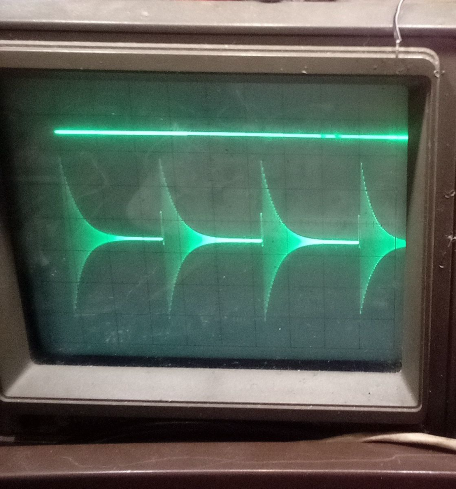

            No, it is somewhat above 200Vpp...
            When it was at 20V ; multiplier was at 1x.
            But the upper peak of the trace goes far out and above the oscilloscope display.
            This is brand new oscilloscope but somehow I don't manage with it well, not the first one I have though. Had dozen so far; but never really did anything on the PI subject with those.
            Usually all the previous PI diys that I made were pretty easy and straightforward and works nice from the very first switching ON, I didn't need to "scope" anything on them.
            But then again; all those PI diys were pretty simple designs. No sweat.
            Pulse Star II is indeed powerful and good "depths" PI detector, but a real sweetheart when we talk about diy, nothing to additionally worry or adjust, it works like a charm from the very first switching ON.
            So that's why those easy diys made me too lazy and I stayed pretty ignorant when we talk the details.
            So, consider me as absolute beginner in this!
            If I switch to 10x then the pulse is so narrow I can't see it right. Tried everything what could be done to get proper and "sane" oscillogram.
            Upper line is dimming as it goes far up, so it is not easy for me to figure out correct voltage.
            Either I do something wrong... either the pulse width is too short. Far bellow 50uS.

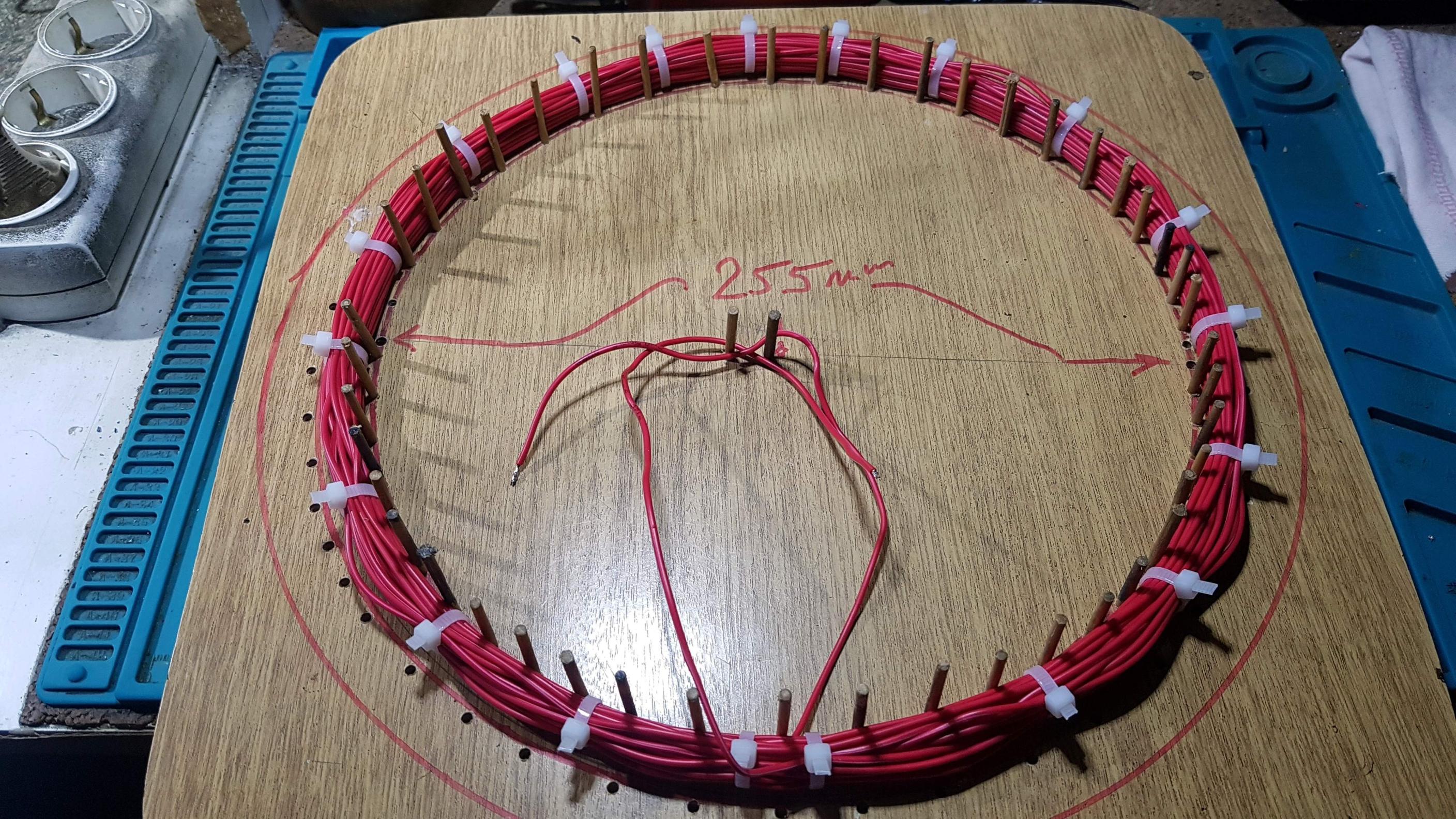

            • In the last half hour, I quickly wound another coil of PVC-insulated stranded wire.
              I had one piece lengthwise, I didn't want to cut, I rolled the whole piece.
              However... I didn't get anything good!
              No gain at "depths" in the air, worse stability of the detector and considering the size of the coil; poor ranges in the air on previously described "targets".
              Carl, of course, was right once again. This was a futile attempt.
              A smaller coil, no bigger than 20cm, actually suits me, because of the terrain I have here.
              And to achieve the greatest possible range with that coil on the mentioned targets.
              I made the one from the picture because I have such a plastic coil former.
              But it's all in vain. This is wrong.
              I will have to go back to the excellent PDF article by Jospeh and read it again (I have read it many times in the past, but as the years go by; I have less and less gray cells...)
              Click image for larger version  Name:	20240301_203757.jpg Views:	0 Size:	804.3 KB ID:	421018Click image for larger version  Name:	20240301_200521.jpg Views:	0 Size:	691.1 KB ID:	421019​​

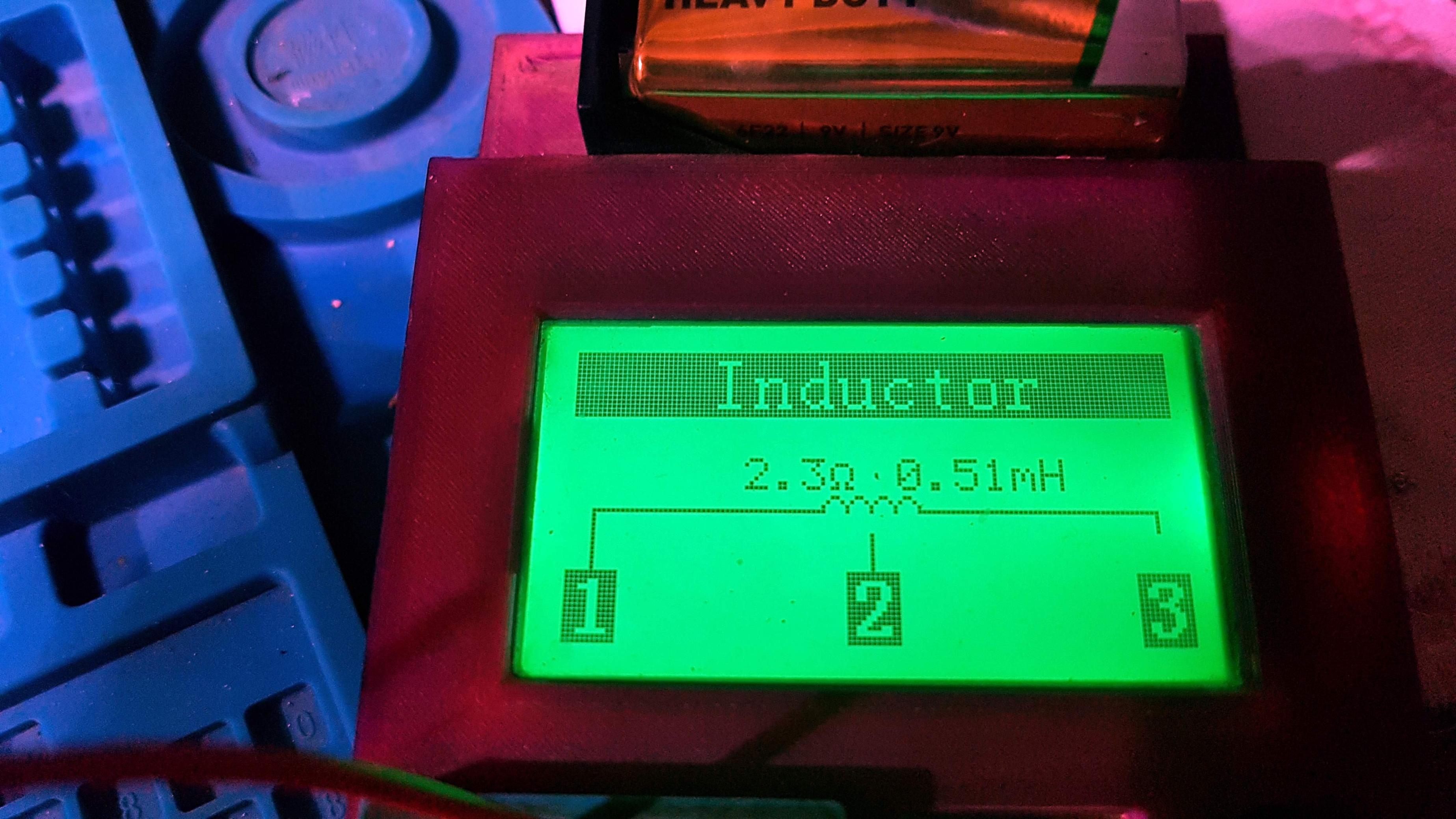

              • Comparison 1mm wire and 0.5 wire
                coil 25 turns, 22 cm diameter
                1 mm wire, 290 uH,0.7 Ohm, 0.45V
                0.5mm wire, 260 uH,1.3 Ohm, 0.42V
                very small difference in Tx power​
                how many turns has your red coil ?
                coil, 35T, 0.5 wire, 1.7Ohm, 0.58 uH, 0.35V
                • 50 us corresponds to 10 kHz (50x2 )
                  inductor impedance ,
                  510uH = 32.1536Ω​
                  290uH = 18.212Ω​​
                  coil 20 turns, wire 1mm, 30cm diameter, 0.8 Ohm, 510uH, 0.6V

                          So... 35 I think, lost count. It was random try, just to see what do I get from full length of that cable.
                          Of course it is useless try.
                          Carl pointed one thing and I will follow that in next attempts, because it correlates to what I really expect from this detector; it is smaller diameter coil.
                          Probably less than or close to 20cm diam.
                          Will try to find proper wire for 0.3mH and 3.5 ohms resistance for such coil.
                          End goal is to detect mentioned coins at 15-25cm in soil... if possible.
                          With such smaller coil. I don't need anything better then that.
                          Of course if that is possible.

                            • my coil, 35T, wire 0.5, 1.7 ohms, 0.58 uH, 0.35 V = your coil has similar inductance but much higher resistance, what is the diameter of your wire, is it copper wire?

                                I don't know why you insist on that coil, it turned out to be bad in working with the detector.
