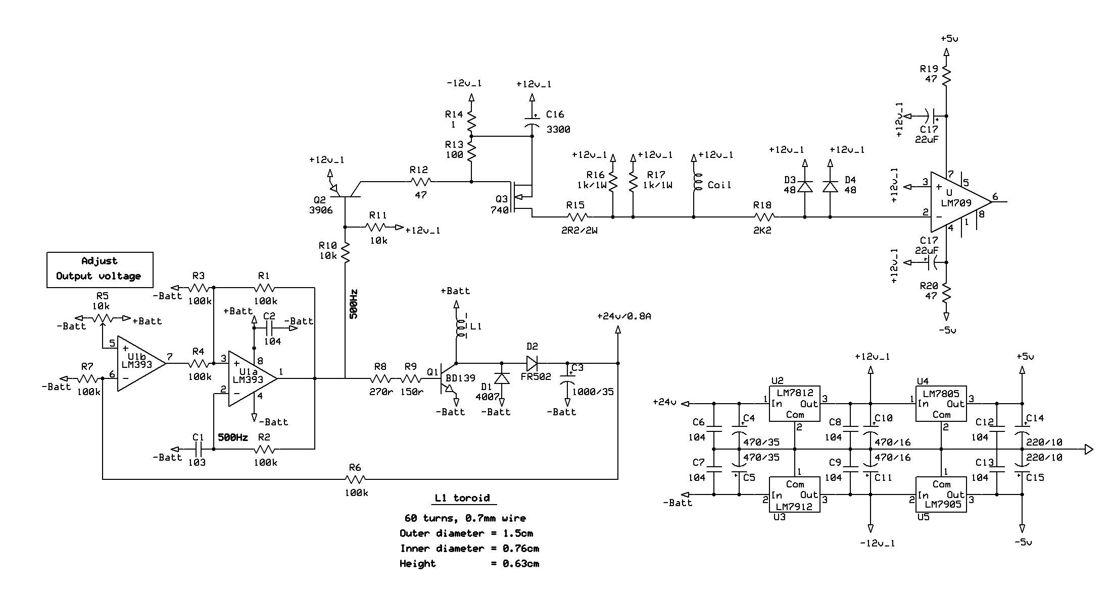

          • I came across to this interesting idea today.
            It should be pretty much "synchronized" and shouldn't involve any significant noise amount from power inverter to the rest of circuitry.
            Now, the rest of GS circuitry must be adapted to this solution.
            Real art would be most proper ground plane redistribution on future pcb.
            Now... i am under real doubts and also very tempted to try to use "virtual ground" formed at U2-U5 stage as main pcb ground plane, instead as it was done at original GS4.
            I could use others opinion on this.
            This is more interesting to me than all the rests of circuitry

              Ivconic, I wonder if I could run this scheme with a duty cycle of 10% alrrededor, as befits the TX pulse GS4.
              Jose
                Jose
                Yes good question.
                Circuit is academic, shown mainly as idea, so we can talk and elaborate it more as approach.
                Main problem, relating to noise at simpler PI designs, that i noticed so far; usually are discrepancy and crossing between main TX oscillator and power inverters or charge pumps, so as power&ground planes redistribution on design itself (pcb and parts).
                So idea is to run TX on basic frequency but also to use same one for power inverter, no dividing, no multiplying.
                The simpler power inverter - the better.
                I considered use of some conventional switch, but all those are presenting huge source of noise, though some of those are frequently used in such PI designs.
                This mod i am suggesting is just a principle which may be improved further.
                GS4 is problematic because we have several different voltages to carry about. All those to come from same source. All those to synchronize. Problem.
                So i would rather pay attention to that aspect and less to else.
                Also i would like to avoid solutions like mc34063, 7660 and similar, because those are splendid noise generators on the first place

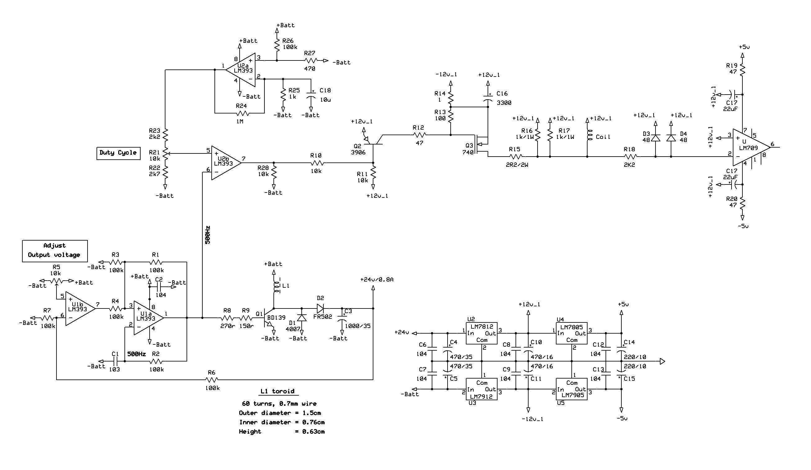

                • Jose how about this:
                  • I like the idea of being able to control the TX pulse width independent of the source, while both synchronized.
                    I think the next step to consider is the power consumption.
                    There are other possibilities that can be condiderar, for example if it is necessary to regulate the 12 volts, or 24 V to TX, or fed directly from the battery, as does the GS5, according to the published schedule.
                    O also feed the TX stage 14.4 or 16 volts with inverter self-regulated in order to get something more sensitivity.
                    Battery and source circuits could be sepados. As you say it is good to reduce the noise as much as possible.
                    The possibilities are many, I think the experts can give a better review than me.
                    Jose
