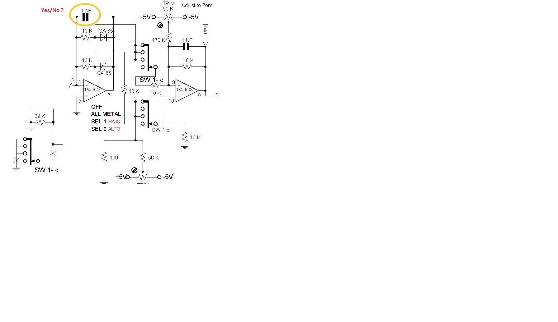

          The selector is the same as those published in the schemes of this forum. Exept the SELEC 2 mode was changed.
          The modified scheme was published on page # 12 post # 284 as "GS4 Modo Alto.JPG ".
          In this way, contrary to SEL1, low conduction objects as foil, gold, caps bottles, etc. are removed. and high conduction is detected. This mode is useful when trying to find coins and reject the bottle caps. Everything depends on the setting of the detector and the metal compocision.

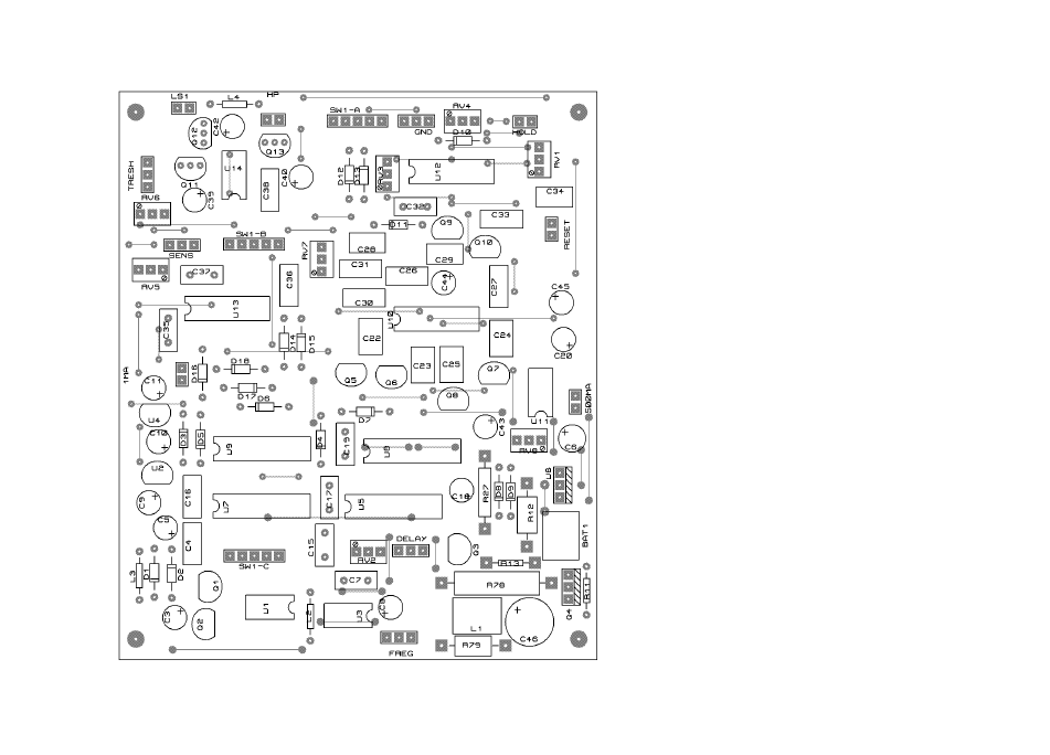

          if you can put here correct pcb and... for this detector

              Mohandes not I have the right PCB, except that you and conece. Other PCB's in the Post No. 286 as GOLSCAN-IV YENİ.rar. No if it is correct that not realized.

                If anyone cares to experiment, here's one mods for tall drivers I'm rehearsing in, SEL2 mode.
                Jose[ATTACH]27346[/ATTACH]

                Thank you for posting the GS4 Modo Alto scheme. I would like to know if you tried the 1nF capacitor in feedback between pin 6 to pin 7 of IC3/U13:B ? See this post #44 here : http://www.geotech1.com/forums/showt...103#post127103
                I have tried to modify your schematic. Like this : Click image for larger version
Name:	Modo Alto with 1nF.jpg

                • Originally posted by greylourie View Post
                  Hello Jose
                  I have tried to modify your schematic. Like this : [ATTACH]27638[/ATTACH]
                  grey.
                  Greylourie, I installed a 10 nf capacitor between pins 6 and 7, he did not know its value.
                  I think the value of 1 nf should be taken as indicated Alexismex.
                  Thanks for watching.
                  happy Holidays
                  José

                    • Jose what pcb you make i have one pcb for gold scan IV but have some SMD resistors??do you have pcb without smd??
                      • I was looking for the SMT version. I see a picture but not the sprint files...

                              • Hello Seadoggy
                                I make the PCB contained in Post No. 270 Pag 11.
                                As I said at that time, I had many problems, apparently due to faulty PCB design.
                                Please read previous posts where the problems and possible solutions.
                                Under the direction of the link.
