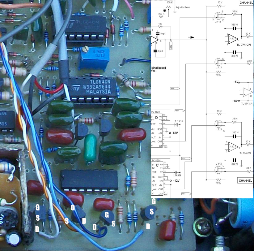

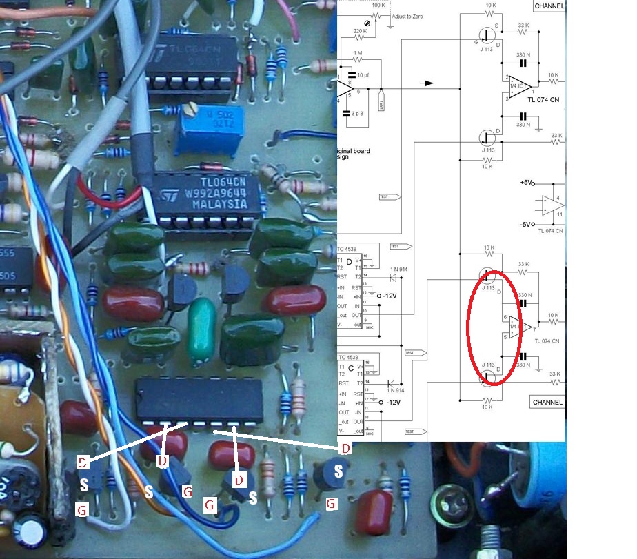

      I suspect your goldscan 4 in this photo.
      between the scheme here and your goldscan pcb array j113 s different connection.
      Drain pins on the diagram are connected to the integrated. but drain on the pcb is shelf. is the correct connection?

        Your attachment seems to be missing, but Source & Drain are interchangeable on J113
        • [QUOTE = 6666; 260390] Your attachment seems to be missing, but Source & Drain are interchangeable on J113 [/ QUOTE]
          • The data sheet says
            "J111 / J112 / J113 / MMBFJ111 / MMBFJ112 / MMBFJ113N-Channel SwitchFeatures• This device is designed for low level analog switching, sample and hold circuits and chopper stabilized amplifiers.• Sourced from process 51• Source & Drain are interchangeable"
            • some data sheets say nothing
              • Because I don't speak English. I guess what I mean is not understood.
                Is it right to my damask. or pcb that has been lined up correctly. which layout works

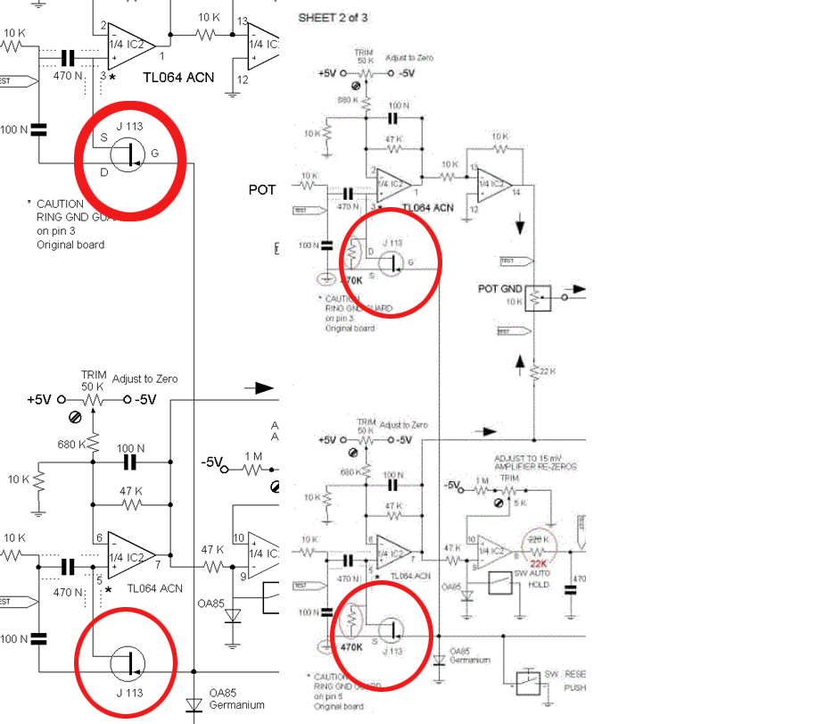

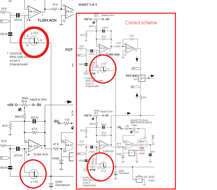

                    • hello jose. I'd like to know one more thing. Alex has drawn both schemes. which one is right?
                      • Alex's original scheme does not include the GND connection of the fet.
                        Two 470K resistors were added on both channels.
                        A 220K resistor was replaced by 22K.
                        Use the scheme indicated below, it is the one that works on my GS4.Click image for larger version
Name:	GS4 Correct.PNG
