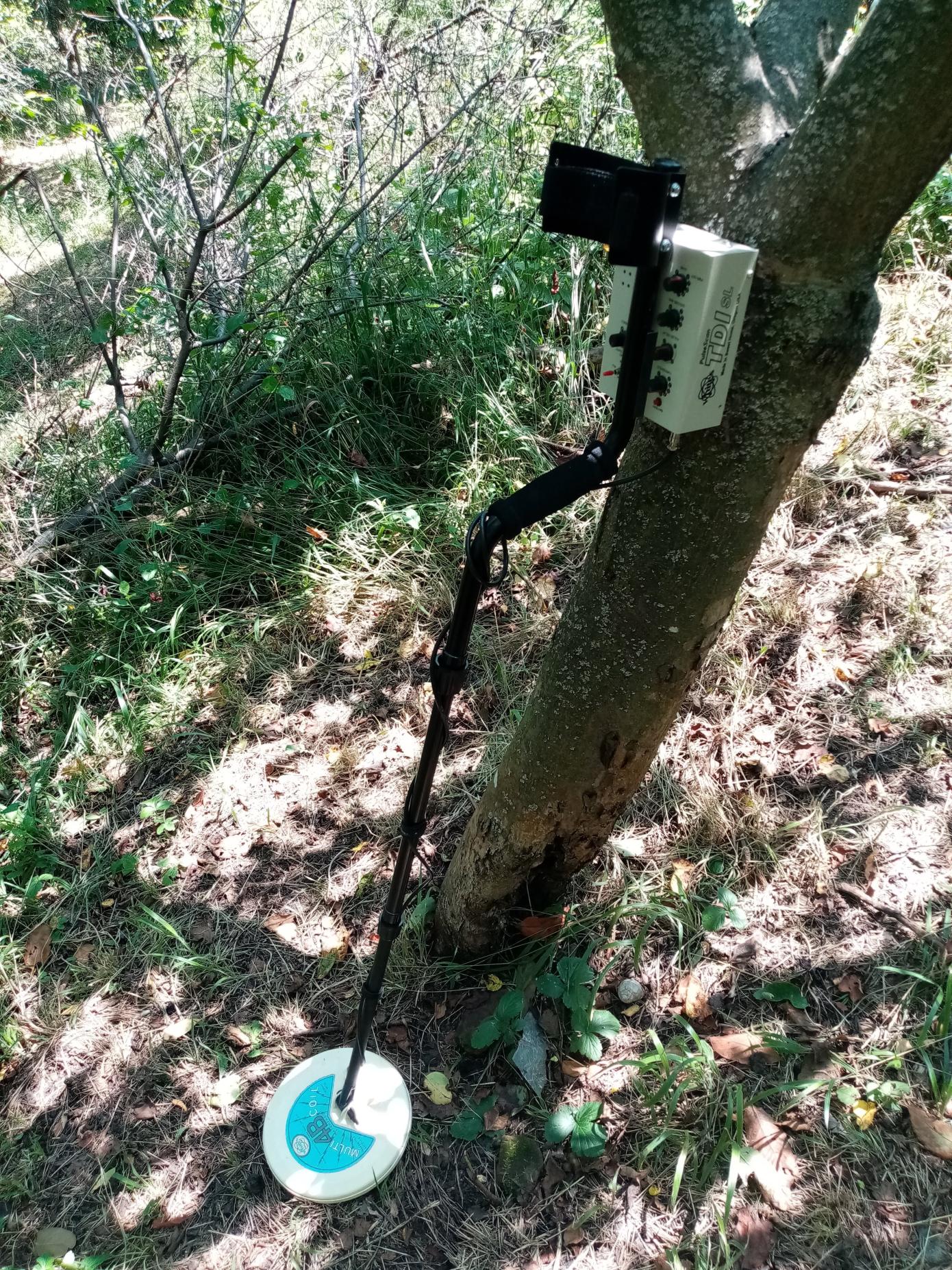

                            I've decided to build it
                            do you think it's worth doing?​
                            • 8
                              Originally posted by daniel. z View Post
                              That's great, good luck.
                              I think it's worth it, but only in places where there are a lot of minerals in the ground, so it's not for every day. For certain places it is ok. Not too deep I did an 8 inch coil. And I have the original coil of gs 5. The Sl is perfectly silent at maximum sensitivity and can find coins under nails and debris where all possible vlf devices can absolutely not match it.Otherwise the proto TDI scheme is completely correct as put by Altra! TDI or Proto TDI is a bit deeper but also more noisy!
                                8
                                So, does the TDI Proto design work perfectly? Do you have the SL design yourself?
                                I wanted to buy a TDI SL and start reverse engineering the circuit from it, but unfortunately I couldn't find one.
