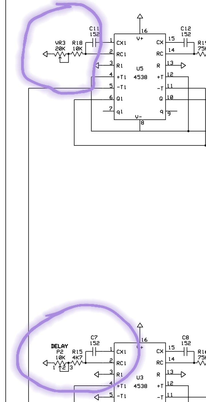

Please forgive my boldness. Is the schematic for this GS5lite circuit truly correct—should we go ahead and build it? After all, we are going to be investing both time and money.Originally posted by Emersonpaz View PostI built this unit specifically for use with the commercial 11-inch Commander coil, which has an inductance of 300µH and a resistance of 0.4 ohms; since the coil resistance is very low, I used a 2.2-ohm 10W resistor in parallel with the coil to better dissipate the generated heat. The detector works well with any coil around 300µH; my friend cristiano.sar tested it with a spider coil and the Minepulse Plus coil, and both performed very well.

The schematic is correct, the only thing you must pay attention is a small disconnection that exists on one of the PCB tracks (that has already been said before in older posts). As this is a full analog design, the quality and precision of the components is also very important.

Is this timing correct, or does the timing actually differ when assembling the board using the exact components shown in the schematic?Originally posted by Emersonpaz View PostI built this unit specifically for use with the commercial 11-inch Commander coil, which has an inductance of 300µH and a resistance of 0.4 ohms; since the coil resistance is very low, I used a 2.2-ohm 10W resistor in parallel with the coil to better dissipate the generated heat. The detector works well with any coil around 300µH; my friend cristiano.sar tested it with a spider coil and the Minepulse Plus coil, and both performed very well.1 Photo

the question isn't quite phrased correctly. It should be: "Should the components of the circuit be adjusted so that the timing matches the displayed value?" The answer is "Yes."
Hello there, my dear—how are you? Yes, that's right; it will still work if there’s a mismatch, but the discrimination won't function properly, correct?Originally posted by GeoMax View Post

I have identified these two timing settings. Which one is designed to be configured on the device's control panel? Also, please advise on which one is more important and should be set on the panel.Originally posted by GeoMax View Post
YesAttached Files
Both adjustments are very important. Potentiometer P2 (DELAY) is mounted on the front panel and is used to adjust the initial delay of the main sample, while VR3 is a trimmer located on the PCB used to adjust the remaining synchronization timings, in accordance with the diagram I published some time ago.Originally posted by Mehranfar View Post
