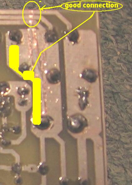

                  • Hi all,
                    I build the PIM-2 and i use the ver. 05 hex but no sound and no detected the metal. The lcd is working. What the problem?
                    • Originally posted by Ropcsika View Post
                      I build the PIM-2 . What the problem?
                      Hi Ropcsika
                      -may be Bad coil!
                      --Test all the components and value in its place.
                      -Put a clear picture of the top and bottom.
                      best time
                      j.

                        Hi jap,
                        The coil 3,5 ohm and 820 uH.
                        A képet a Képfeltöltés.hu tárolja. http://www.kepfeltoltes.hu
                        • Hi Ropcsika
                          -good work
                          - try coil ~500uh.
                          -test R6,R5, R16,D12,,,=SHORT.
                          -Test valu C17
                          best time
                          j.Click image for larger version

                            Thanx jap,
                            detected but no sound....
                            • Thanx jap
                              My PIM-2 work fine, it was soldering defect but a little unstable...why?
                                Thanx jap
                                Hi Ropcsika
                                -Read reply #197
                                -for stable R5=680/2~3W
                                - for sound test T2,R8,R9.
                                best time
                                j.
