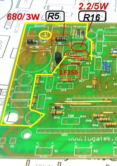

    Now, I have not any the signal, when I test metals.
    this problem is reason of ( the resistance R16 was moving )
    I weld the résistance R16 very well.
    But already I have not any signal when I do the test.

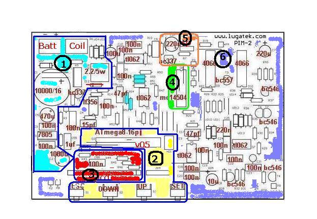

      Frequent questions for PIM-2ver05 and easy board was divided into parts as schematic:-
      1 - part of the coil and power.
      2 - part programmed controller[atmega] + key sw1...4
      3 - part LCD and control.
      4 - part match between the signals used by atmega8.
      5 - part audio{SP} out.
      6 - part of a normal delta pulse .
      I've put all the notes .[*]-all dEMO HEX =~ver05 used only in ver01,02,03,04,05 pcb.
      -V06 used only with v06 pcb.
      -atmega8 pi = atmega8 pu = atmega8a pu [any of ver will work]
      -start test with coil 40cm , 3~4 ohm,400~500uh.
      -Must use keyboard sw1~4.
      -D12 if not =short
      -all value of R Can be modified to obtain the best results.
      -R3 15 k to 22 k [V05]
      -R4 10 k to 12 k
      -R51,53,54,55 1% [V02,,5]
      -R16=2.2/5w
      -C are All worked and change values for improvement.
      -all C 100n is mk type.
      -There are important components in the function, such as D4,D3,T9,VD3,4 ,R6,VD7.
      -Most problems of choose different types of LCD and followed connection method.
      -There are important components in the function, such as part4***. .
      -Responsible for higher sound both T2,R9,c27.
      -Responsible for the delay in the start , C2,C3,C5,c6.
      -The difference in results is due to the difference in components and quality of connections of the pcb.
      best time

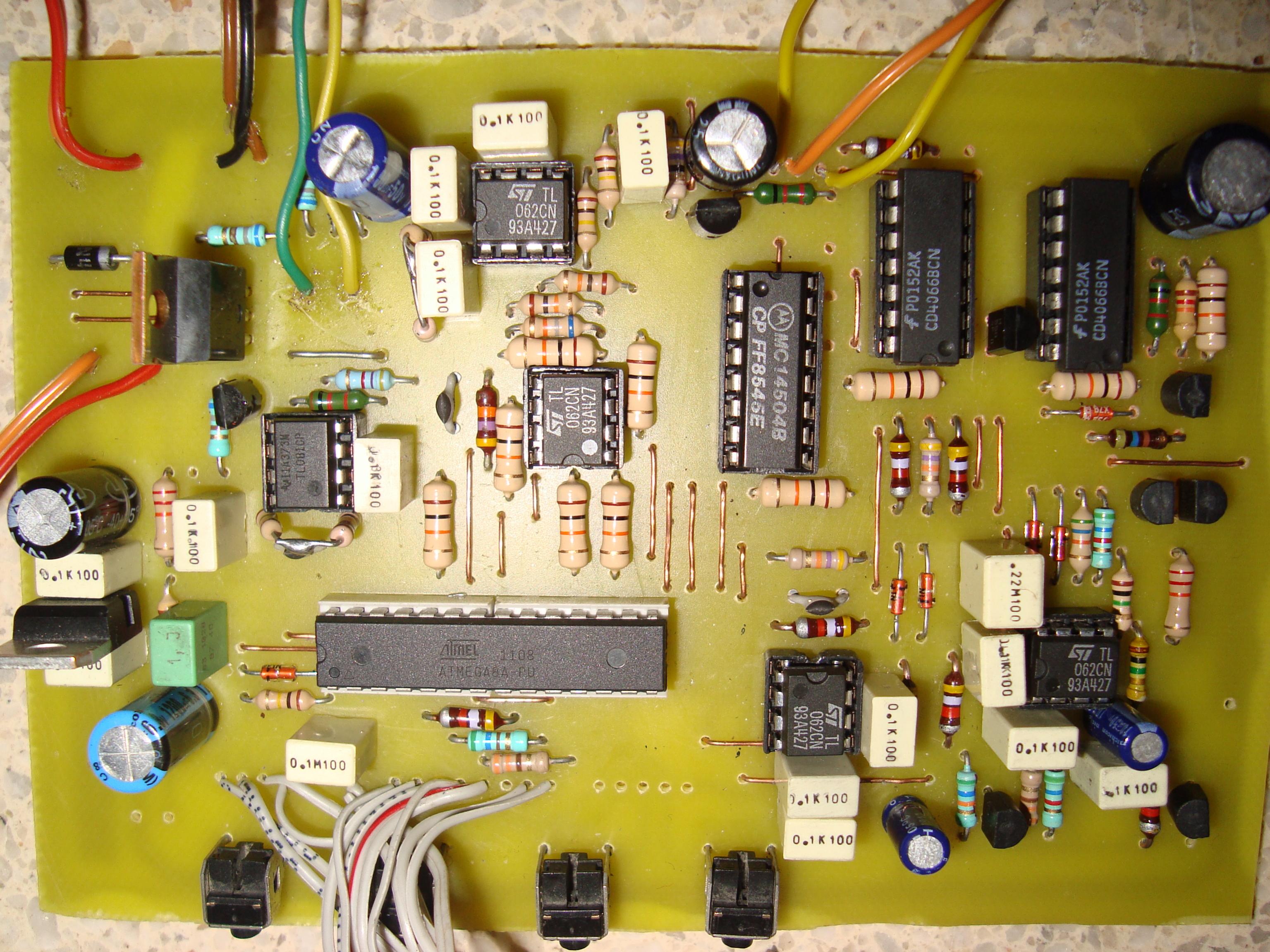

      • thank you very much Jap
        look to my project
ID:	334690Click image for larger version
ID:	334691Click image for larger version

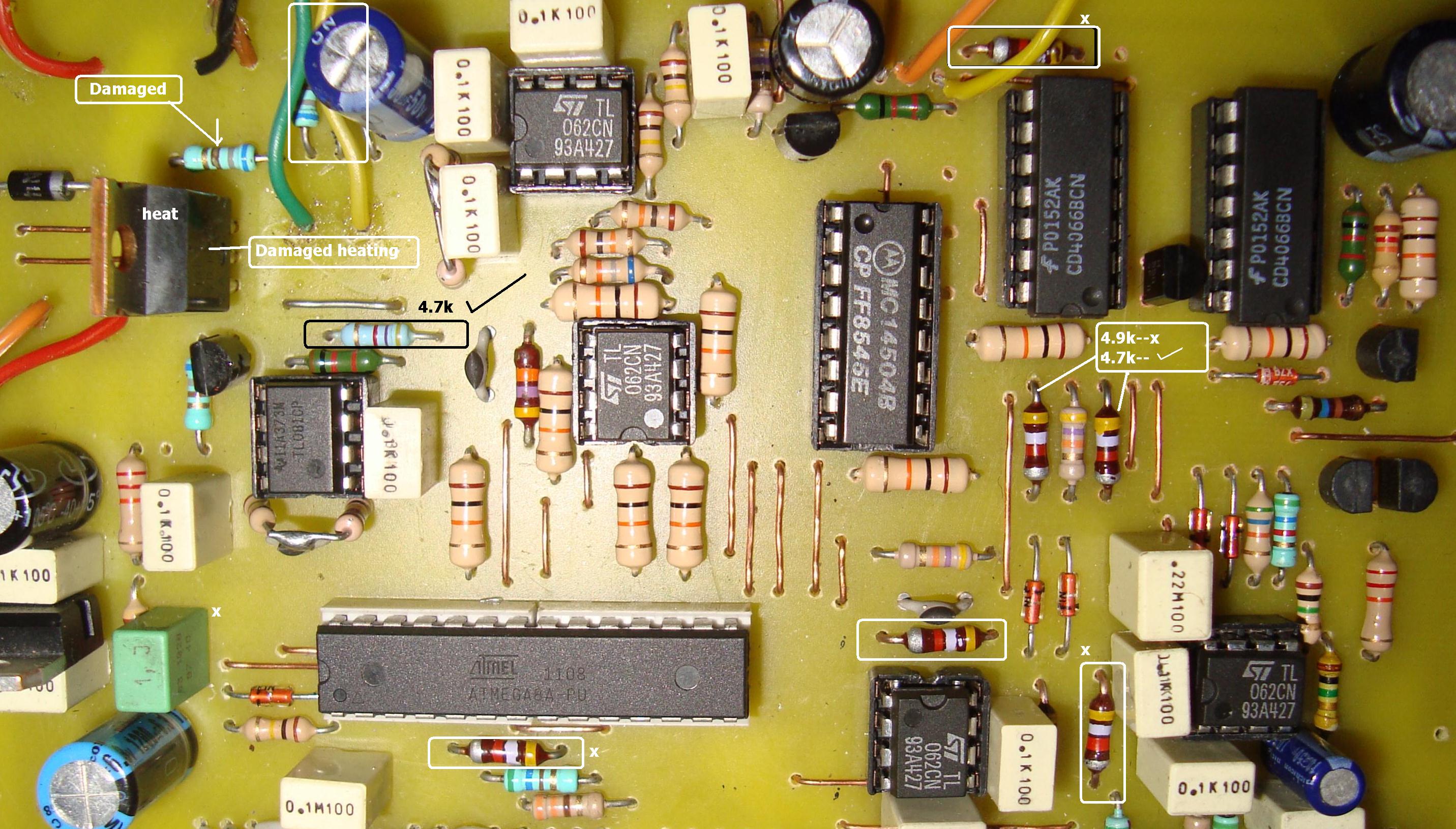

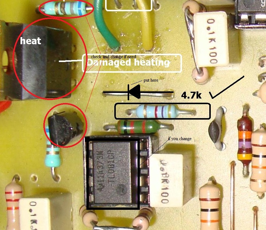

          -Nice work
          -change all R=4.7K.
          -change all R=680 OHM.
          -Test & change IRF740,TLO81,VD3,VD4,C2=1000UF/16V,C55.
          best time
          j.
          • Hi Jap
            I test all the R, all are well
            all R=4.7k and all R=680 ohm are well ( I do not change it )
            I change IRF740,TLO81,C2=1000UF/16V
            I have already the same problem

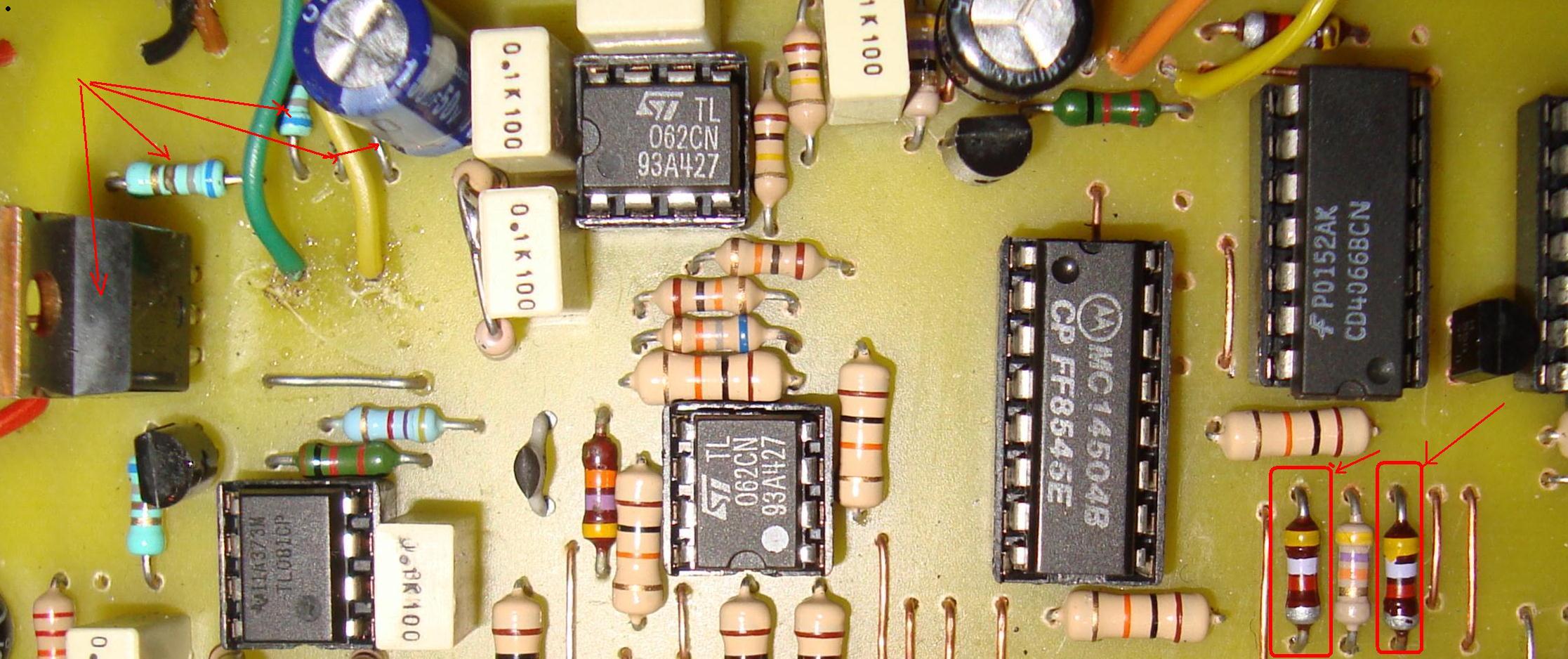

            • OK,,,SeeClick image for larger version
              j.
              • ok Jap, I understand
                you want to say that the quality of R=4.7 k and 680 is bad
                and IRF740 hot.
                So I will do all what you requested from me
                thanks
                • ok jap check irf 740 bc the 337 and put a diode byv 28Click image for larger version

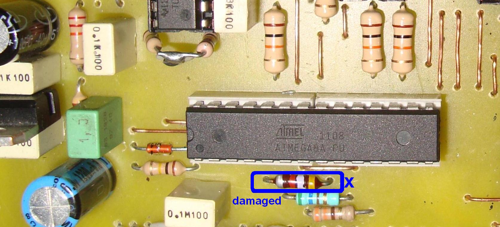

                  • thank you Jap and oros27

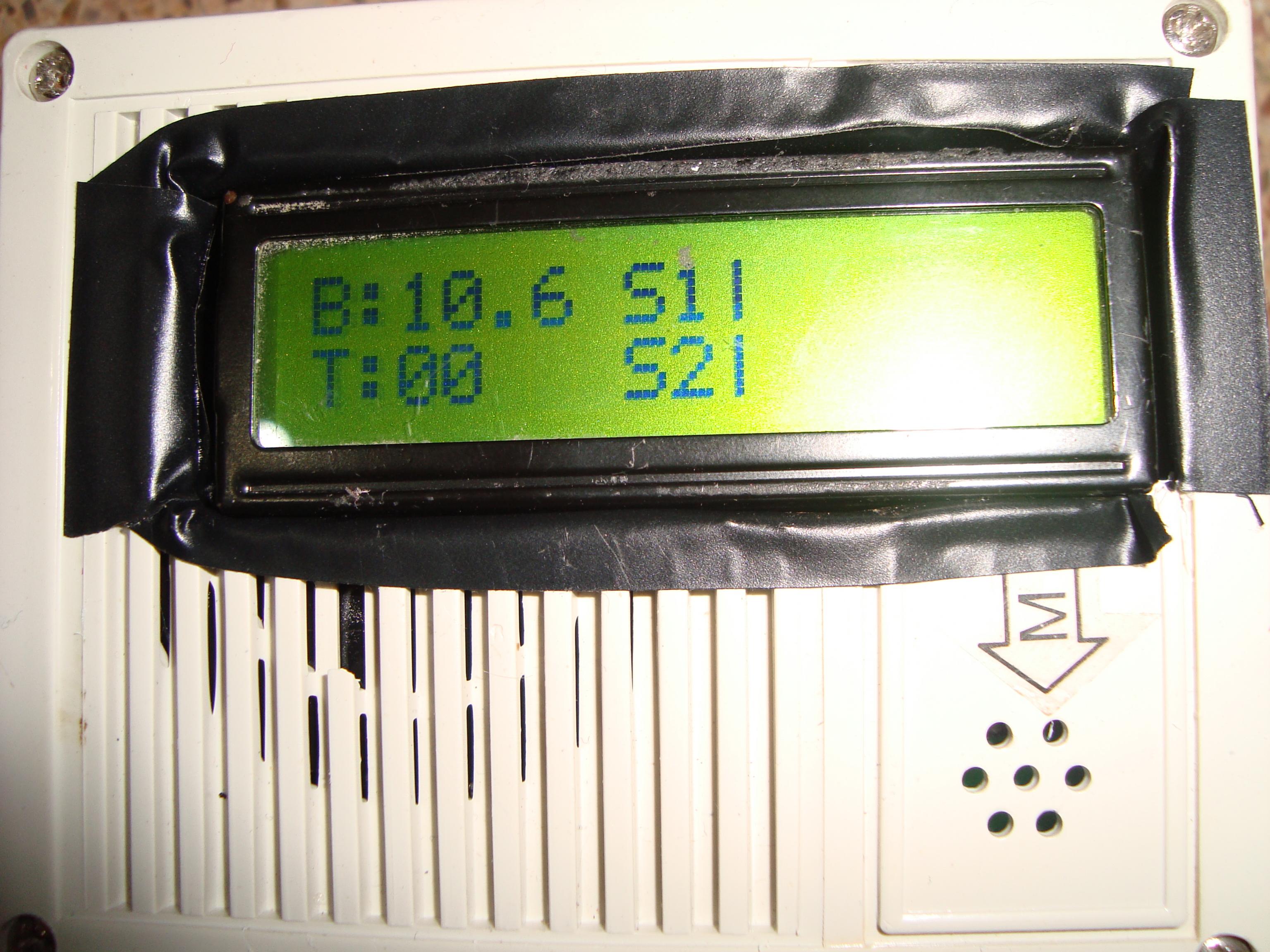

                    I found the error :
                    the resistor R44 was damaged, I changed it.
                    So I see the signal of the test.
                    But always, I have not got a good result (long depth), I think that my coil is not good.
                    thanksClick image for larger version
