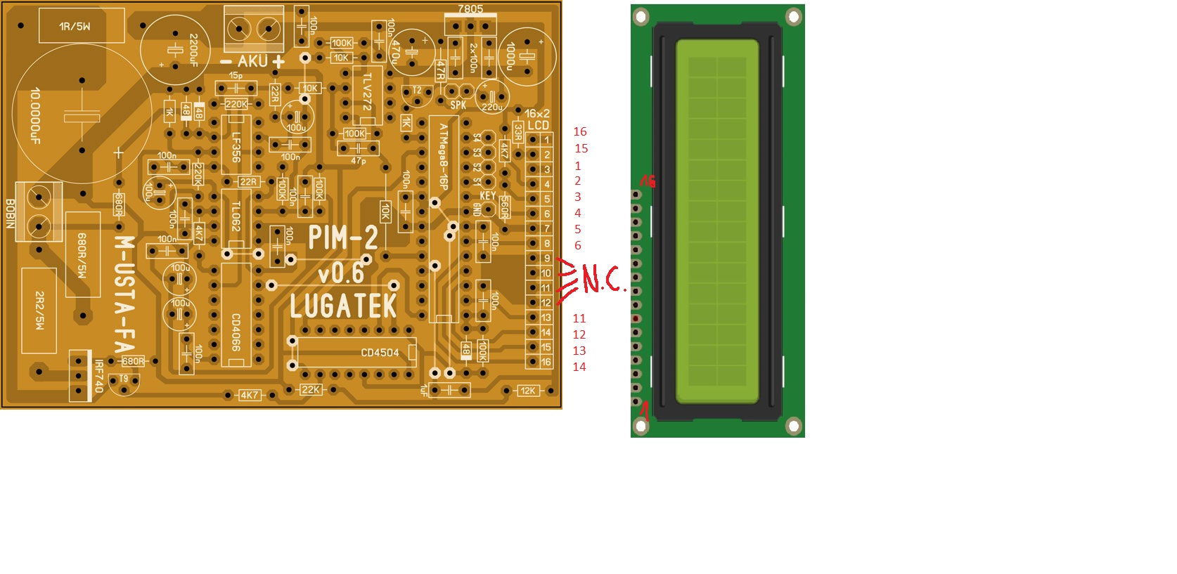

  • Mustafa wrote about connection of PCB to LCD
    check connection according to below maybe lcd burned if you made wrong connection.
    http://forum.lugatek.com/index.php/topic,61.1125.html at the bottom of page
    1 = LED (-)
    2 = LED (+)
    3 = VDD_GND (-V)
    4 = VCC (+V)
    5 = VEE (KONTRAST)
    6 = RS
    7 = RW
    8 = EN
    9 = DB0
    10 = DB1
    11 = DB2
    12 = DB3
    13 = DB4
    14 = DB5
    15 = DB6
    16 = DB7

      The pin numbers shown above refer to the connector on the PIM-2 PCB. All LCDs have pin 15 = LED(-), and pin 16 = LED(+). The pin numbers then run from 1 to 14 (instead of pin 3 to 16).
        i never got answer from user mustafa, but some people who work with him at turkish forum
        you can buy pre-programmed µcontroller from them, latest firmware is v10
        detector is not bad, desgin ist easy and powerfull if you look the parts
        also it are not many parts, pcb is small and easy to build
        so the last things i have to to is debugging my version so that i works with lcd, the supply part is ok but i suppose the data lines are changed betwenn my board layout and the latest firmware
        maybe i will look at the other concept pcb (the bigger one) and copare how the lcd is connected there

        • solved problems yesterday before shooting my first rockets
          silkscreen on pcb was a bit confusing i thought i can conect like the numbers on the pin header from 1-16 direct to lcd from 1-16
          but i found solution as i looked on schematic after info from samii , first connecting the data lines, then power supply, led supply and lcd contrast
          detectors works

                          how to connect pim2 mustafa pcb to 1602 lcd
                            [ATTACH]34809[/ATTACH]

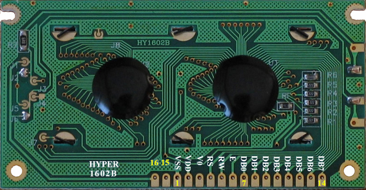

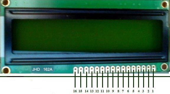

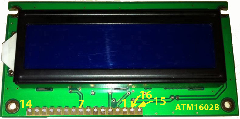

                            Dear bernte_one
                            Thanks for 'how to connect pim2 mustafa pcb to 1602 lcd'.
                            This should help some people to realize that the pin numbering on the 'Header' of the Delta Pulse 2 PCB is somewhat DIFFERENT from that on the 'Header' of the PIM-2 PCB, whether it is the version 05 or 06
                            of the latter (large or smaller PCB respectively).
                            However, I see that the main problem is NOT the numbering of the LCD pin connections on the 'Header' on the PCB boards, but rather the MANY different PINOUT sequences on the different LCD models from
                            different manufacturing companies. I might also add that any competent electronics technician, whether professional OR amateur, can easily determine the most likely pin connections, such as 'ground', 'positive'
                            rail, etc. on the PCB board 'Header' by carefully examining the schematic drawing for either the Delta Pulse 2 or for the PIM-2.
                            So, what I have done here, is that I have uploaded some photos that show examples of some of the more common PINOUTS for LCD models from various manufacturers.
                            The PINOUT sequences (numbers) are shown in yellow on the three representative LCD examples (note that the numbering always begins with #1 which will always be the Vss (GND -) pin on the LCD itself.
                            I hope this will help some people trying to connect their various LCD models to the 'Header' on the PCB of either their Delta Pulse 2 or their PIM-2 metal detector board.
                            Regards.
                            Ciao,
                            Speedy_G
ID:	344409Click image for larger version
ID:	344407Click image for larger version

                              • [QUOTE=bernte_one;212141]most diy projects last years are based on 1602 hd44780 lcd, because the are available in big quantities and its also an industrial standard
                                Dear bernte_one
                                As I expected you missed the whole point of my post regarding the various PINOUT possibilities that I referred to which was due mainly to the different manufacturers.
                                The photos of those LCD models that I posted as examples are ALL HD44780-compatible. The slightly different PINOUTS available on many of the LCD models does NOT always imply that those models are not HD44780-compatible.
                                All I'm saying is that those people building the Delta Pulse 2 or the PIM-2 pulse-induction metal detectors should be aware of the possible differences in PINOUTS on LCD models that might not be what they expect them to be (e.g. they may not be in the SAME order from #1 to #16). However, I want to make a note here that, in all the LCD HD44780-compatible versions I have come across, they all begin with #1 (as Vss/GND-) and and end with #16 (LED-/cathode).
                                Ciao
                                Speedy_G
