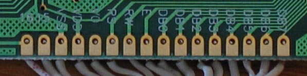

              • #67
                What kind of screen lcd to you??
                • #68
                  Hello
                  Hello how are you I want to inquire about the type of wire used and the LCD screen type ..... Please help me to you
                  • #69
                    You can use any standard 2x16 characters LCD, just look at the pin configuration on lcd.
                    I used this 1602-04 so the pins maching to PIM-2 (except backlight).
