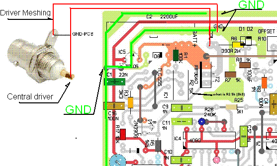

          I have one problem.
          When I touch coil coaxial wire or BNC connector to PCB it produces beep.
          I tried reversing polarity of coil connection to PCB and it goes away so does the sensitivity... goes to 2-3 cm max
          Coil is not shielded and also acts with (wet ?) grass or ground.
          Coil is 20 cm 21 turns.
          Made coil with 25 turns 20 cm diameter. Same happens...
          It is not problem when you get used to it.
          Any solution ?
          • Check that the BNC connector housing, is connected to the GND of the PCB.
            Use coaxial cable between the PCB and the BNC connector, or stranded wire.
            21 laps for 20 cm coil, should work well, see my post No. 216.

            • In this case my outer part of BNC is not connected to ground
              other one is connected to ground...
              I will try connecting with coaxial cable
              if I connect both to GND there is no signal ?
              I tried reversing polarity of coil connection and outer part is on gnd I get much lower sensitivity to metal

                Sdesic
                Do not understand the question. The outside of the BNC, should be grounded or GND, or to negative battery.
                Look closely at the PCB.
                • That solves problem with coil connector and cable sensitivity to touching by hand and ground.
                  BUT it lowers sensitivity, I have now up to 5 cm detection of 1 EURO.
                  I have tried 9V battery and it is working far better than on 12V batteries with same coil.
                  With 9 V I can use delay pot, not only at max resistance.

                      If you connect BNC PCB as drawing, fine.
                      In green is the GND path, which is the same as the negative pole of the battery.
                      After the BNC coaxial cable to the coil, should continue in the same way.
                      If the problem persists, try adjusting R2 for best performance, with 12 volt battery.Click image for larger version

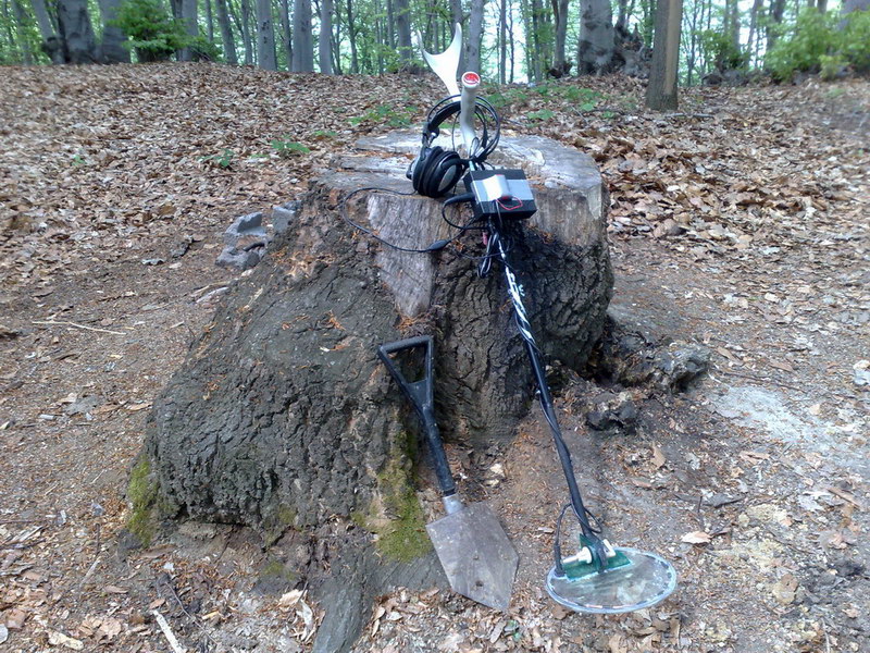

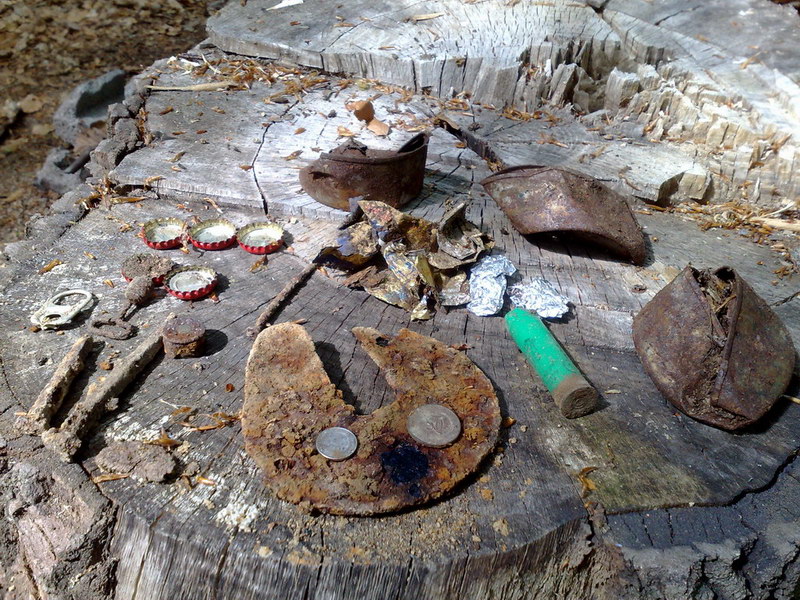

                              I have done some field testing - still having ground detection on few occasions.
                              Maybe it is my coil moving inside of coil casing.

                              Today it was working with 9V battery
                              and this is my finds ... 2,5 hours hunting in one place - woods
                              fist coins and first pull tabs
