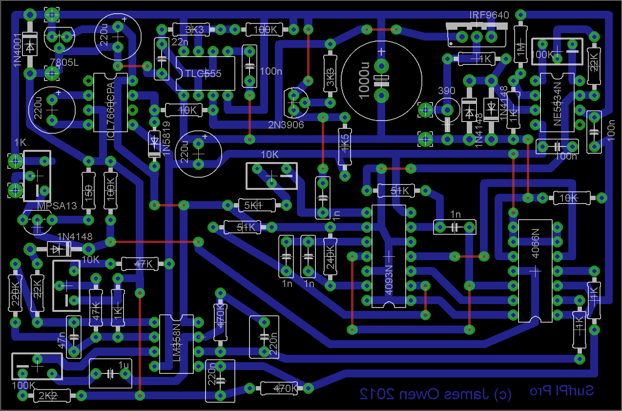

      caps 1uF and 220nf
      hello jim
      at your layout are big caps for 220nf and 1uF
      there is the info some postings above that it will be better to replace the 1uf (none polarized) with a polarized is this right and which direction?
      for the 22nf caps i have only mks type here 63V (the small) but layout shows bigger ones but which type are them?
      thanks for your support.

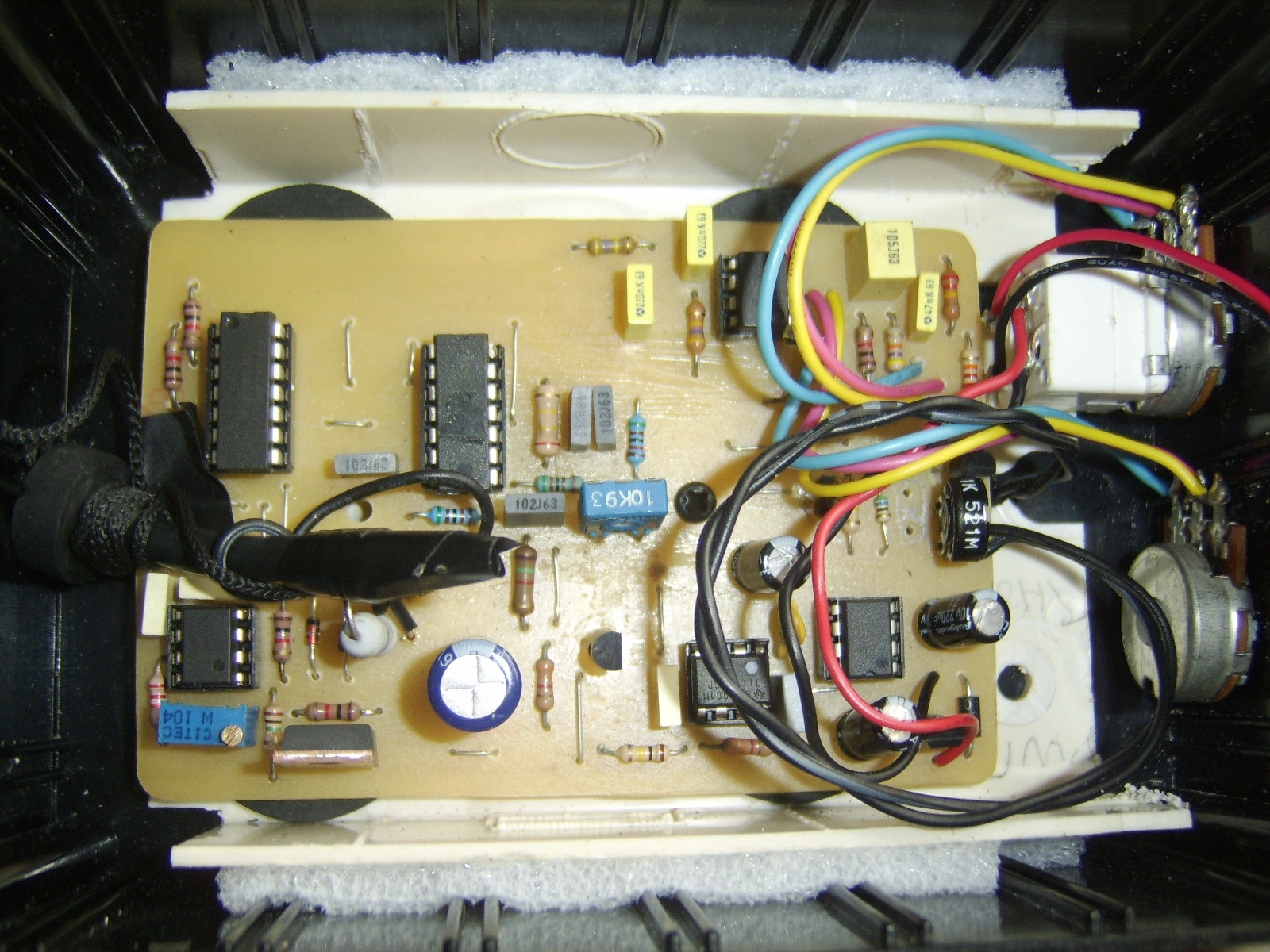

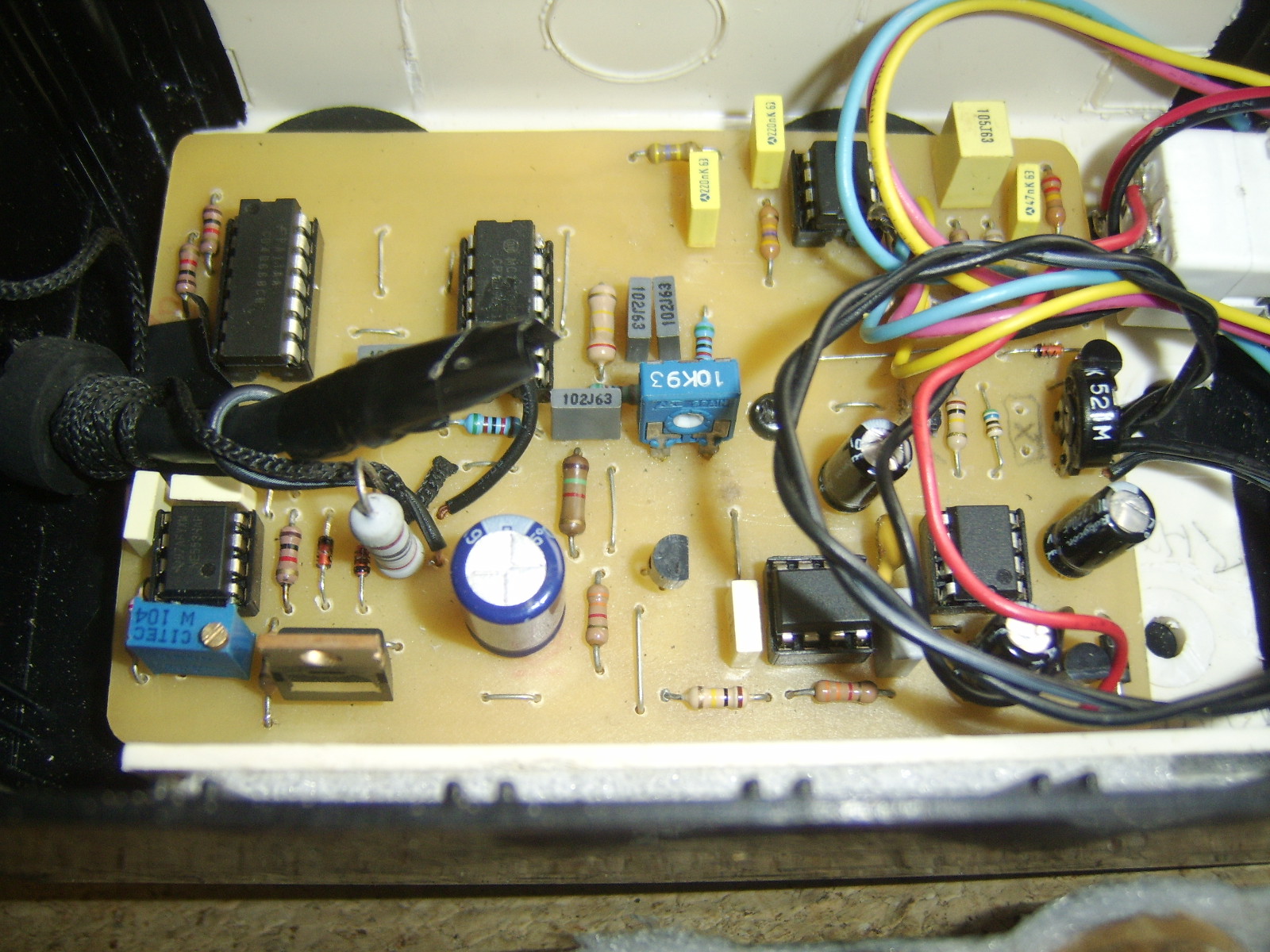

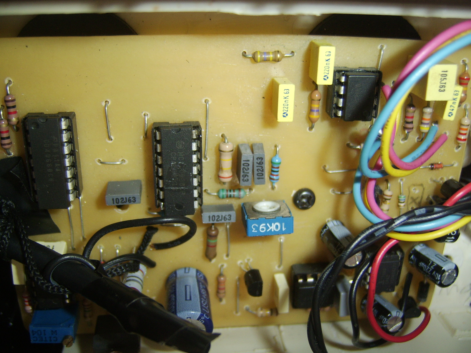

          Hi Bernd,
          Photo's of my board. Sorry they are not from the best angle but it is a real pain to remove the board from the housing, but should be clear enough for you to see. I wouldn't worry about the component body types you want to use - as you can see, mine is made from whatever parts were in my junk box and it works fine!
          Regards, Jim.

            • #66
              thanks jim for the pictures
              i only wait for a big 1uf mks cap to finsh my board
              i think im on the right way
              regards bernd

                this may be useful to some of you just check its up todate, project i never got round to its using the large board like above if you need the copper side etc just ask.
                All i want is a thankyou
                • #68
                  for what, is there something new on the layout picture you posted?
                  did i dont see what you will say?
                  • #69
                    Dont think theres anything new its just a nice big print for those of us whos eyes are not as good as they used to be for component placment
                    • #70
                      ahh ok
