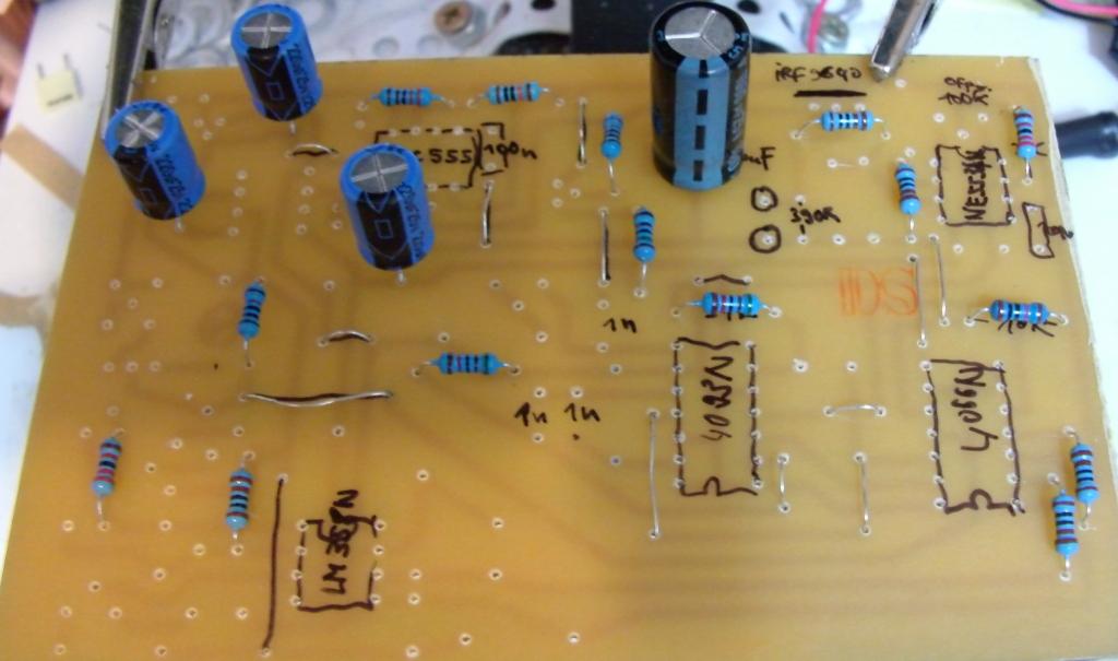

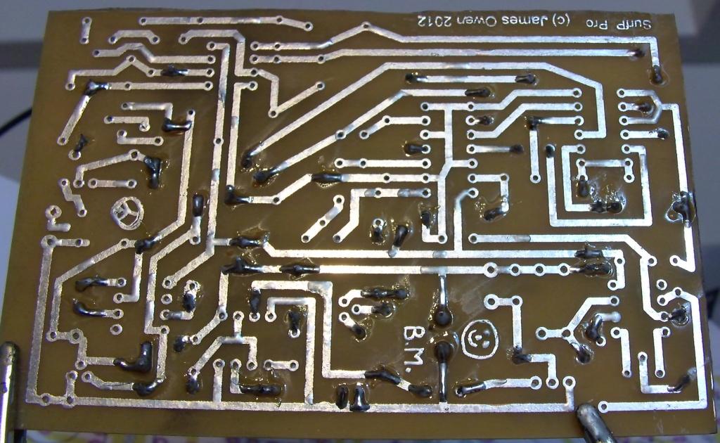

                • #53
                  my start
                  hello
                  im ready for this day 21:49 in germany, time to brush my teeth
                  until the next days
                  • #54
                    good job, but i understand how its diference beetwen this and surf pi? one more lm 358? were is this in pcb? i dont understand....regards,Cristi.

                            • #59
                              Hi Bernte one
                              I am happy to see you are using my Surf PI Pro board, I'm glad someone else is getting some use from my work
                              I've never had any trouble with my own board, worked first time, still working well, still good depth etc. Hope you have the same!
                              @Cristi71
                              The standard Surf PI and the Pro are essentially the same except for some changes in gain around the lm358 section. I've found this usefull when working in noisey environments near power lines and RF transmitters.
                              Regards, Jim
