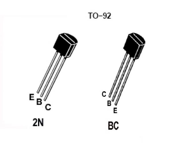

            • I have seen one more replacement ... received BC557C in place of 2N3906
              same pinout for both
              I am going to try trimmer in place of R2 3.3k

                  Think you have to check for the EBC connections ...

                      • ApBerg,
                        I think BC557 is OK ?
                        EBC it is on both
                        http://www.robosapiensindia.com/reso...557%5B1%5D.pdf
                          Siemens and NXP (Philips) both make BC879 and according to product datasheets their pinouts are exactly reversed from each other. So that, facing the flat part of the transistor:
                          NXP BC879 pinout is ECB and
                          Siemens BC879 pinout is BCE.
                          So, how you connect it might depend on who made it. Most digital multimeters have a diode check function that makes checking BJT pinouts very easy. It's maybe a little more difficult with darlingtons, but it should still be possible.
                          I think you are wrong about that pinout
                          Siemens and Philips have same pinouts ... TO-92 housing

                            Hmmm... look at it....and check it ..
