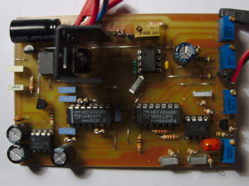

        • Hi all!
          I have finished building my Surf PI detector, the PCB was Surf XX which can be found in this forum. I tried using it on field, the results were good. Sensitivity to coins in air testing was about 20-27cm depending on coin size and material. When the detector was turned on in the house, with minimal treshold there was a little noise on the speaker because of electric devices. In outdoors, this noise was no more audible. The coil didn't detected the ground even without shielding, so I thought I've built a very good detector.
          Then an accident happened.....
          I used a poor quality wire that connected the PCB to the coax head cable connector, and somehow this crap wire broke and made the coil short - during operation.....
          I removed this wire and built in a new one. When i turned the detector on the next time I realized that the sensitivity fell down about 1/2 of the original, so now the machine detects coins at about 10cm. The other bad thing what I found there is no more noise when I turn it on indoors. So the detector is still working, but it became very-very-very insensitive...
          Which part could be damaged? I tried changing the IRF9640 FET, the 2200uF capacitor, 5534, 4066, 4093 and lm358 IC-s but it had no effect.
          Does anyone have an idea how to repair? Should I change all the semicondutors including IC-s, diodes and transistors? I guess the resistors should not be broken.
          Thank you for your attention and help, and sorry for my bad English!

            • andva,
              you should check your power source if it is 12 V and voltage on PCB 5 V around 78L05.
              What is your power source ?
              Also R6 390 Ohm 2 W ... look for burn marks.
              You can probably send PM to one of guru's on this forum.

                • Thank you for your replies.
                  I use 10x1,2V 2100mAh cells and I measure 12,67V when detector is turned on. The power consumption is about 59mA with minimal volume or no sound, 114mA on maximal volume (this high only when beeping loudly).
                  The pulsewidth on the coil is about 34-35us. The damping resistor doesn't seem to be fried and the measured resistance is correct (i use a suitable potentiometer because I'm still experimenting with coils).
                  At 78l05 the voltage is +4,93V, at the output of 7660 is -4,2V. These values were the same when the detector worked well. I checked all the IC-s if they receive the +5V and -5V and they all get the values written above. So the voltages are correct in every places but it is insensitive even with new IC-s. The next thing will be replacing the transistors and diodes. I suspect the 2n3906 transistor might have got too high current.
                  The PCB is my own etched one. I don't think it's necessary to etch a new PCB but probably I will replace almost all the components....
                  • Andva,
                    you shoul'd check for bad soldering poins too
                    maybe it was mechanic stress
                    try bending PCB or taping solder points
                    • Hi!
                      I solved my Surf problems. There were some other crap wires that connected potentiometers with PCB. These had been replaced and detector now working well. Thank you all for your help and thank ApBerg for his great Surf XX design.
                      I wish everyone a merry christmas and very successful treasure hunting!

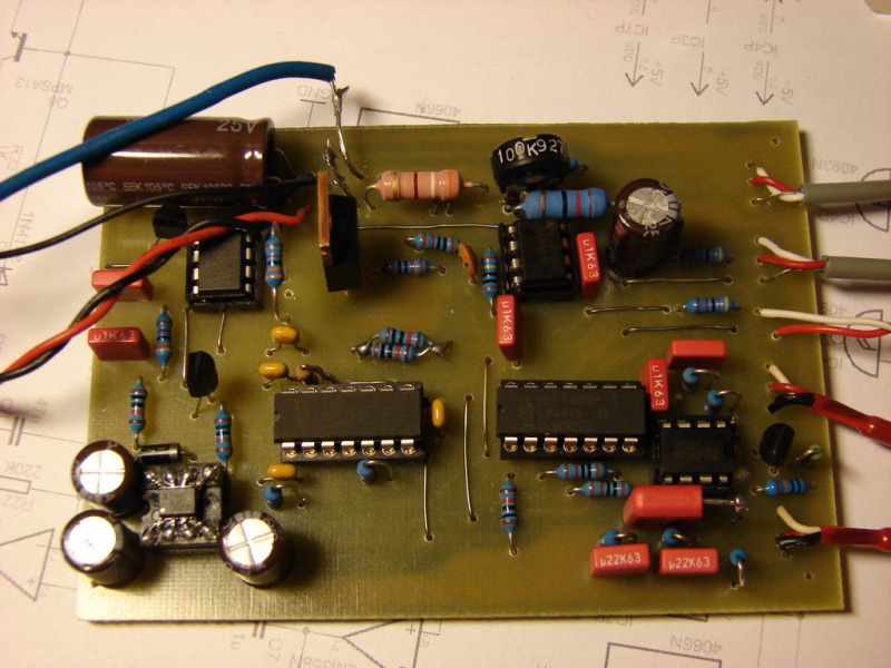

                        • Just finished the build of my Surf PI. Sensitivity is incredible! Still have to do a bit of finetuning... I have used ApBerg's PCB design.
                          I could not get any pulses from Q1 when I first tested it. Somehow R17 and D4, which supply a clock signal to the ICL7660 forced Q1 into saturation. I have removed both components and connected 220 pF from ICL7660 pin 7 to ground. Found this solution in the data sheet. Anyone having problems feeding the clock signal from the 555 into the ICL7660?

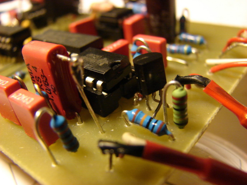

                          • I have finaly made my Surf PI pro from J. Owen design and ApBerg's PCB.
                            Don't have any sound on speaker.
                            All pots are in middle position.
                            I had problems finding MPSA13 - got replacement BC879.
                            R34 is 22R from PCB design not 150R
                            Measured all voltages
                            Connected 12V from power adapter
                            7805 has 12V and 5 V
                            12V on pin4 and pin8 IC 555
                            12V on emitter of 2N3906
                            12V on S IRF9640
                            +5V on IC 7660 pin8
                            +1 V on IC 7660 pin5 (?)
                            +5V on IC 4093 pin 9
                            +5V on IC 4093 pin 1
                            +5V on IC 4093 pin 12
                            +5V on IC 4093 pin 5
                            +5V on IC ne5534 pin 7
                            -4.45V on IC ne5534 pin 4
                            R18 is connected to threshold pot 10k and on other end is -4V
                            Speaker is on + 12V and on pot 1k
                            on IC 4093 pin 14 +5V
                            on IC 4093 pin 7 -4.45V
                            on IC 358 pin 8 +5V
                            on IC 358 pin 8 -4.45V
                            on IC 4066 pin 14 +5V
                            on IC 4066 pin 7 -3.5V to 3.94V depending on POTS
                            • You need around - 4.5 volt at the ICL7660A pin 5 ... so not good, see you use a icl7660 smd.. check if this can work with 12 volts some go only till 10.5 v !
                              Check also the pins from the bc879 and mps13, not the same I think.
                              Check also the current the circuit take's , without audio out around 50 mA
                              Succes
                              Ap
                              .....now I see you got -4.5 V on the needed points in the circuit ... so look again at 7660/5 must be ok !??
                              • ApBerg thak you for your fast reply.
                                Here is more data.
                                I have -4.31 V on pin 5 IC 7660
                                that 1V is on pin6 sorry
                                I used smd IC because I can't find normal one in Bosnia must check for that voltages ...
                                Pinout for darlinton's MPSA13 and my BC879 are diferent - both NPN
                                I think I got it ...
                                faced right MPSA13 has
                                C
                                B
                                E
                                BC879 faced right
                                E
                                C
                                B
                                i turned base to Base on PCB, middle one to top C and first from top to E
                                Current for device is about 60-70mA.
