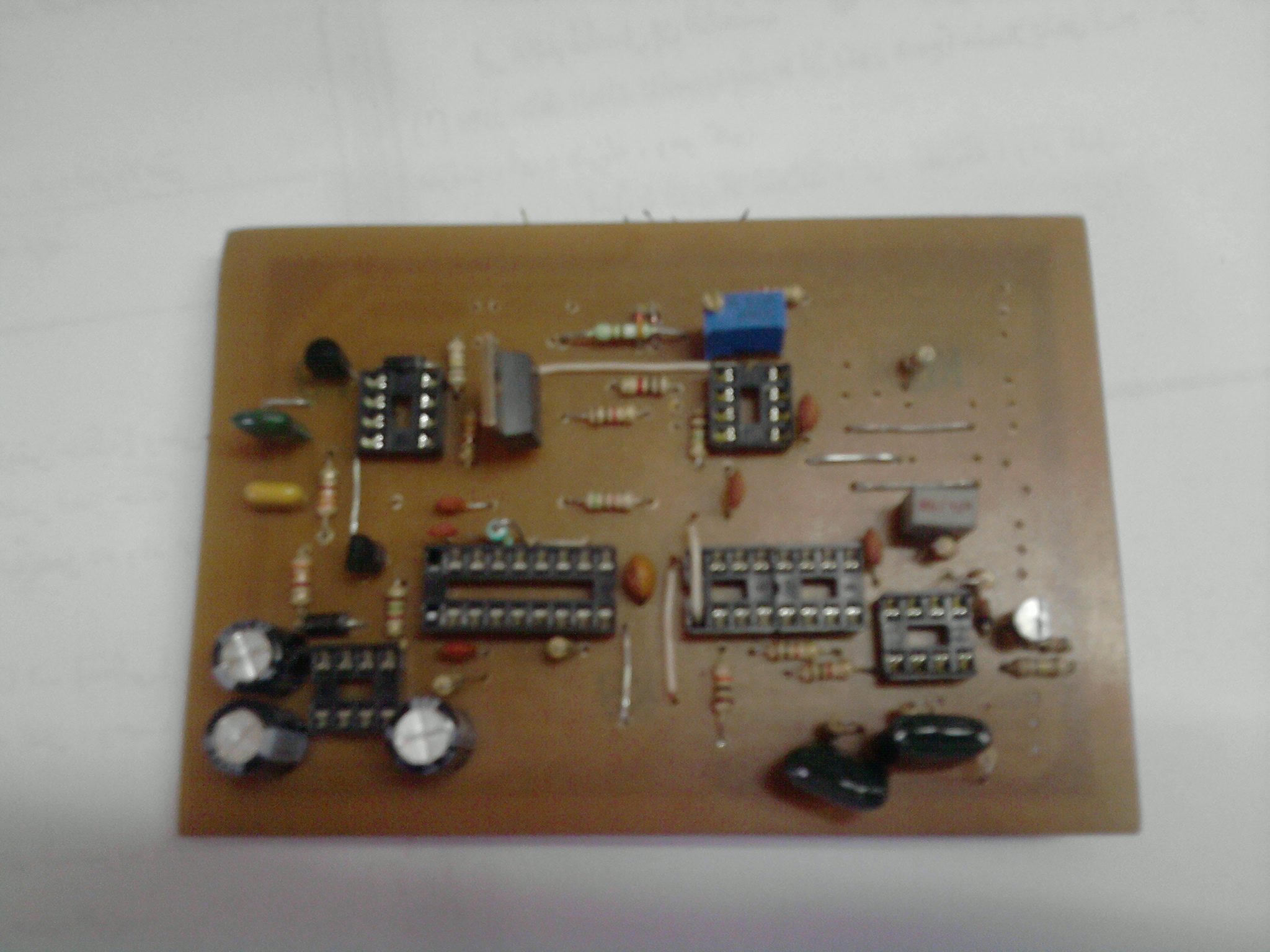

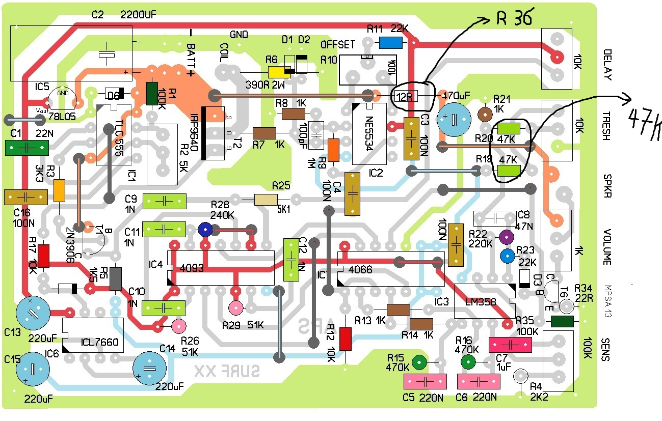

            • iam having some problems if any one could help me please
              1- R36 is "12 Ohm" can i replace it with 10 Ohm 1W resistor
              2- C7 which is 1uf can i replace it with electrolyte one it has + and - , if no i have another one 1uf ceramics but 250v large size is it ok ?
              3- for R20 & R18 which are 47K can i replace one of them with 22K and the other is 47k but 1/8 W is it ok ??
              4- the capacitor i used is small as shown in fig so i think its low power is it ok or shall i change them ??

              • 1. Yes, that's fine.
                2. Electrolyte will probably work OK. 250v ceramic will also work.
                3. 1/8W is fine. I would put the 22k in R20, probably will make the threshold a little sensitive but should work.
                4. Caps should be fine.

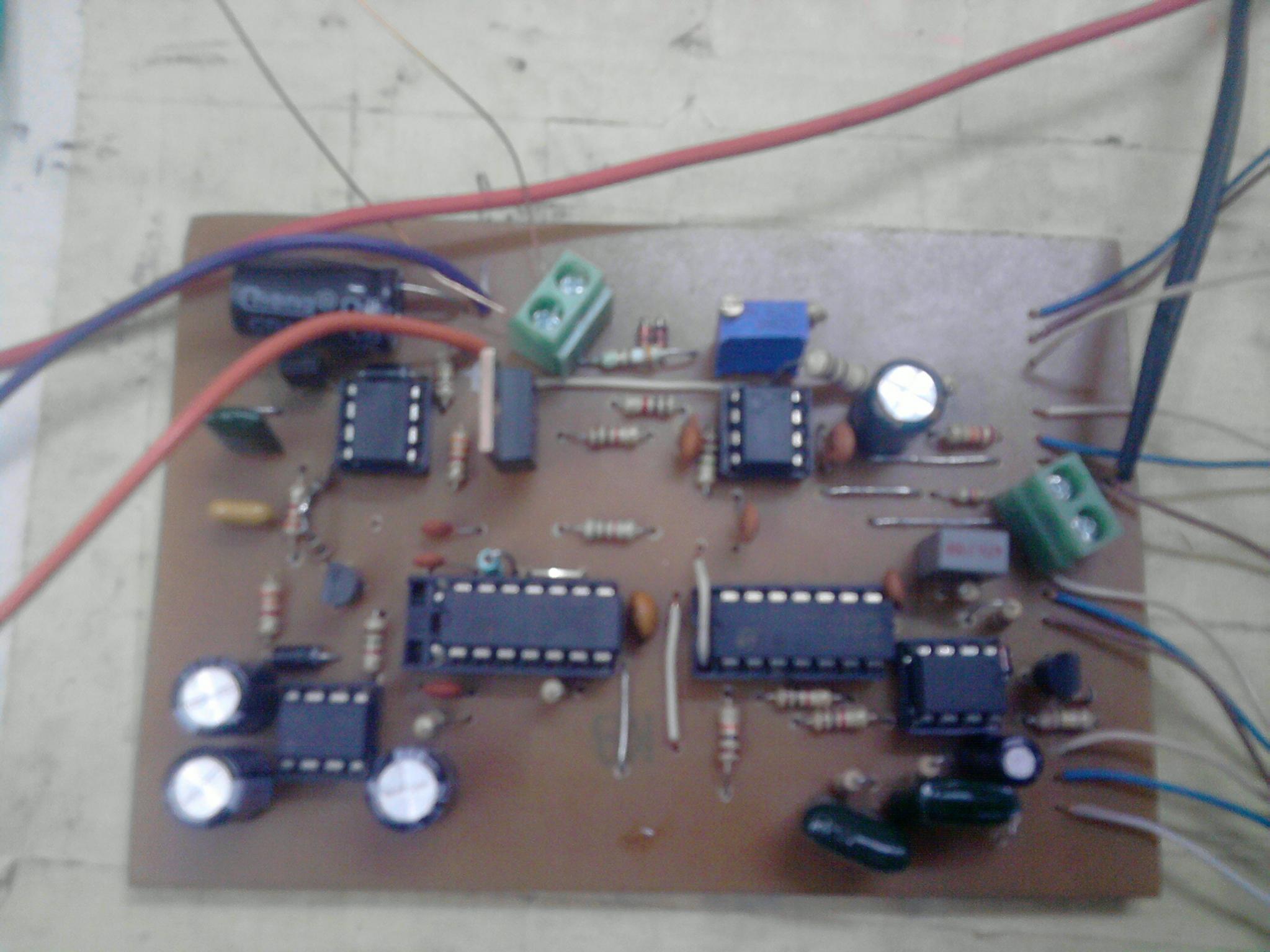

                  i have made the circuit but it didn't work :\
                  so could you please tell me where the points to check with multimeter to know if the circuit is working or not ??
                  thanks in advance

                    i replaced delay 10k pot with 50k pot
                    and placed 200 Ohm on the 3906 emitter
                    iam using coil with diameter 125mm ,0.4 ,19 turn
                    here is my circuit

                    • i don't have any sound until i touch the mpsa13 base with the multimeter and the sound increase when i touch the mosfet in same time with my hand
                      but there is something strange happens now i unplugged the power and trying to measure the points i found that the GND and +5, +12 all are short circutied with GND
                      555 all pins are connected to the GND except pin 2,6,7
                      76605 pins 3,5,7,8 also connected to GND
                      is this is normal ??
                      the pots gives no response only the volume and offset they made some changes in sound and in pin 6 of NE5534
                      • did you check orientation of your NE555 ?
                        you need to pop out all ICs except 7660 and try voltages and then with NE555 same thing
                        can you try measuring without coil also and before you pop them out (ICs)
