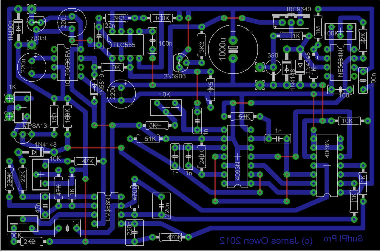

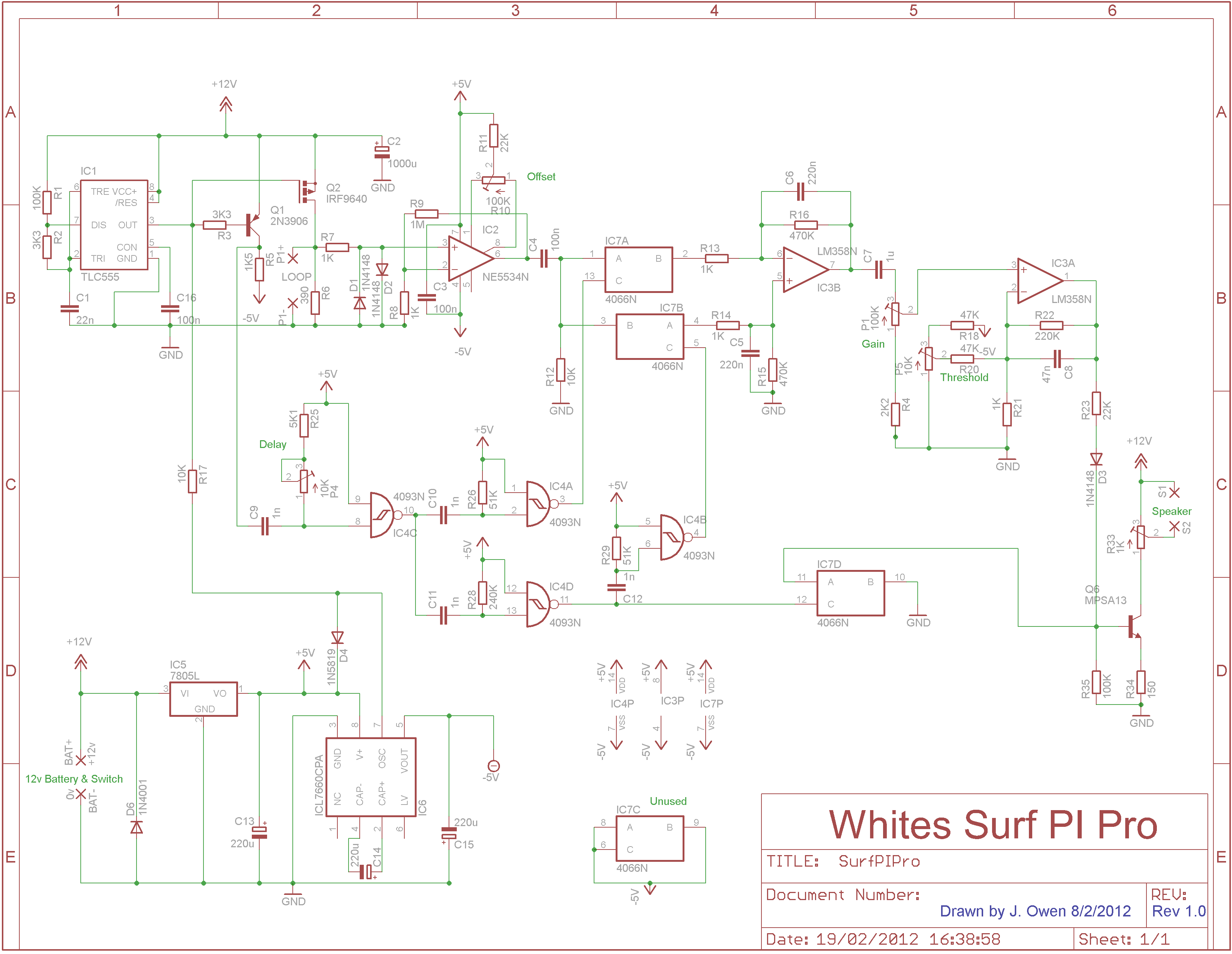

    Fixed the error - C7 is now a stacked poly. Here are the updated Eagle files.
    @ Steve: Really I have come to the end of the road with the Surf PI project. I have a nice detector that works quite well and that I am satisfied with. I'm now moving on to fully digital, PIC controlled PI's. If you would like to take up the baton and make the improvements you have suggested then feel free to use my layout as a starting point.
    Regards, Jim.

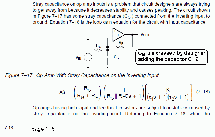

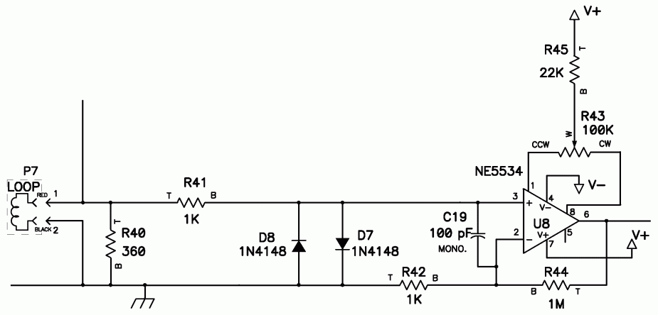

        Attention! The capacitor C19 - 100pF (on the original schematic) is very important. He shortens the answer for several us.
        Mrand
          Mrand
          It shortens and my brain.
          Can somebody explain how to calculate capacitance of C19 ?
            You don't need to calculate. C19 is most probably added to reduce RF interference picked up by coil and cable. 100pF+2x1K provide rolloff slightly above any frequency important for PI target response. When high enough level RF enters opamp input, it is no longer amplified, input stage starts to rectify it instead, changing DC offset in response to RF envelope, spoiling detector operation (few such cases are reported on this forum whit different detectors).
              Before you will knock together the next joke, "extend your brain" and do some reading about the compensation the OP. Lead-Lag, Forward compensation, Compensation across modification of input impedance and other.
              Mrand
                  Mrand
                  Thanks Mrand, but I think the circuit designer added the capacitor C19 experimentally (without mentioned by you knowledge).
                  See Ron Mancini pages 116 - 121.
                    question i asked had allready been covered
                      hello
                      i´m not able to extract a simple black white image from copper tracks and pads of pcb
                      from eagle layout viewer
                      can anyone post b/w image here?
                      thanks
                      • #41
                        This is simply. You must mark suitable layers. 1-Top, 17-Pads, 18-Vias and 20-Dimension.
                        Afterwards to execute the sequence.
                        Menu: File\
                        Export
                        Monochrome
                        PNG or Bitmapa
                        Enter
                        And picture is ready. I don't warrant the correctness of the scale.
                        Mrand
                        • #42
                          It would be nice from different PCB-design tools owners, always post PCB slide in Black/White presentation too.
                          Thanks in advance.
                          • #43
                            Hello
                            open *.brd file,On view menĂ¼;displey hide layers, select pads via etc.
                            from file menu ,Print,select pdf format.
                            http://hotfile.com/dl/147652684/481a...PIPro.pdf.html
                            waiting for test show video
                            Best wishes
                            Sami
                            • #44
                              black white pdf pcb
                              • #45
                                Originally posted by samii View Post
                                black white pdf pcb
                                Thank you samii!
                                Nice work.
