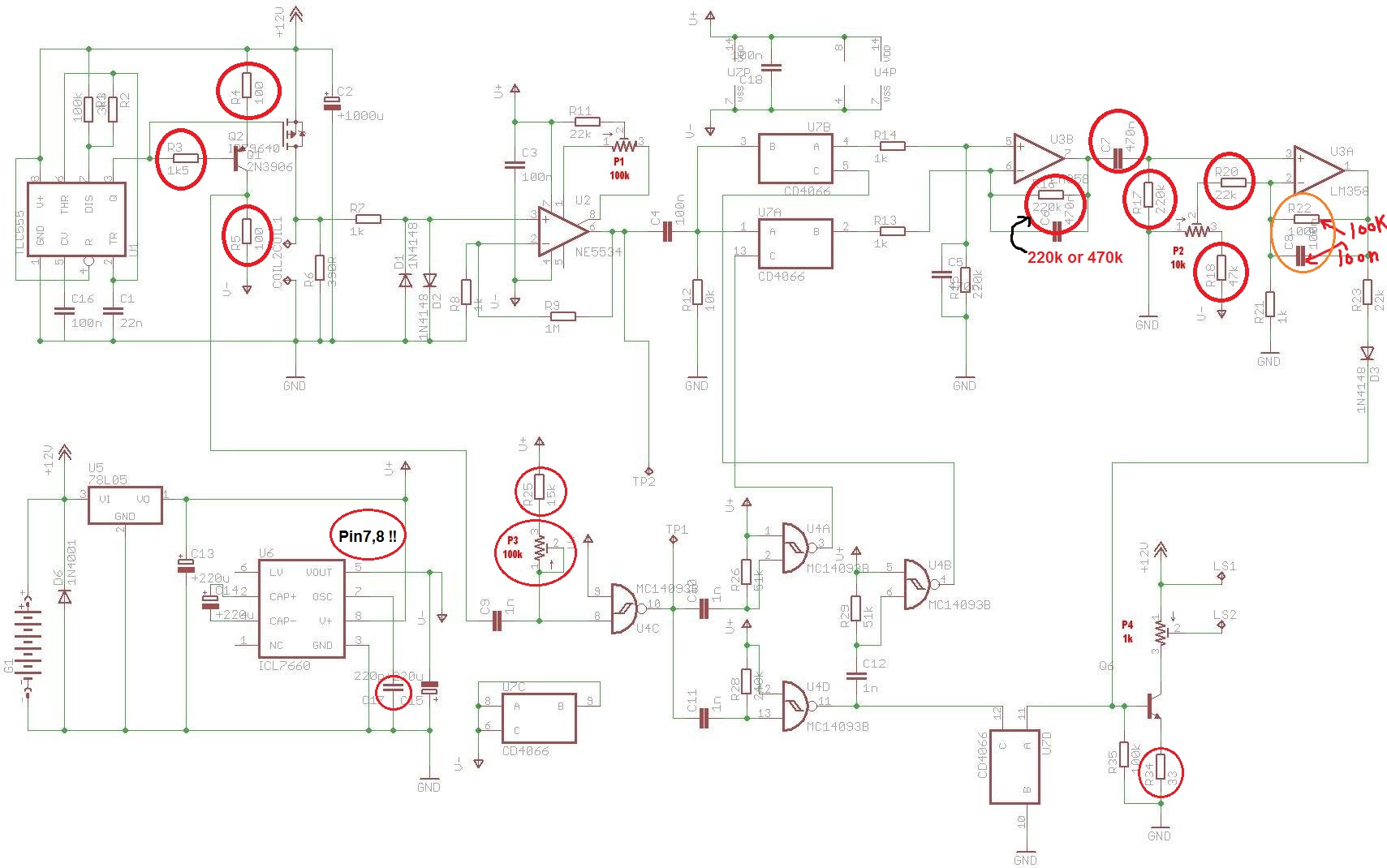

                        and please have look at this i found here
                        i marked the changes with red circles

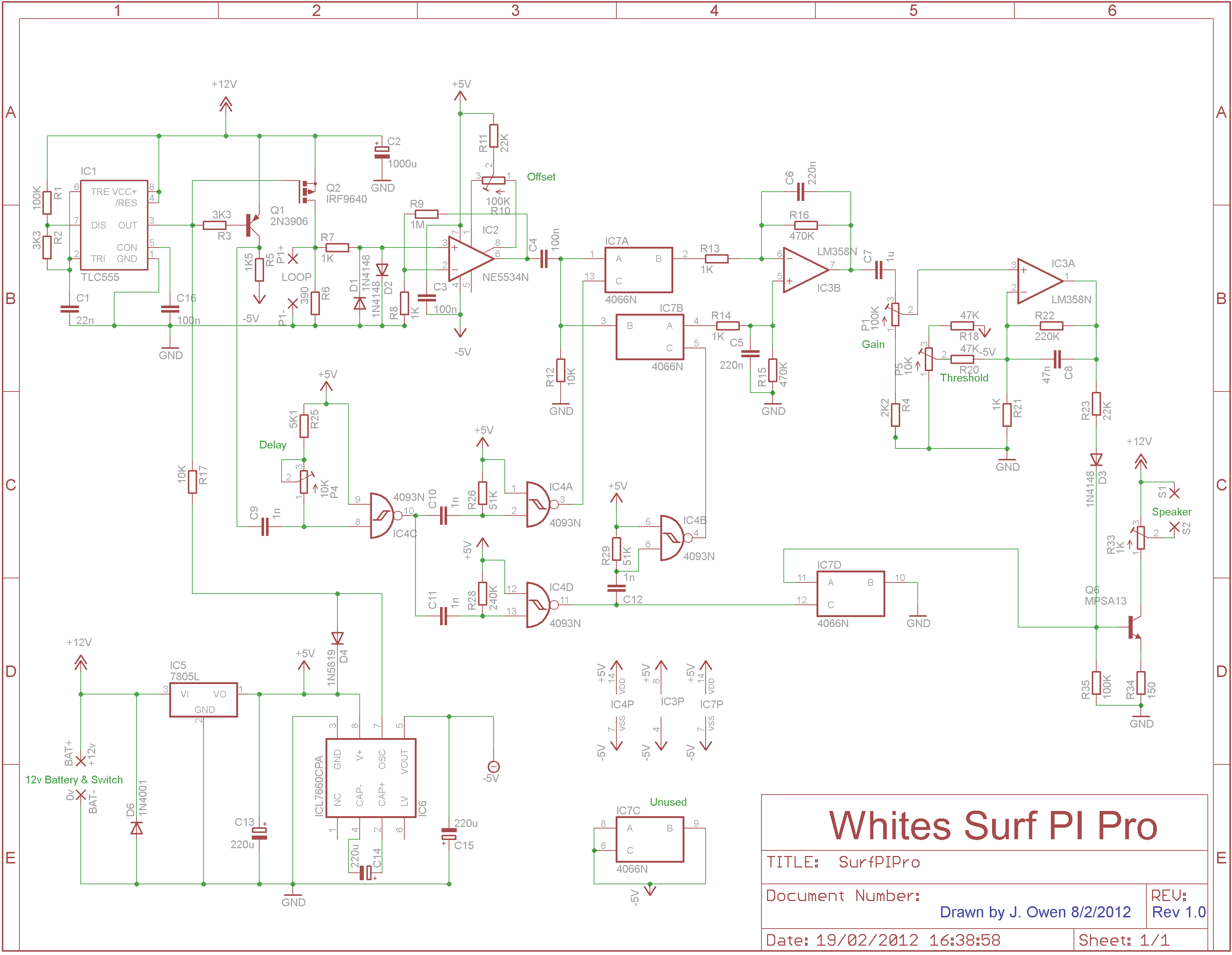

                        and here also the original one
                        please tell me if this changes are ok or not ?

                              Mohamed, R25 stay connected for the moment, to increase the delay, which may occur with short delay due to malfunction of the coil. The original design has a fast response coil.
                              The two modes one of R 330 and the other is R 3.3K. Use only one way, I use the 3.3K, in my Surf Pi worked, other forum members had no problems.
                              R15 and R16, C5 and C6, must be equal, I use 470K and 220 nF.
                              C7 is 1 mF (nF 0.47 X 2).
                              For R18, I use 22k, to change the audio setting range.
                              For the other components, I use the diagram below, J. Owen, and works well.
                              LM386 audio amplifier is a circuit for testing, the audio can trace and verify the operation of the oscillator 555.
                              Jose
                                Jose

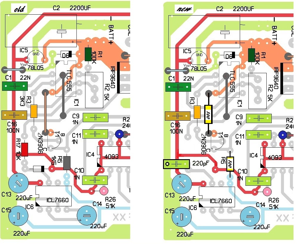

                                how about this updating from ApBreg
                                Look at the drawing...
                                Replace R3 for a resistor 1k5
                                Remove link from the +Batt to the 2N2906 and replace this link for a 100 ohm resistor
                                Remove R17 and the Diode
                                Drill a small hole in the ground track to place a cap from 220pF that has the other leg in the anode from the removed diode
                                Replace R5 for a resistor from 100 ohm.
