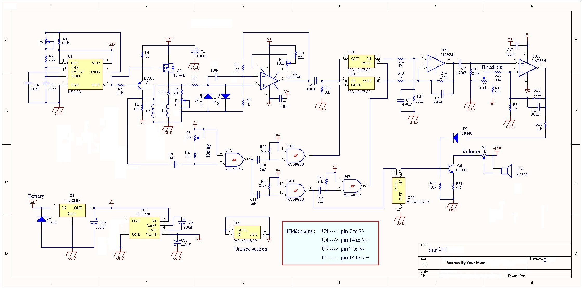

  • I know that Surf pi pro can work with 9V battery - with less depth,
    can it work with more that 12V ?
    Looking to replace sealed lead acid battery 12V 1.3Ah with li-ion battery pack 4x3.6V.

    • Surf Pi Mod Schematic

      • this mods
        working great
        • this mod i just test in air with spiral coil i can detect small metal transistor 2N2222 from TGSL not Working PCB about 30cm in air

            TWO coils in parallel - working mod? What improvement you can get out of this solution? Are there explanation why this is better than single coil?
            • this is original schematic bro
              http://img42.imageshack.us/img42/313...fschematic.jpg
              i have test this mod its relly working great
              i test with surmaster board and i dont put the pinpointer coil just put the single coil
              • Ah I see, second one coil is for additional pin-pointer.
                Thanks for clarification.
                But which mod in fact you are talking about? Mods made in original schematic with red redrawn?
                • yes the red one
                  the clear schematic is redraw by me hahaha
