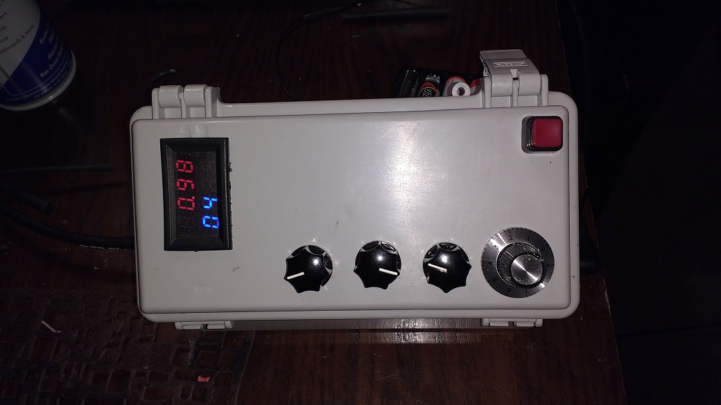

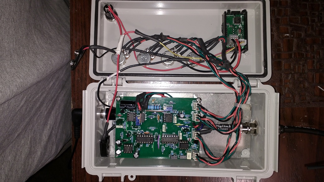

                        • I have my detector about finishes and it works with mock-up coils. But I am concerned the battery consumption and current draw may be high. My current draw (not sure about the significant figure I maybe off one) was 15 mA without the coil and went up 40 mA with the coil (on a cheap volt/amp meter in series see picture). I was wondering if that was in the normal operating ranges. I checked the current draw before I put in the box with my DMM and I think it was normal 15mA. The picture shows the volt/amp with the coil attached with RGX8 approx 9 ft and 9.5 inch coil approx 320uH (the led display was moving and didn't capture the correct reading it was about 11V and 40mA)Click image for larger version
ID:	345949Click image for larger version
ID:	345950. Thanks in advance, I am still on a steep curve on all fronts but I quick learner.
                          • A PI type detector typically puts 1 Amp into the coil but just for 1% of the time.
                            Your meter will read the average so will be much less. 40 ma is fine.
