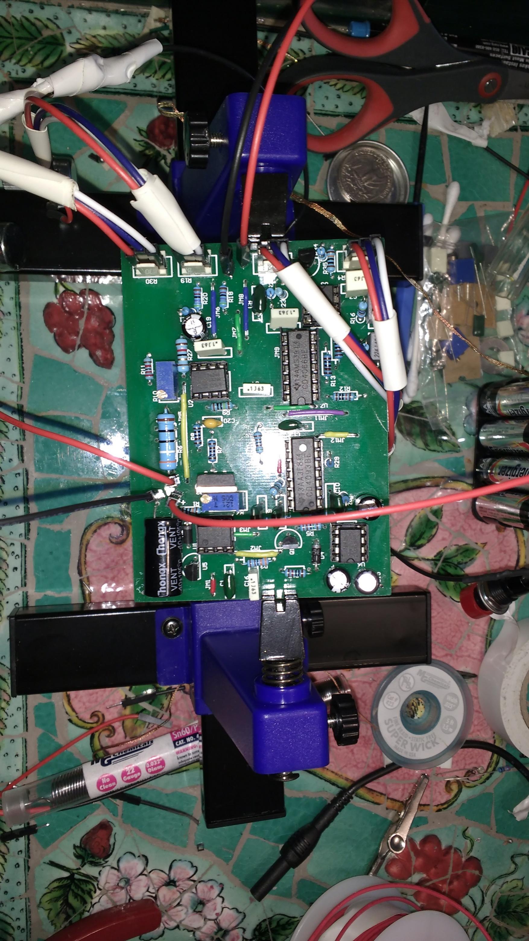

  • Hi, well I put it in the orientation the circuit board indicated, as you read the writing on the chip Pin 1 is the bottom left. I found a schematic on page 8 or 9 that identified some voltages to check on some of the runs. I may take the socket out and replace too. Thanks for the reply. I am also buying Silverdog's board. I have to read the chips and study the schematic, I am geologist and my electronics is limited to a circuits class and college physics which was almost 40 years ago.

      • Hi porkluvr, post #898 in this thread I put an top view and a bottom view of my board. I have been trouble shooting with all ICs out except 7660 and the voltage check failed for -5V at pin 5. I swapped ICs with the same results. I started reading through the threads and found a schematic and a post #273 that identified some tracks and voltages I should check. Which I planned to do. I am pretty sure I have the components in the right place. Thanks for reading and replying to my posts, any insight or direction is appreciate. I also ordered silverdog's kit.

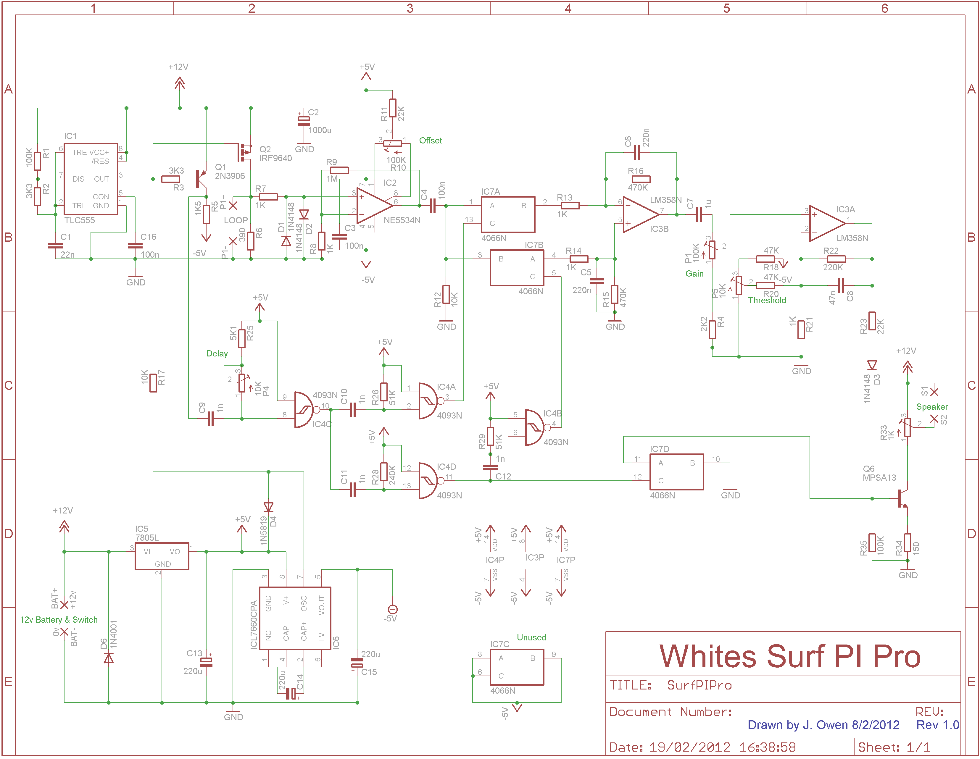

          Alright, maybe I should already know this from the board you are using, but I don't, and I should have asked before: whose schematic have you followed? (And if you would, either post it, or else post a link to it, or state which post number where it can be found).

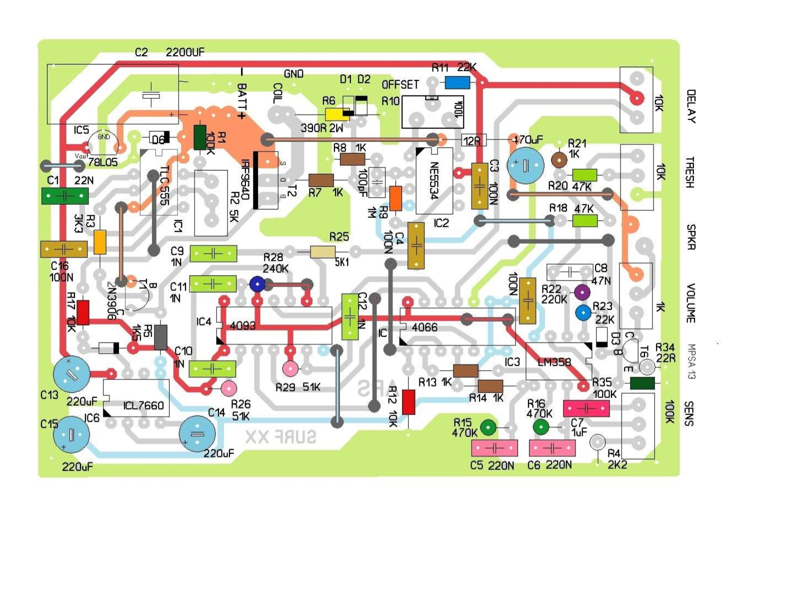

          • Thank you so much for taking the time to look at my problem. Here is the schematic of board I am working,Click image for larger version
Name:	surf pro PI Schematic xx.jpg
ID:	345794. I am a new to this so I expect to do alot of searching and testing i have already learned a lot from the others.
            • Originally posted by jimfrombr View Post
              Thank you so much for taking the time to look at my problem. Here is the schematic of board I am working,[ATTACH]36255[/ATTACH]. I am a new to this so I expect to do alot of searching and testing i have already learned a lot from the others.
              That is not a schematic you showed in 906, that is a PCB layout. It has a components overlay and that is a plus, but sometimes it is easier to describe what is happening if there are reference designators i.e., R1, D2, etc. Your component overlay is not comprehensive in that regard, for instance, the diode connected to ICL7660 pin-7 is not labeled.
              So, did your kit come with a schematic?
              Regardless, you need solder wick and probably some liquid flux to do a good job of what comes next:
              Disconnect everything connected to pin-7. To do that, unsolder one end of the diode (you know which one), and unsolder one end R17. Gently raise those leads, try to do so without damaging the components. Then, unsolder IC6-5 (ICL7660 pin-5). Don't try to raise pin-5, just try try to isolate it from the surrounding copper trace.
              (Use some alcohol or water to clean up the mess, depends on what kind of flux!)
              Then try so see if you have -5V, measured directly on IC6-5. If no, then you may have a defective C14.
              You have -5V, yes or no?

              • unfortunately, I didn't get a schematic with the kit, I searched this forum and found what I believe is the schematic but there may have been mods I am still learning. But anyway this is what I have Click image for larger version
ID:	345795. I have solder wick. Thanks for the direction this will be fun sorting through. I will certainly let you know if i am successful. Thanks

                    • Well I couldn't find any opens or shorts on the board continuity looked good every where (following, blue, brown green traces in the parts layout drawing I had). I am going to disconnect the components recommended and check the capacitors and diode. I bought two kits from and the same time and either by DMM (exotech 430) capacitor function isn't working or I got a bunch of bad capacitors in the kit. I am on a step learning curve but I am making progress.

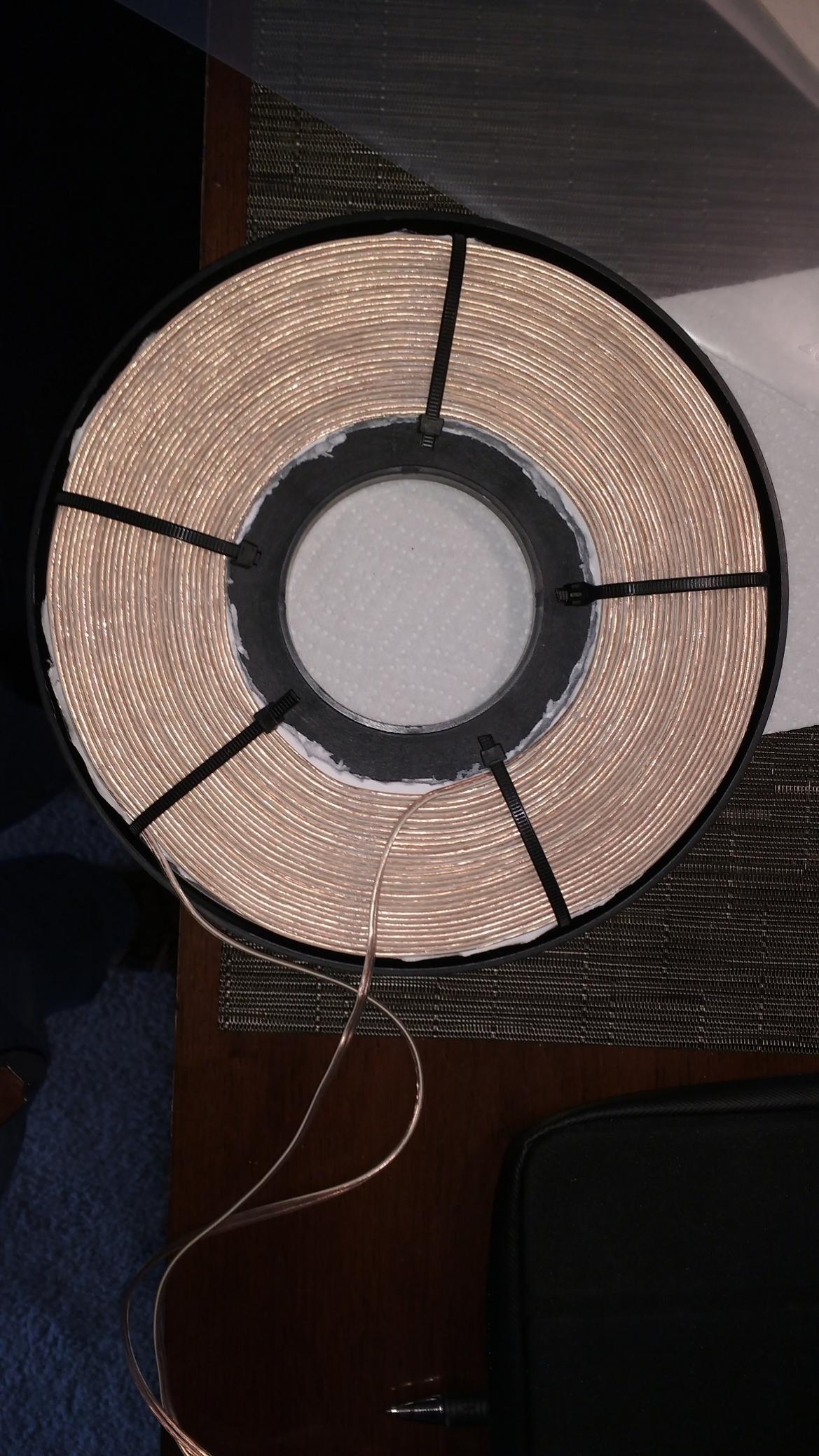

Name:	24 awg 9 in-30turns.jpg

                              Well I have volume, a solid tone the pot seem to work, but I cant trim R10 to 0V at pin 6 of NE5534P I can get to to down to +0.56 V and then it start going up or erratic. I am listening through piezo buzzer which probably is not the best. I attached a photo of my board and the coil (spiral wound 24 awg double wire 30 winds) which was recommended. When I was adjusting R10 I had threshold set at constant whine just above no sound the other controls accept volume where set at their mid-range position. I had the proper +5v and -5V pin 5 of ICL7660 and pin4 of NE5534. First question is should I be able to get 0V at pin 6 of NE5534P and does the POT positons for delay volume and sensitivy affect the measurement when zeroing? Thanks in advance .
