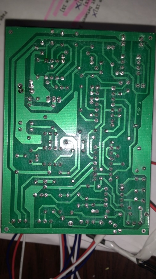

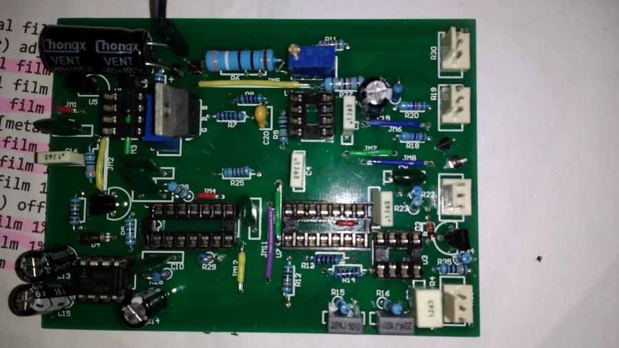

I just finished a Surf Pro kit and was checking Pin 6 on NE5534P (U2) and it was 6.34v the instructions in the setup indicated to trim R10 to a 0V reading. My trimmer wouldn't bring it below 6V. I checked the board and cleaned it well. I have searched the thread but may have missed a clue to trouble shoot my problem. Right now I am thinking it is as a bad pot are there any threads I should be looking I welcome any advice. Regards
What are the details of your coil ?Originally posted by jimfrombr View PostI just finished a Surf Pro kit and was checking Pin 6 on NE5534P (U2) and it was 6.34v the instructions in the setup indicated to trim R10 to a 0V reading. My trimmer wouldn't bring it below 6V. I checked the board and cleaned it well. I have searched the thread but may have missed a clue to trouble shoot my problem. Right now I am thinking it is as a bad pot are there any threads I should be looking I welcome any advice. Regards
Do you have -5v on NE5534 pin 4 ?
Hi Silverdog, I haven't built a proper coil I used 22avg stranded wire to make a 6inch coil 15 turns (that is all I had to use) I have proper material on order. I wanted to do some preliminary checks until I built a functional coil. To answer your second question I only have -0.7V on pin 4. Thank you for answering me, I am still reading the posts to learn from others.
With a 6" diameter coil, and only 15 turns of 22awg wire, the inductance must be around 95uH. It should be between 300uH and 400uH for the Surf-PI.Originally posted by jimfrombr View PostHi Silverdog, I haven't built a proper coil I used 22avg stranded wire to make a 6inch coil 15 turns (that is all I had to use) I have proper material on order. I wanted to do some preliminary checks until I built a functional coil. To answer your second question I only have -0.7V on pin 4. Thank you for answering me, I am still reading the posts to learn from others.
If you don't have -5V on pin 4 of the NE5534, then you have a fault on your board.
Thanks for the response, I am new to using forums so I hope I don't break protocols. I performed your check and I do have a problem +5V at pin 8 and +.7V at pin 5. I tried with a second IC and got the same results. I searching the board for faults. I an rusty in electronic and have a lot to learn. I will keep on plugging away. I posted two images of the board I completed. Since trouble shooting will be difficult for my lack of technical skill execution is critical to start. Thanks for any advice all will be appreciated.
