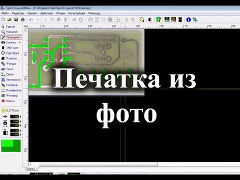

  • i use Sprint Layout for the scale. only fit image you load as a 'shablon' (template) on any IC pins, decrease or increase
    it before getting full overlap knowing a pins step is 2,54 mm. then after you can sure measure the size.
    • from 0:57

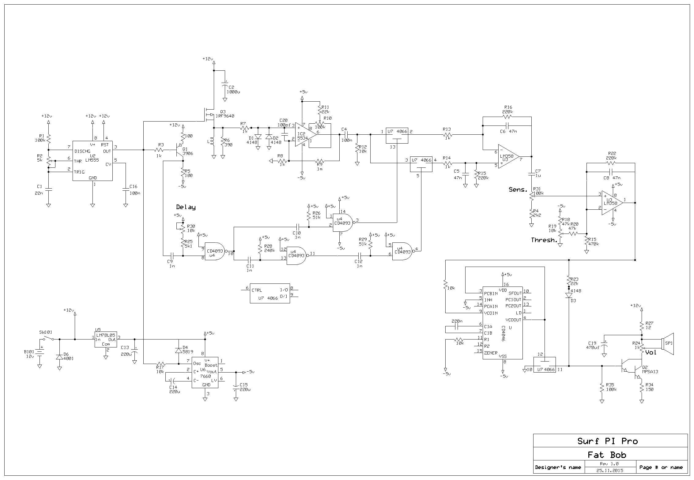

                  • Has anyone added a VCO to surf? I've been looking around a bit and found a few different designs.
                    Here's something I just drew up, I may try it on my current build;
Name:	Surf PI Pro 4046.jpg

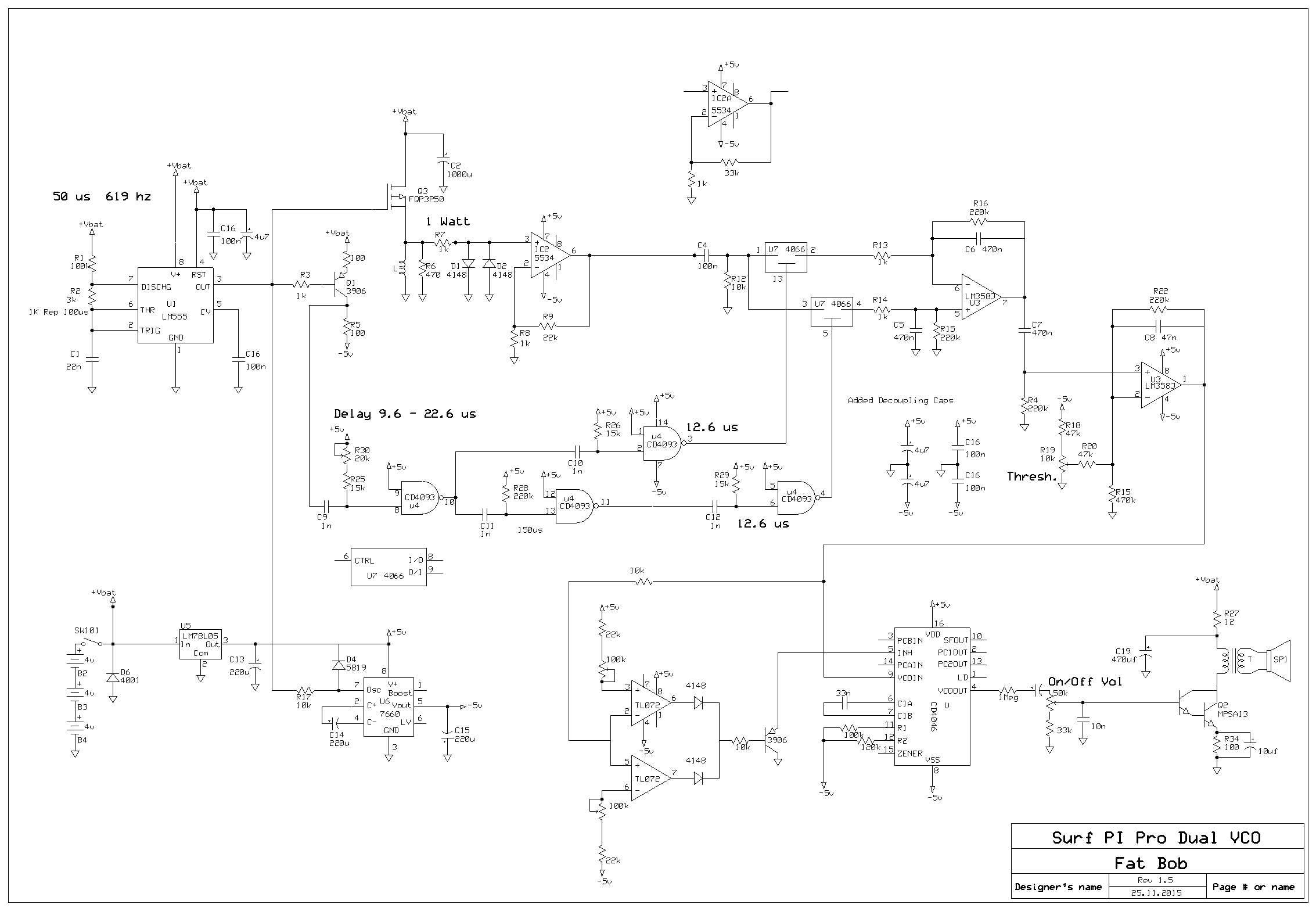

                    • Or maybe this Dual VCO version...
Name:	MY Surf PI Pro Dual VCO.jpg

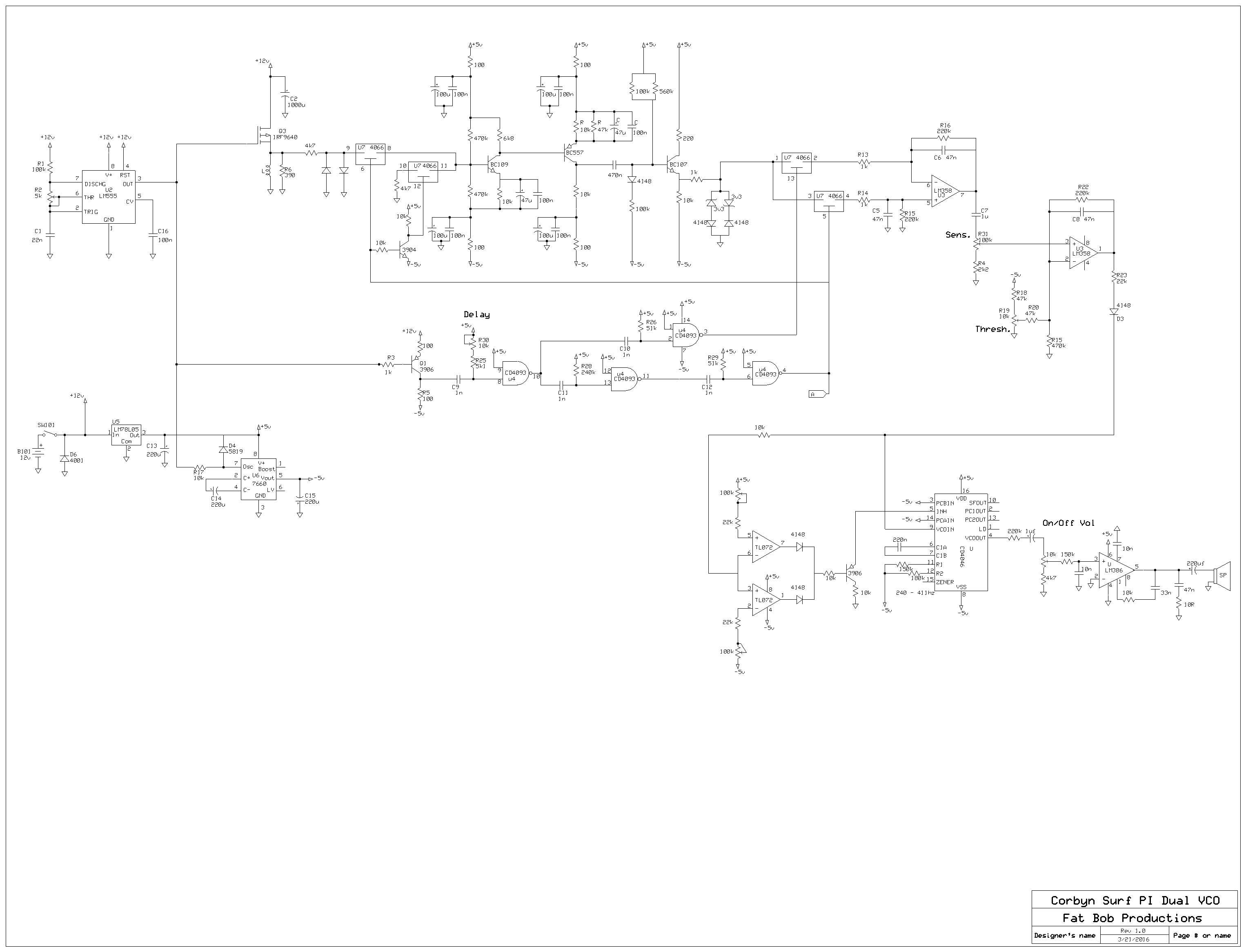

                      • Here's a Surf PI with Corbyn Preamp and Dual VCO;
Name:	Corbyn Surf Pi.jpg

                            • Dont know where it came from, dont know if it works .

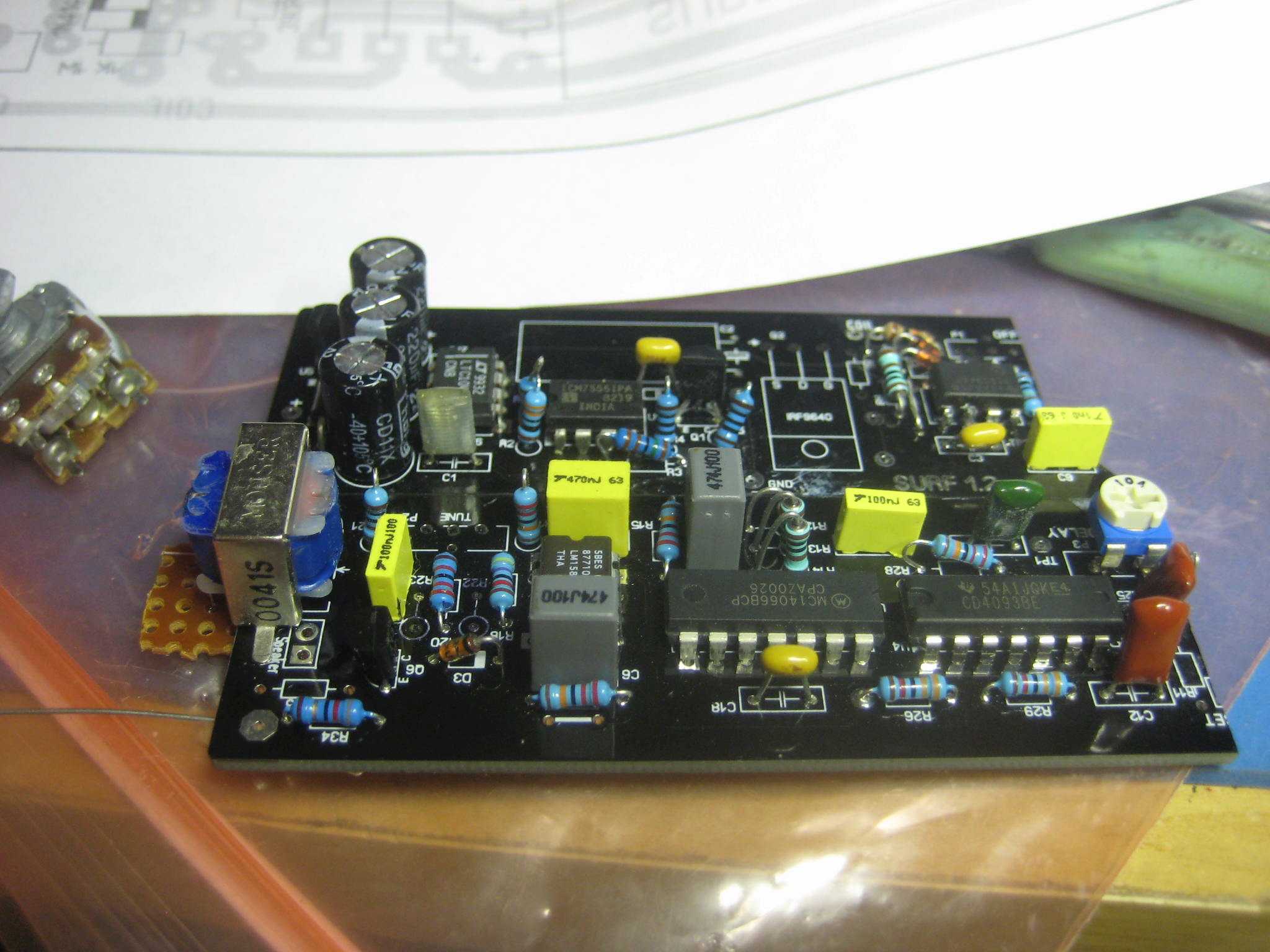

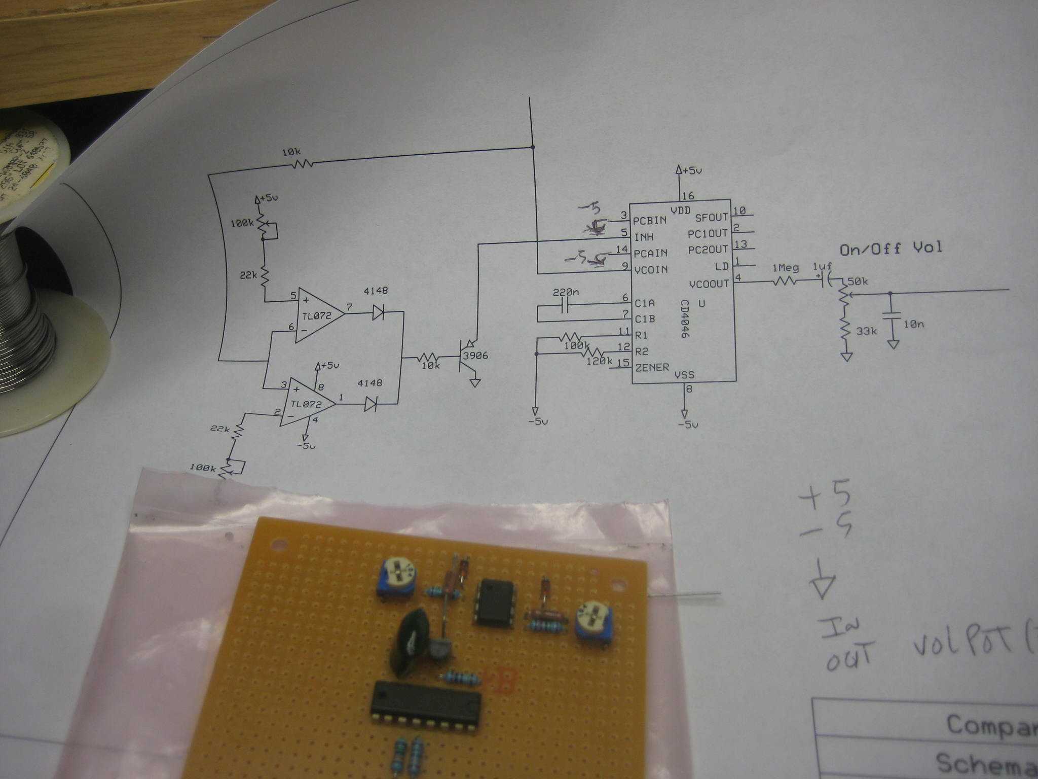

                              • I have 2 Surf PI's that I just built. I just drew a couple of ideas using parts from other schematics.
                                There's no layout and they are unproven designs at this time but I'm working on it.
Name:	Short Long Board.jpg
