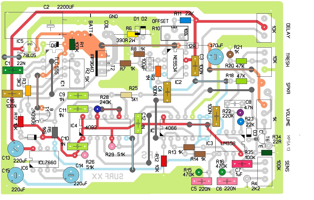

              I want to take this time and ask them also a help my SURFXX APBERG.
              I finished but was unsuccessful. He is making a continuous sound with or without coil.
              I checked the contact between the tracks, and everything ok.
              I changed all cis., One at a time, without success. resistors tested and all ok. Just do not capacitors. I have as few as one meter for testing.
              My problem is similar to mr. Sdesic.
              Paku also had a similar problem. but I did not like was resolved.
              I ask your help on this issue. Can anyone confirm new PCB p / b ApBerg for printing, to make a fresh start. Grateful to all.

                Adjust the offset properly with a coil connected to it..used multiturn trimmer for ease of adjustment.

                  The principle then the assembly was already correct. What was really missing was a cincronizado fit between the pots . I fit in Grey u2 ( ne5534 ) to adjust 0 volts and can already detect a 1 real currency to 15 cm . Now I have to make him reach the depth of 30 cm which is the distance that the staff there this forum mentioning .
                  I made the changes already mentioned by the staff .... I removed the R- 17 ( 10K ) and the diode D -4 ( 5819 ) .
                  replaces R5 ( 1k5 ) per 100 ohms and the jumper ( 2N3906 ) by 100 ohms. I put C -19 ( 200pf ) to pin 7 ICL7660 land and reversed one of the ic- 4 legs ( 100nf ) the jumper connected to the pin 1 of 4066. If you have any further information I am very grateful.
                  I am happy to be in touch with you here through the forum. Thanks again for your help.
                  • Hi gerson! If you are building this version then well it is correct. I dont think you need to change some parts.
                    Experiment also the damping resistor value because it cause also the detection depth.
