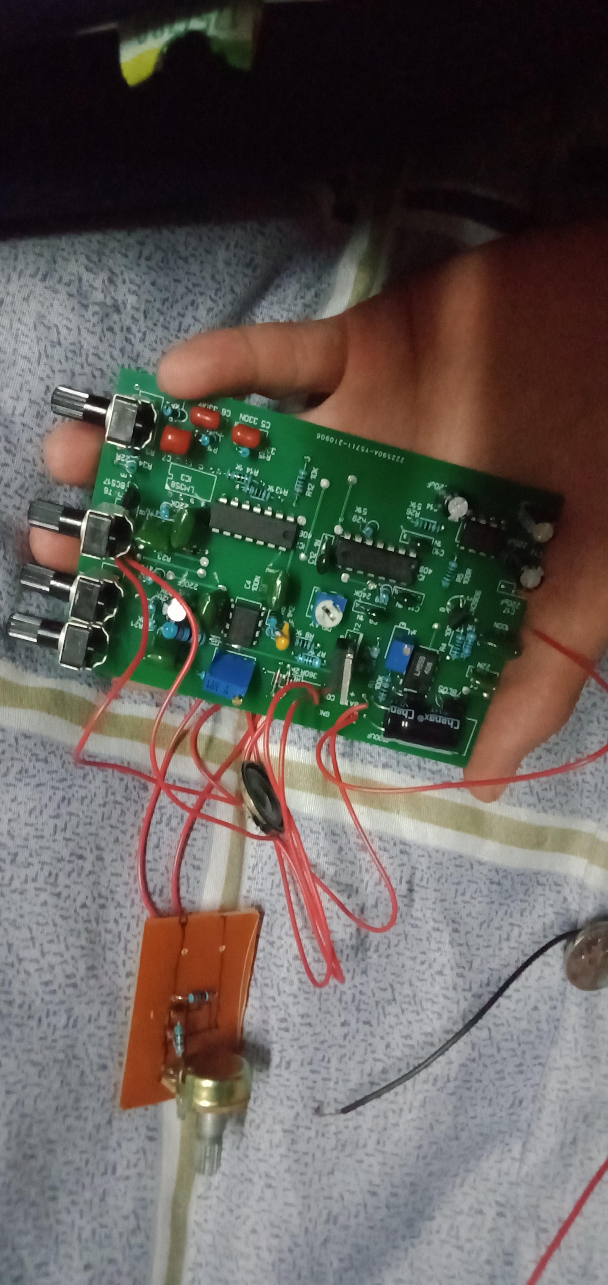

          • Masters, my surf pi pro can only detect five centimeters
            I used a regular horn.
            The tlc555 was replaced by the lm555 with a voltage of 0. 4V
            The voltage on pin 6 of ne5534 can only be adjusted to about 4V, and it will only rise.
            All other voltages are normal.
            Please help me, masters.
            Thank you very much.

                Post a picture of your PCB
                • Fortunately, after I adjust the damping resistor actually work properly, do not know why, upload pictures here will not be easy.
                  • upload pictures here will not be easy.
                    that was done against the spammers. use long way, via go advanced.
                    do the pics on sunny day under the sun. your pics are blur be cause very poor light.

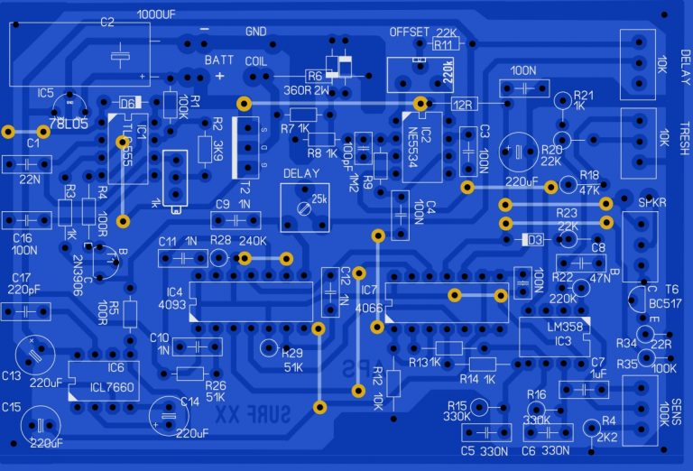

                    • Can anyone tell me that there is nothing wrong with this circuit layout?

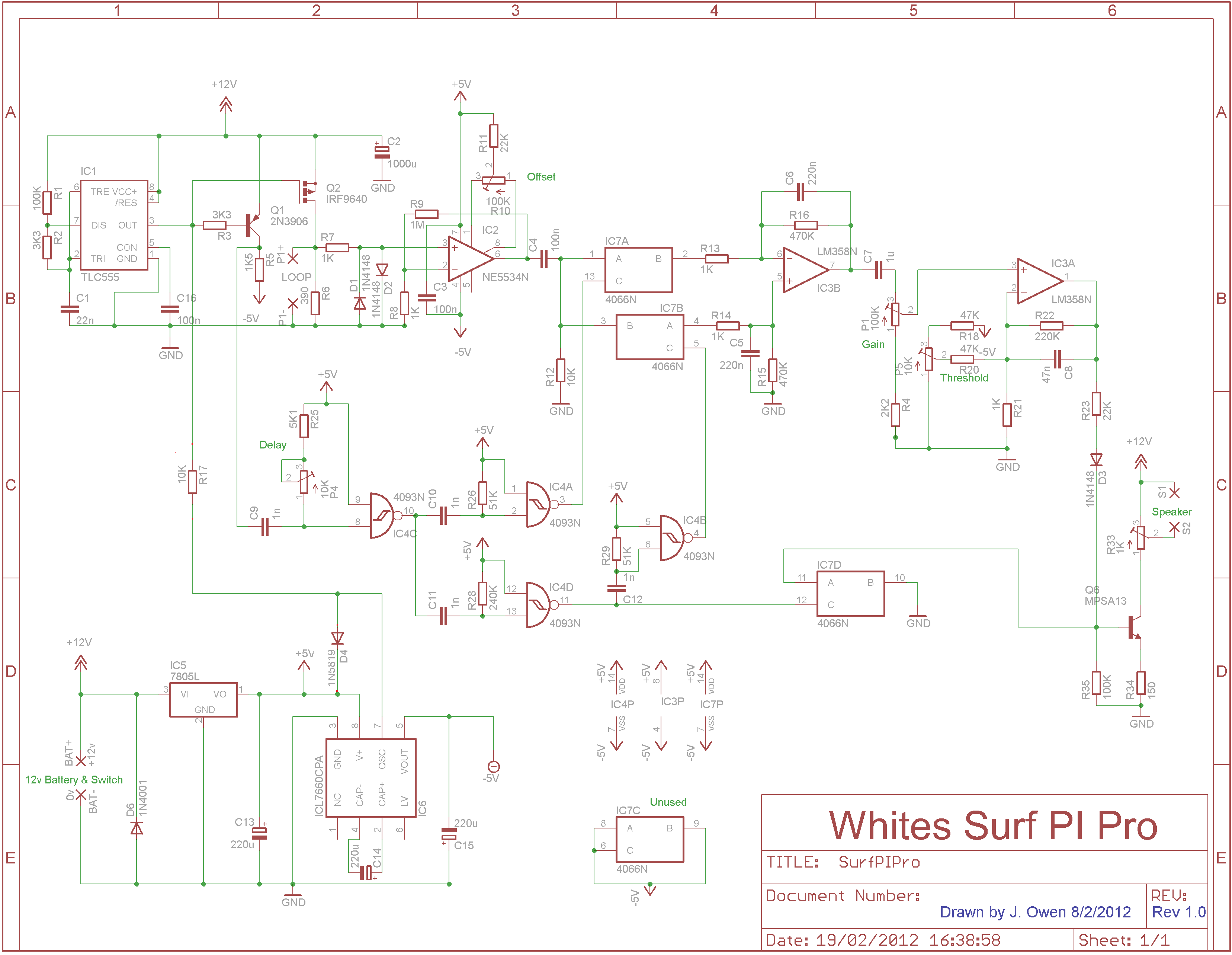

                      • I'm starting to not believe it, I can't find any schematics of it, I made the circuit voltage all right, I adjusted its damping resistor and it seems to work only once, or nothing, it's just too short a distance
                        • It's always been a short distance, I can't fix it, I can't find its schematic, the existing drawings don't match it.
                          • i never used surfxx schematic/board. you can try modify into this schematic, first change C17, R3, R4, R5 (from your board). do you have oscilloscope? your problem might be at delay. picture of the coil please.
