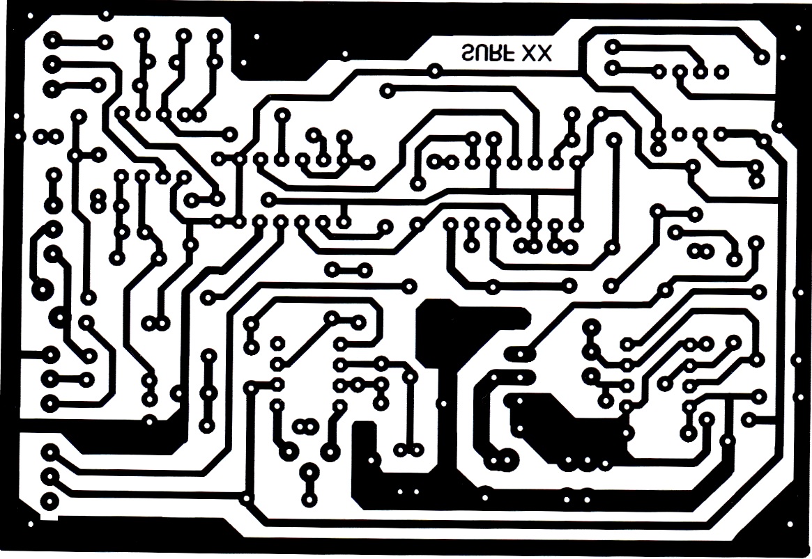

      • in post from ApBerg there is file named 99-68 mm
        that are original dimensions
        I have printed 10 of them and they are OK... used toner transfer for later PCB etching
        it would be best to have vector file PCB but there is no vector file,
        as ApBerg made and save original file in Eagle or whatever format
        there is one other PCB design and that is on this thread
        I don't know what is final design for that PCB

                here is jpg file for surf pi pro - ApBerg PCB design SURFXX

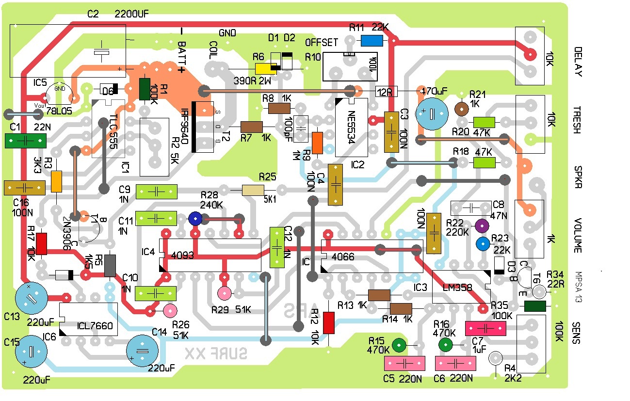

                • ?Thanks for the layout of her one again I want the top of the Board that there is writing his components let me easy to assemble his thanks
                  • part placement file
                    • Originally posted by sdesic View Post
                      You can easily vectorise a raster image with Corel, Illustrator, or any online free vectoriser, chosen from gazillion of similar ones. Then edit any mistakes, scale, hatch, and print out the result in one of free CAD applications, if you don't have something like AutoCAD or Rhinoceros, of course. (It probably could be done also in Corel or Illustrator, but I'm not so familiar with these two.)
                      Regards!
                      Jons

                        • Be carefull of the starting resistance of R2
                          • 6666
                            ?I select the R2 3K3
                            • Made another surf pi pro - ApBerg PCB
                              this time I don't have -5V on 7660
                              12V and +5V are OK
                              changed 7660 with one on my working board - it is working
                              it is not problem with 7660
                              what to look for ?
