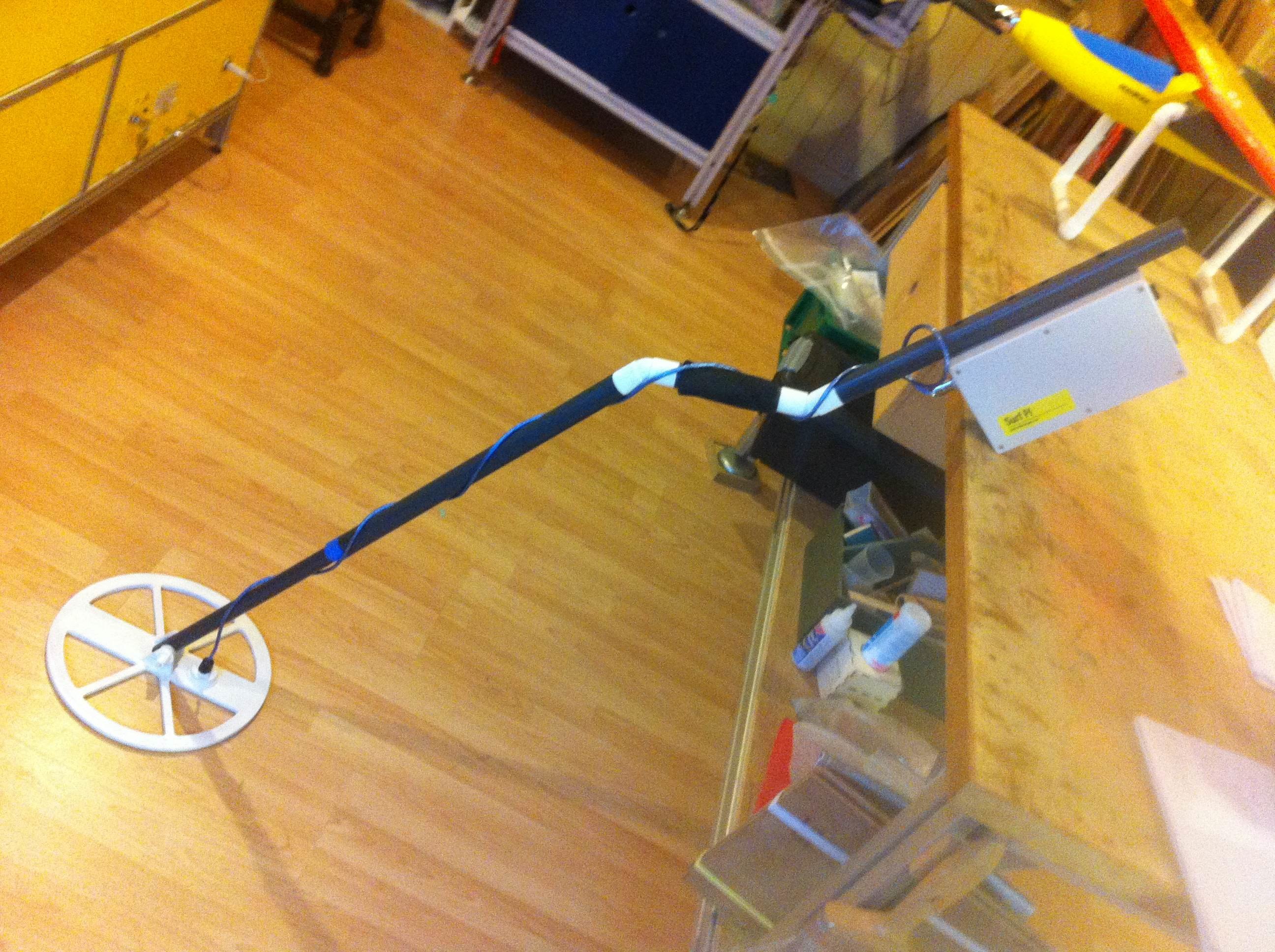

    Just finished my surf pi from a silverdog pcb. Nice pcb, very well made.
    My only issue was finding a control box to suit - 170mm is just on the long side for most instrument boxes - they end up too wide as a result.
    However, there was probably a really good practical reason for making it long and thin (there's an opening for a joke there ) I'm just using it for the wet beach/mud - this one is actually going to a friend who is currently 'Minelabless' after the PSU board on his explorer died.
    I laser cut a coil former from 3 layers of 2mm MDF with 6mm acrylic lugs - it's really surprisingly strong. I'd like to cut another set as a plug and vacform a cover from ABS next time - maybe use injected urethane foam for lightness instead of epoxy - I have all the kit from making making glider fuselages, it's just lazinesss to get started again
    Machine is very light, just what I need really.
    Looking forward to trying it out this weekend.

    Apologies for the dodgy iPhone pic.

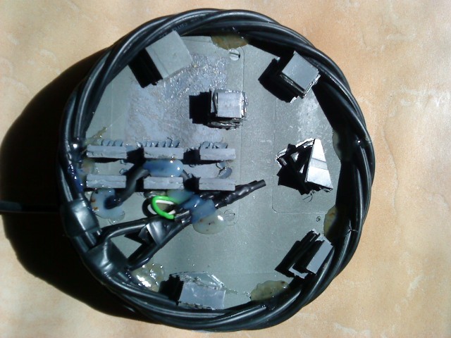

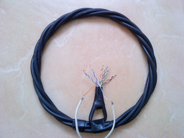

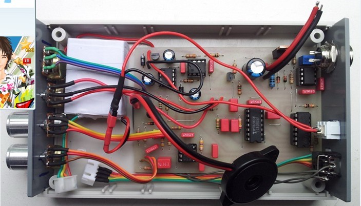

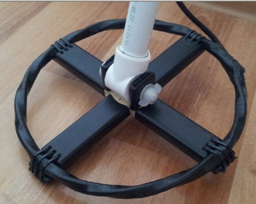

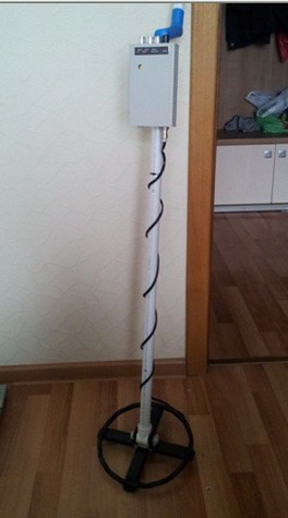

                          • The use of three cell phone batteries in series./Cable is a coil twisted pair.
                            • Hi yhl,
                              Interesting coil. Neatly constructed. Could you tell us more please.
                              What is the inductance of this coil?
                              What is the minimum delay it will sample at?
                              What is your detection depth on coins and rings?
                              Regards, Jim
